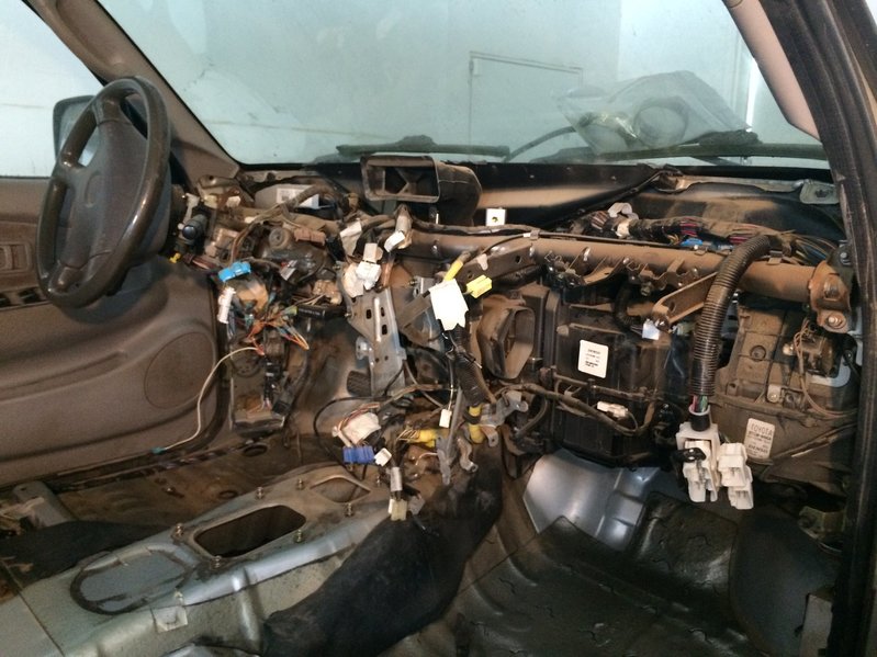

    I pulled the dash to put in the new dash harness. I don't want to completely pull it yet so I can mark/label plugs on the new harness.
    To bad I didn't have an air compressor to blow out all that dust. No biggie.
    I also saw this cluster of splices under the steering column. I guess it's the after market security system that was on it.
    [/QUOTE]
    Does it work?

    i took mine out, anytime i wired up new lights it would trigger the system and shut the truck down completely, then id have to break into my own truck, and rip apart the dash to find that module and unplug it and reset it so it wouldn't shut the truck down, happened at least 4 times to me so i had enough

    Ive always had bad luck and hear of other having back luck with aftermarket security systems. Seems to mess with the stock ecu...

    Does it work?[/QUOTE]
    A year after I got the truck the keyless entry broke and I turned it off because I never got another one. It worked at the time.
    It's coming out and I'm not going to add another. I've been looking at kill switches and that's the plan.

    x2 on the kill switch, have one on my crawler im gonna put one on the taco also

    Just to give a quick update. I removed the steel crossmember and blower on the passenger side. I've noticed that a lot of the dash harness splits off in different directions. The harness that was sold to me was only a dash harness. So I might have to split up my harness and add to what's coming. I shall see. Hopefully it gets here today.
