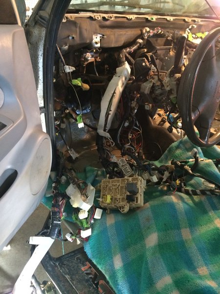

    Just finished putting in the new harness. I'll add pics later my phone won't upload the pics now. I'll have to use the Mac later.

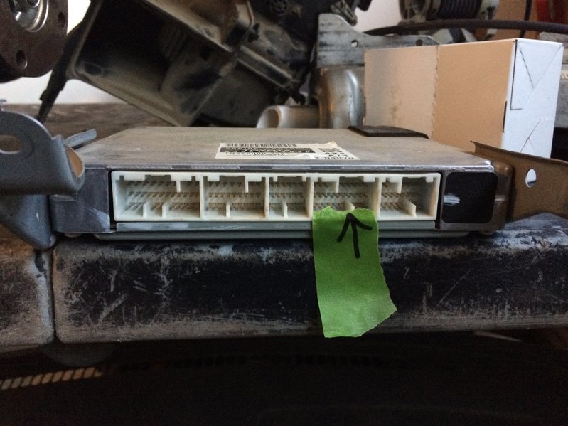

    So if anyone wanted to know why I had to do the harness is because my old harness was missing this plug for the ecu. But the new harness has it. So all this work for one plug. The answer is yes.

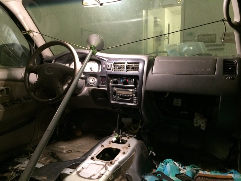

    Finished the dash.

    Um..... Ray?
    That plug is just for cruise control.
    You knew that right?

    Oh yeah forgot to mention I did install the new 3.4l cluster.

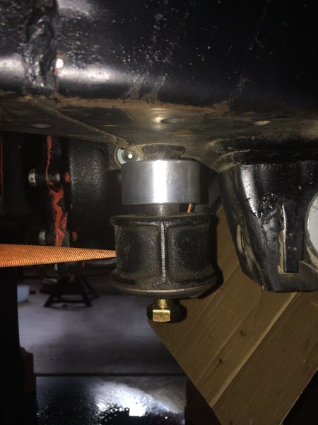

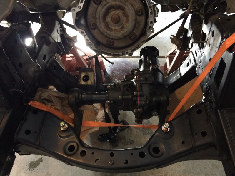

    This looks all cool and stuff but it seems that I'm missing some washers and bushing that I should of got from Jims. Now I'm at a stand still until I get it.
    Come to think about maybe I should place the motor in and then the diff. Then line everything up and then weld in the new motor perches. What do you guys think?

    I would mount the diff first since you are welding in new motor mounts. It would suck if it hit the pan afterward.
    Are you missing the two big rubber bushings and the washers for the arms that go under that cross member?

    Yes. I've been on google image and I see something like that. All I got was the two arms and 5 bolts that bolt it to the diff. I'll try and get to Jims sometime this week to pick that up. Plus I need some bolts for the actuator too.

    I looked at my bushings, they are about 2" thick. If you suspend the diff 2" down, or less for a safety margin, on the bolts, that should be where you need to be.

    Do you also have a one inch diff drop too?

    Yes, so mine sit about 3" lower with the added puck. I should have got a pic of them, somebody on here has a front end shot with the skids removed, you can easily see them.
