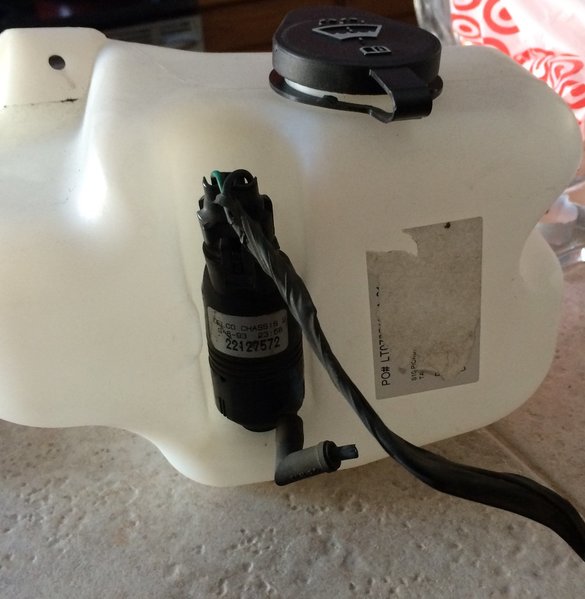

    @BDN I just picked up this little pump from a junk yard. I don't know if it works or not. How would I test it. I have the two wires there to the plug. I was thinking about touching both ends with a 9v battery to see if that would work. But since I have no clue what I'm doing I figure I ask you before I mess it up.

    Runs on 12 volts, I'm not sure if a 9v battery will kick it over but it won't hurt it.
    You can touch the wires to your truck battery and it should run. Reverse polarity won't hurt it either, it'll just run backwards.

    OK cool, the truck battery is just sitting in the corner. I'll go give it a shot.
    @BDN Thanks buddy it worked! Shot the water across the garage. Pretty cool. I wasn't expecting that. :D

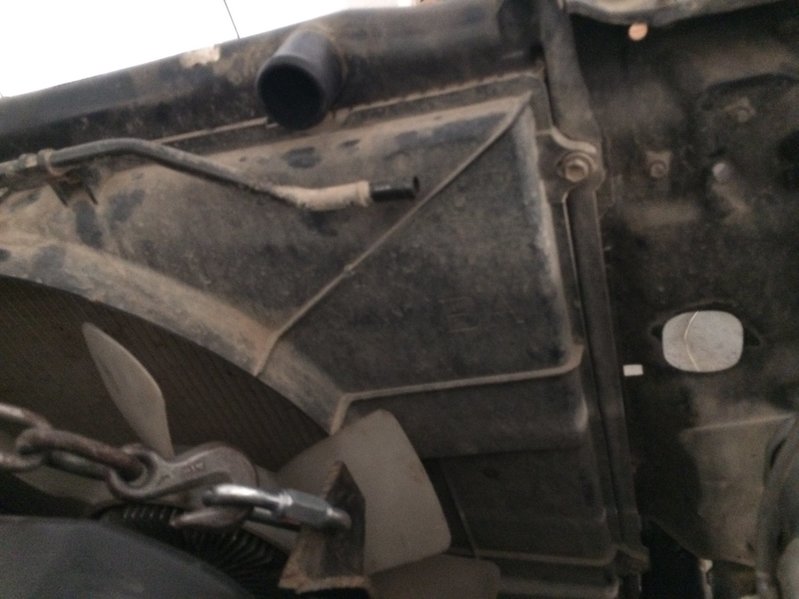

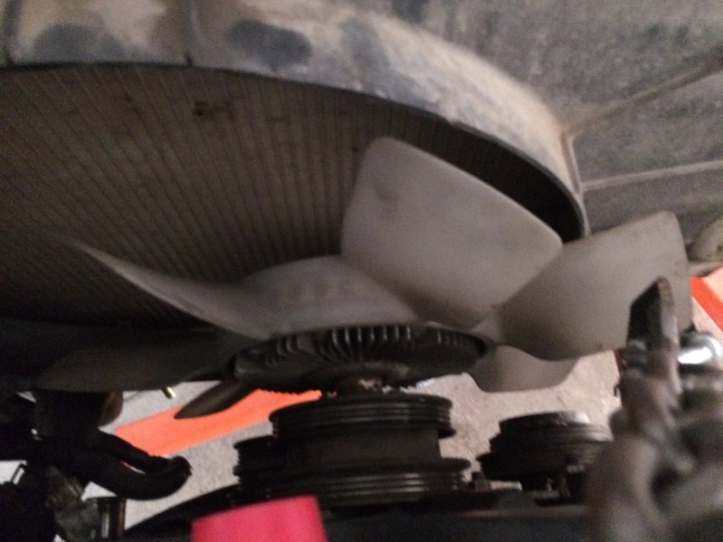

    I put the rear drive shaft in and everything is looking good except..... This!
    The 2.7 fan shroud is a little off. Im going to have to pick up a 3.4 one.
