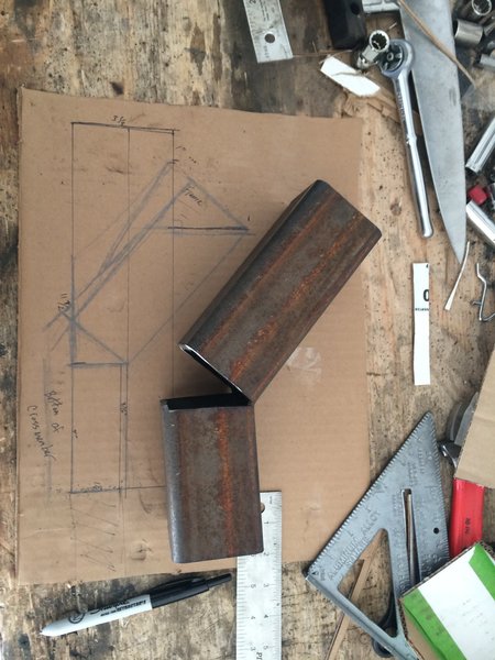

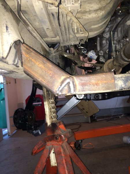

    Tim came by and we took a lot of measurements of his truck. Now I can move forward with the fab work. We decided to work from the back of the truck forward. We didn't want to bind the driveshaft. After we got all the measurements I cut off the transmission mounts and put the transmission and transfer case where it needed to be. Then I started designing and fabing up the new mounts. I didn't finish today. This is what I got done so far.

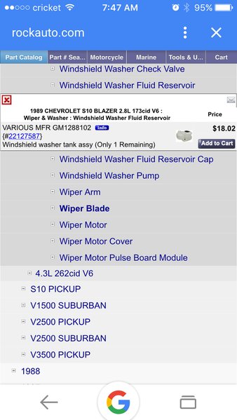

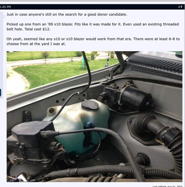

    I got the idea from here.
    I couldn't find a reservoir at a junk yard so I ordered one from rock auto. I did pick up a pump from a newer chevy s10 at the junk yard for $3.00. The toyota pumps won't work for this reservoir. Bad angles and to big of a suction part of the pump.
    Our windshield wiper reservoirs have a 4 wire connection. Two for the pump and two for the float sensor. Im planning on bypassing the float sensor but I was going to ask @BDN for advice on how to do it. Or just attach the sensor somewhere in the engine bay to not turn on the light.

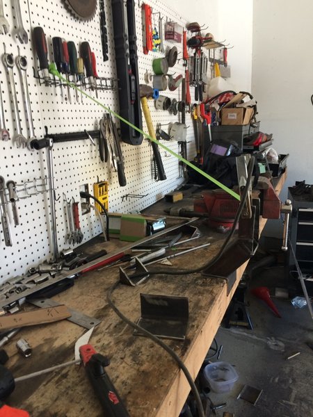

    Some of my set ups while working alone :D

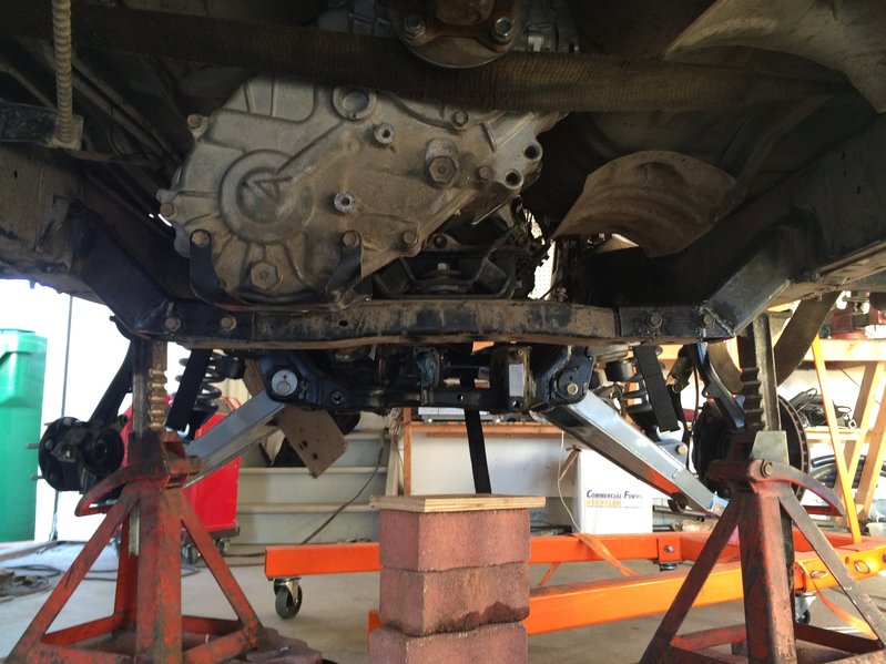

    7hrs later transmission is mounted up.

    That looks suspiciously like a transfer case
