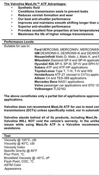

    @thefatkid Hey Brian which transmission fluid should run in this 03 auto tranny. Is it dex 3 or the toyota type 4?

    valvoline maxlife

    t-type fluid

    Amsoil is T approved.

    I found a MSDS pdf file for the maxlife. It's a T type.

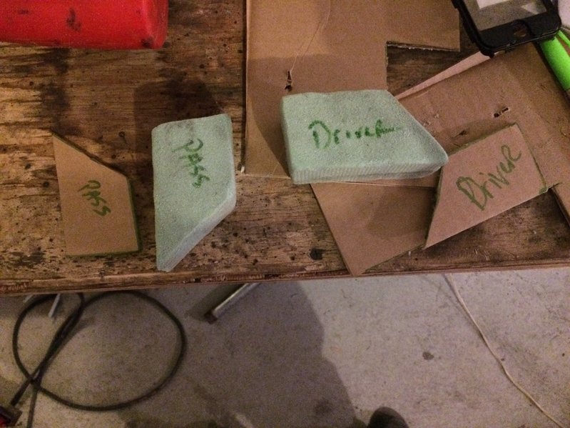

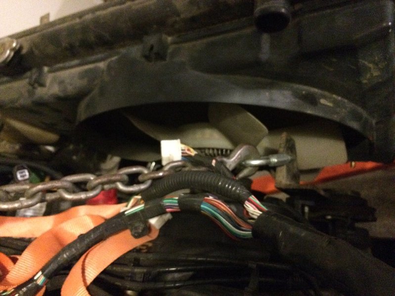

    I couldn't sleep so I got to work. I trimmed up the 3.4 fan shroud and checked the clearance of the fan. It looks good. Then made stencils out of cardboard and foam blocks. I just need to transfer this over to the 2"x2"x 1/4" thick steel.

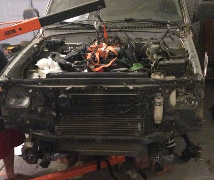

    Coming along nicely Ray, what are those pieces for? Starting to look like a full truck again with the front on.

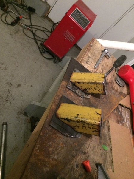

    Thanks bud. The pieces are for the motor mount perches that need to be welded back on the frame. I should have everything welded in by this weekend. I have the steel cut already and once I get the perches welded together I'll post pics.

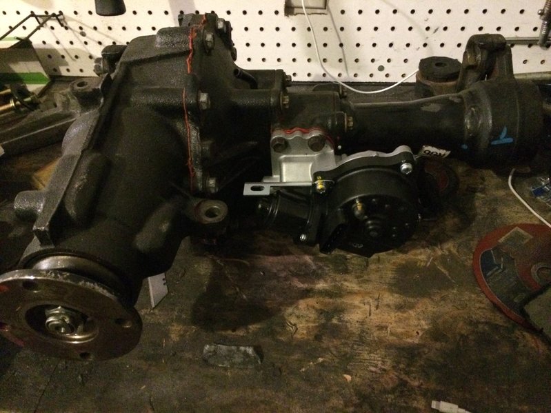

    I finially got out and saw the force awakens. I enjoyed it. When I got home I pulled the motor out again to pull all the pieces for the perches. I also pulled the front diff to add the actuator.
