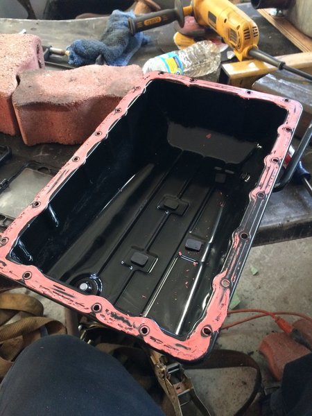

    Any good tips on how to remove this PITA rubber stuff off?

    wire wheel :D

    That helps with the mating surface, right?
    Ray, do you not have a gasket scraper? Because that's what you need.

    Not a gasket scraper. I do have a razor blade with a handle. But the razor is to sharp. I'm using a flat head right now. So far it's doing the job. But it's going to take time I guess.

    Gasket scraper or pocket knife.

    I wouldn't worry too much about scratches, it's a silicone gasket not cork or rubber so I'm pretty sure it will fill any scratches. Wire wheel back in the day to remove the old cork and rubber from the Chevy's and apply Permatex red or blue or black, whatever is in the tool box, and seal it up.

    That stuff is a pain in the balls. The problem is the lip of the pan is contoured so you really have 3 levels of surface to scrape off. Takes forever but you'll get it

    pans got holes in it already, get the wire wheel out

    I'm so temped but. Something about scratching it is driving me crazy. I can't find it in me to scratch it.

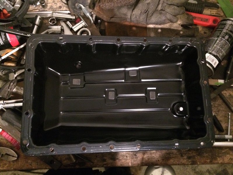

    All set.

    I'd check the FSM to be sure on the torque sequence.
