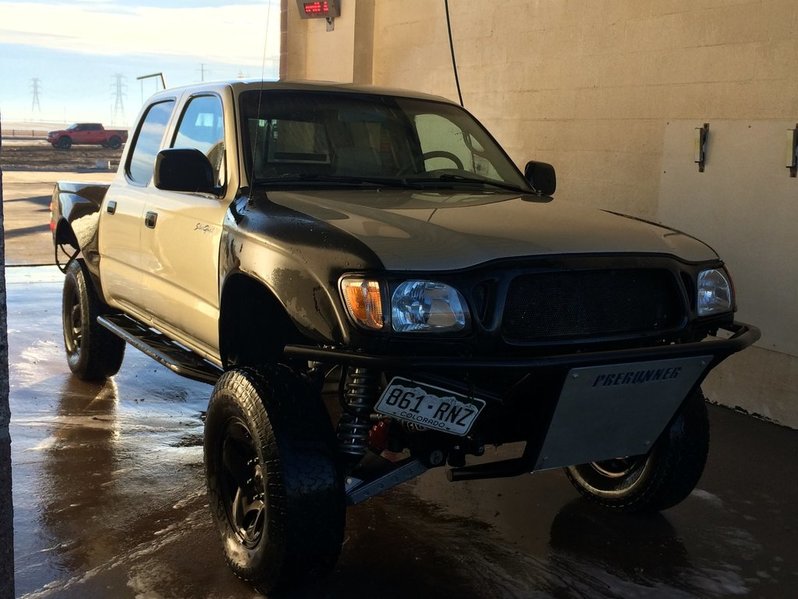

    Washed all the garage funk off.

    Good lookin' prerunner! :thumbsup:
