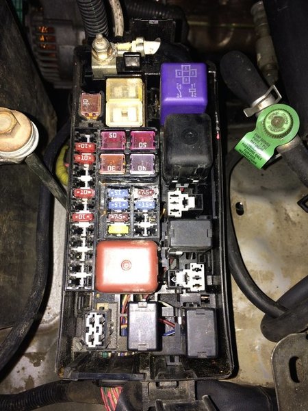

    Yes. I changed it out with the old relay from my old fuse box.

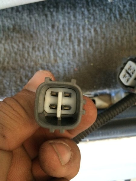

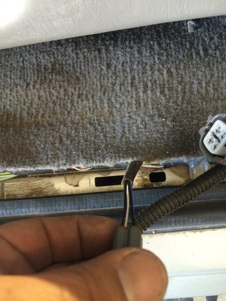

    Pics of the O2

    @thefatkid Is there any way I can test the plug that the o2 sensor plugs into to see if the right voltage is getting to the sensor?
