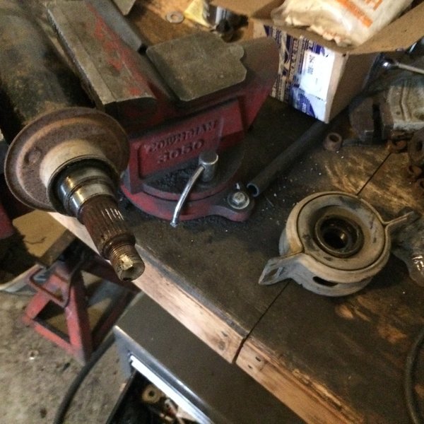

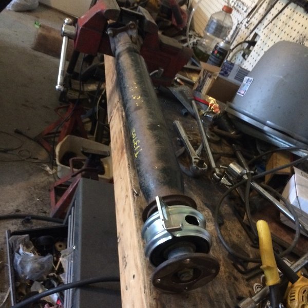

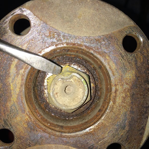

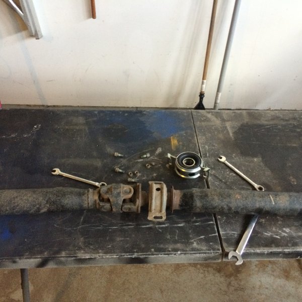

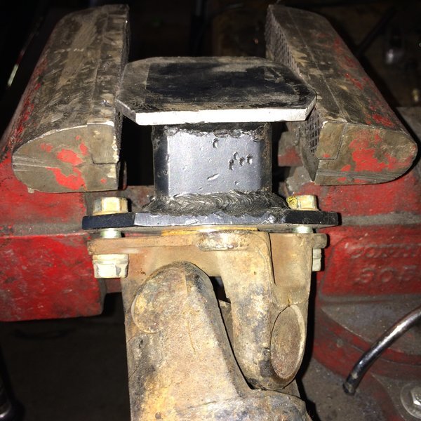

    I've been having a ping sound and Dylan and I where troubleshooting it and came up with the carrier bearing. So I went to replace it today and when I went to remove the housing and rubber part of the bearing the hole thing just came off. The bearing is still good and it was just not seated on the shaft giving it the play in the bearing. When you put your foot on the brake and press the gas the torque would cause the shaft to bounce in the bearing and cause a ping on the drive shaft. The new bearing is in and no sound yet. I still want to go test it on loose ground to let the tires give a little. I tested it in the garage so the tires grip pretty good.
    I pulled the whole shaft out because it was easier to take apart.
    I had to pry this tab up to remove the nut. The nut was a 24mm.
    I had an old motor mount that I used to put in the vise instead of putting the drive shaft in the vise.
    This is where the whole bearing came off in one piece.
    I torqued the nut to 134 to press the bearing on and loosened it and retorqued it to 51. I still had to tighten it a little more to line it up so I can smash back down that one part of the nut.
