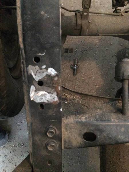

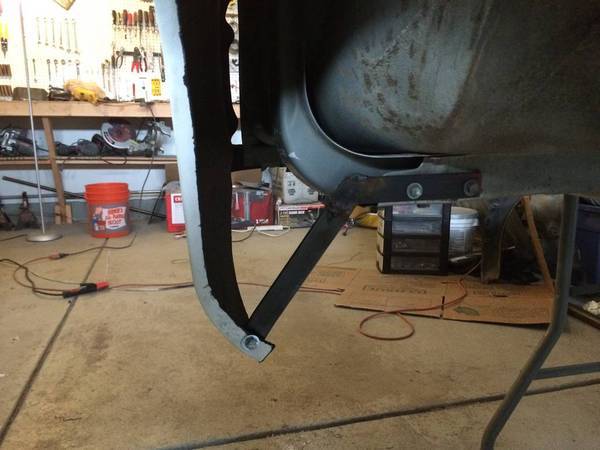

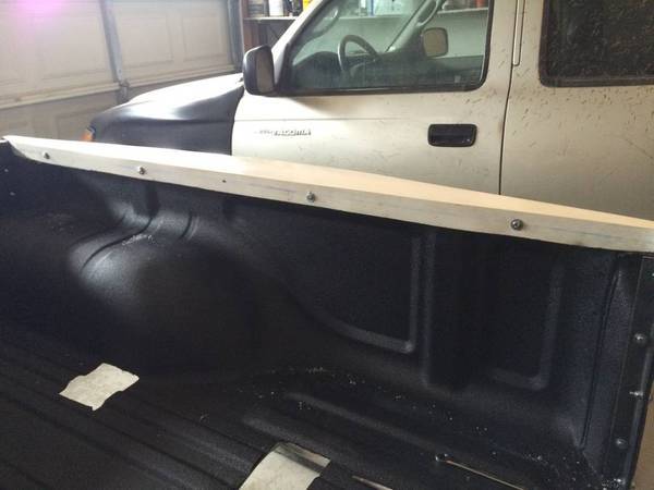

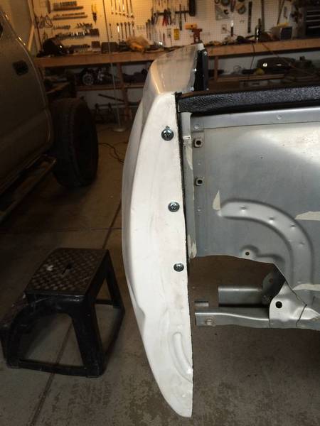

    So when I went to cut up the bed I cut up more then I need to. But it all worked out. I am using 1 1/4" angle and 1" strip to make new mounts. They came out pretty good and the glass fits snug.
    One concern I have is the 4 bolts in the bed. Im thinking I might have to run bigger washers
    so the area of where the washers sit could hold more of the fiberglass edge. Instead of the small washers I'm using. I don't know, overthinking it I guess. Feel free to give opinions. Anyways thats just one side and it's time to get back to work. Peace!

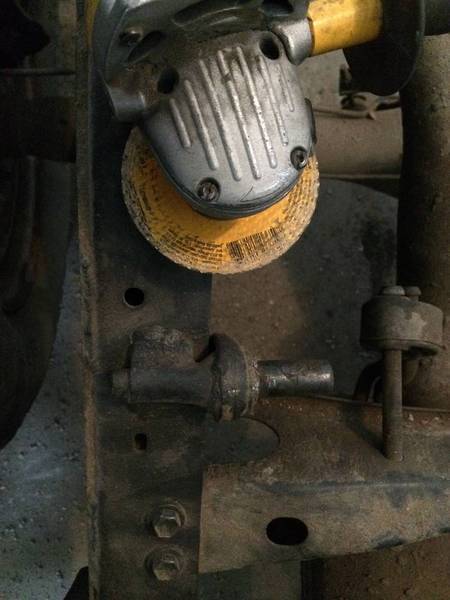

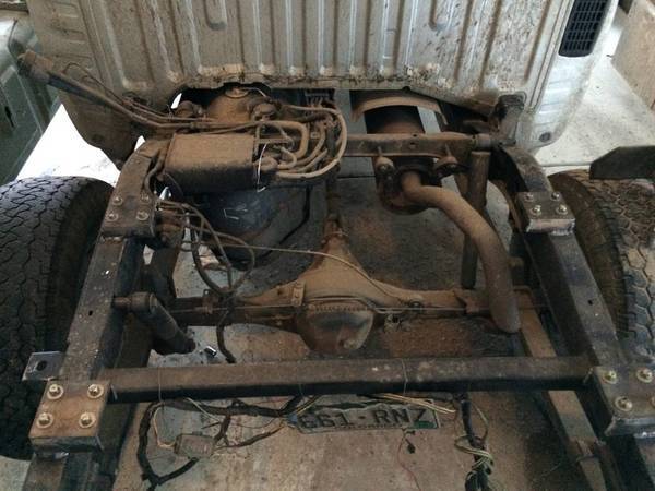

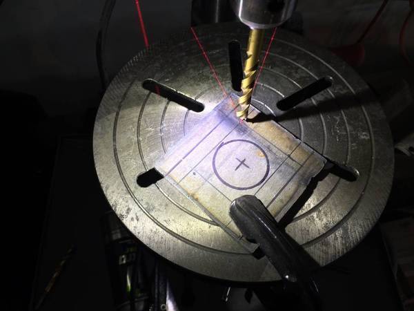

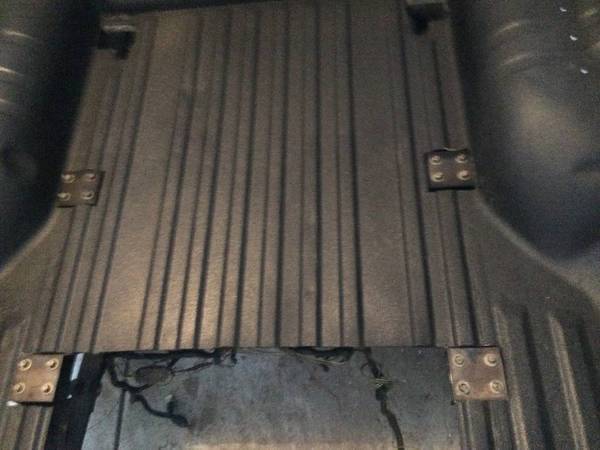

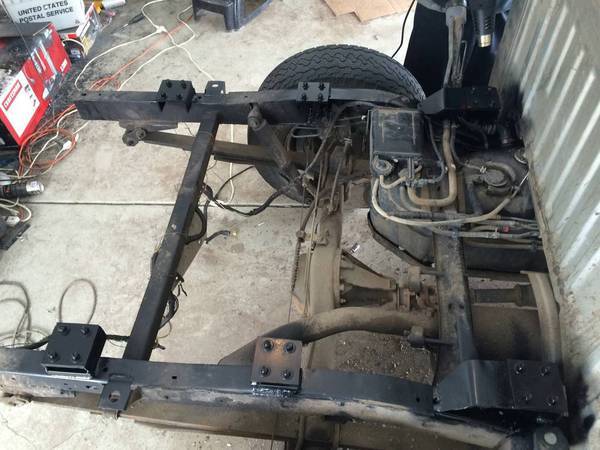

    I started with welding the cage mount finally. All 1/4" plate cut at different sizes to make the mounts. Drilled 4 hole per mount and welded the bolts heads in place. All the bolts are grade 8. Some of the holes in the bed where bigger then my 4"x 4" plate but the fit wasn't bad. I can live with it. I still have two more mounts to make and then I can throw the bed on for good.
    By the way that mount has two 1/4' plates bolted together. so it is really 1/2" thick on top.

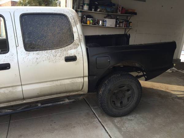

    Finished the mounts.
    Bye bye old shock mount....
    Ray on drying detail.
    A little over spray but no one is going to see it.

    no issues with the gas tank?

    Nope I took everything off and duck taped the ends like crazy then covered it with a wet towel. No problem with the heat there.

    Got the bed back on. I'll take better pics once I put the lights on and she gets a bath.

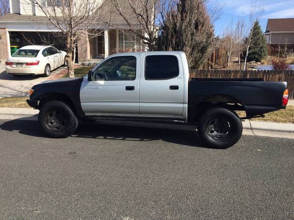

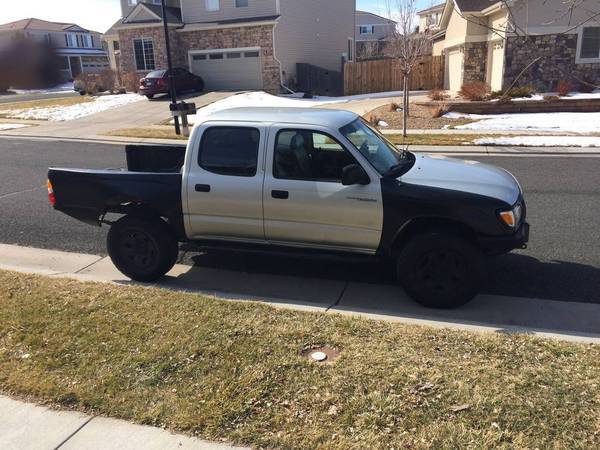

    Just some pics of what it looks like now. All cleaned up.
    It looks like I need to paint the yoda emblem, and the two silver pieces under the headlights black.
    And the yoda emblems on the doors need to go black too.

    Leave the grill emblem as is and black out the rest.
    Looks good man, when are we gonna jump it?
