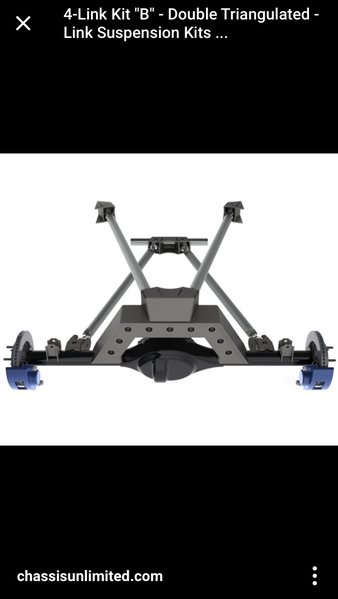

    Trailing arms won't work with a double tri, and for a prerunner type setup, Ray is on the right track. Double tri would be better for a crawler, but that is not what Ray is going for as far as I can tell.

    Pinion angle is def critical, when I was adjusting my links the last go around, an inch can make a huge difference in the rotation of the dif. Small adjustments can have very large effects.

    Cliffs truck is a wishbone 3 link with trailing arms. Think it works pretty well..but i don't see the point. Might as well have gone 4 link.

    I'm not following, that isn't double tri.

    I guess i don't know what you mean by double tri..:anonymous:

    I had to google it too. :p I forget things easy now so I take a lot of notes. The lower links go inward. Buggy style links for sure.

    It's where upper and lower links are triangulated, trailing arm setups are single triangulated with the uppers, lowers are parallel.

    Ahh yes. Nevermind. That is not how id go for sure.
