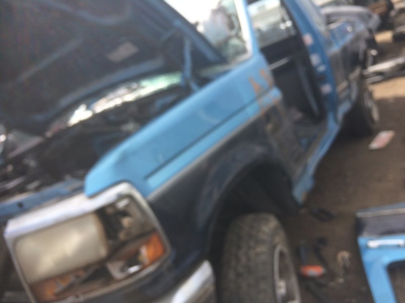

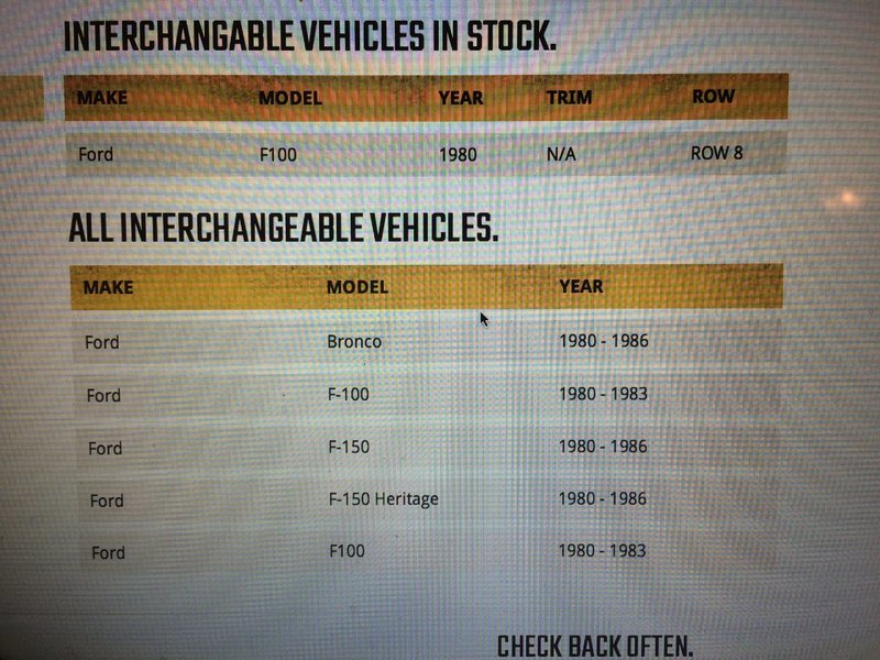

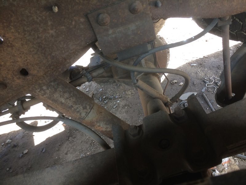

    :anonymous:
    Jk the one I saw today was the wrong year :p
