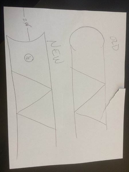

    @jubei777 so we are good with the 2 5/8" size circle.
    I ordered the anti wobble uni ball so I can double check the size for the trailing arms.
    -40, jubei and ChadsPride like this.

    I just wanted to reinsure you the the 2 5/8" size is correct. Because I mention that I never measured it. I was going off what they told me. But now I have the part and measured it for myself we're good to go.
    But what I would like to do is cut that rear 2 5/8" out and draw another 1/2" circle between that cut and the first / gusset. Like in this image.

    Ah! That's makes sense now. Piece of cake.
    I'd suggest that we get as much of this drawn up as possible while you're getting you're parts in. Once you have everything and you know the design is good, we can convert the files over and start cutting parts!

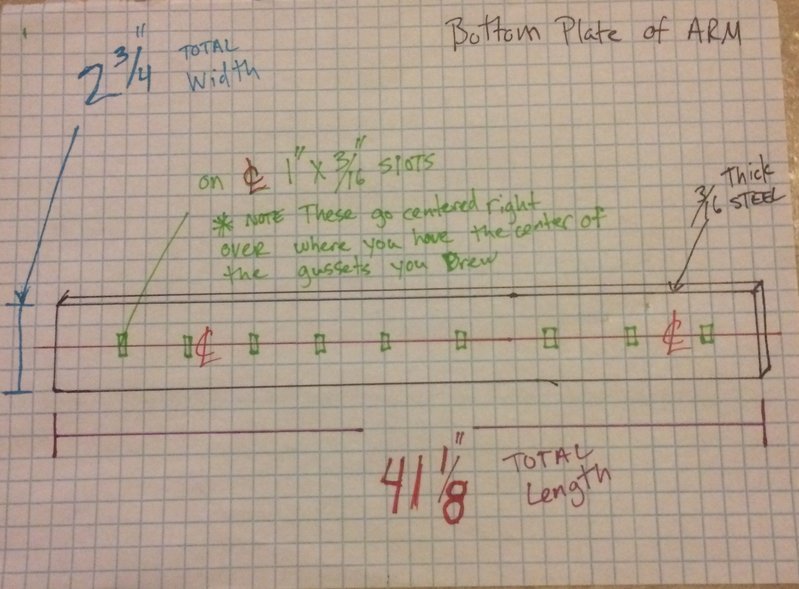

    @jubei777 Ok bud here's the next part. I'm going to keep tearing apart the arm and drawing it up for you the best I can and post them here for you when ever I can. If you have any questions. Just quote the image and ask away. I'll do my best to answer. Thanks again.

    Dudes, Don't forget to over size your slot or under size your tab to account for the Kerf, A dialed in plasma is .08ish off set on all sides. I don't know how dialed Corey's table is. Waterjet is more in the .03 off set range on a medium speed cut.

    Understood. Those slots don't have tabs that go into them. All the tabs been removed on that section because I changed the direction of welding. Corey recommended I change that. The only tabs I have are on the gussets sides. Gussets are 1/8" and slots are 3/16" slots.
