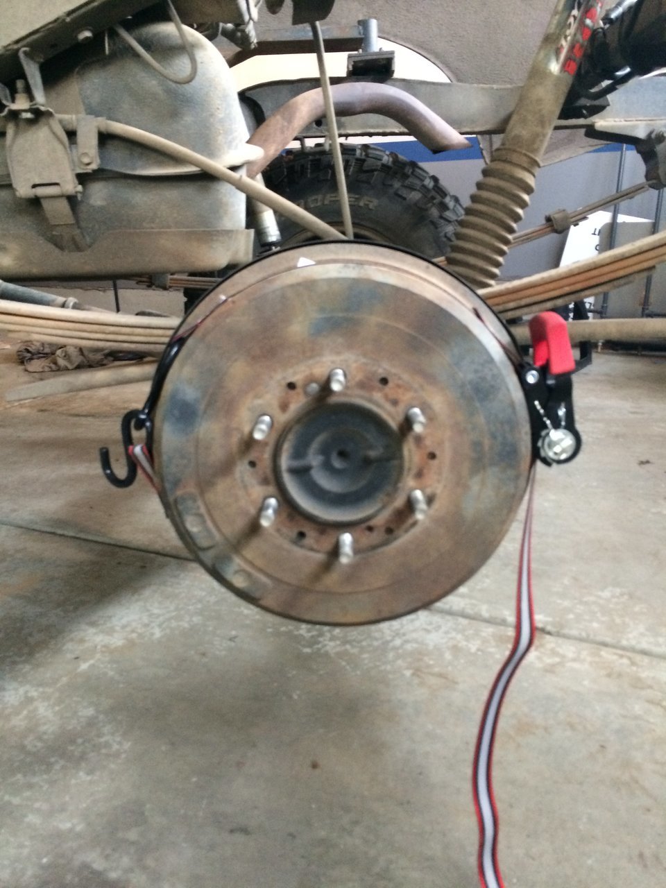

    My brake light came on assuming it was the front like it always is. I pulled the front wheels off and saw that the pads where pretty beefy. So I figure it's the rear that needs to be change since I haven't had them change in a long time. Figure I just tackle the job and pick up some cheap shoes for the truck.
    Just finished my rear brakes. First time ever doing rear brakes. Really not that hard. It just take a lot of patient with the little pieces and springs.
    I didn't have any bolts for the drum to pull it off so I used a mallet to loosen up the drum and wraped a ratchet strap around the drum to use as a handle. Pretty easy to wiggle and pull the drum off that way.

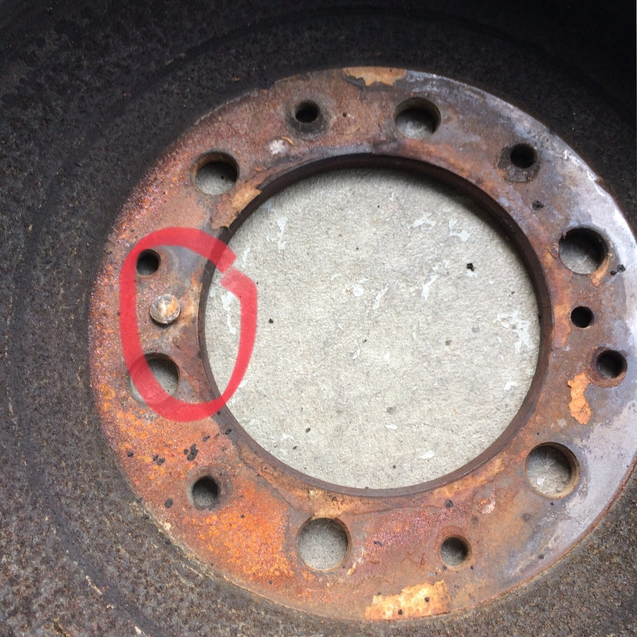

    Another thing I found while I was doing my rear brakes. I remember having a bolt broken off in the drum. I made sure the bolt was flush with the outer part of the drum but I never checked the inside of the drum. I found the broken bolt sticking out on the inside of the drum. Which gave my rear driver side a wobble. I ended up grinding it down to make it flush on the inside of the drum. It should stop wobbling now.

    Impossible to remove the broken bolt?

    It's smooth on both ends. So I would have to weld something (like a nut) to screw it out or drill it out. The amount of work to get it out is more of a headache then just to grind it smooth. Plus with the fact that this whole rear end is getting replaced anyways. I don't want to work harder then I need to.

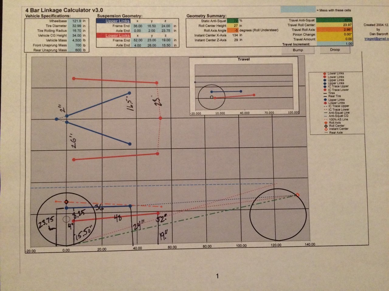

    3rd and finial draft to my Link set up.
