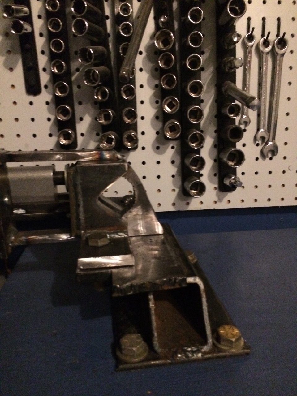

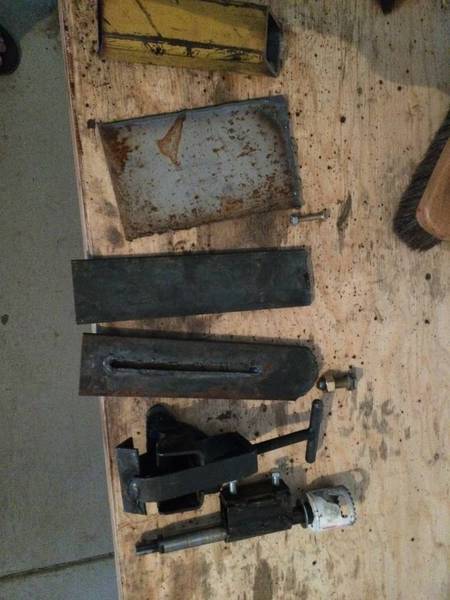

    Also building a new clamp for the tube notcher. The last one had to much play in it.

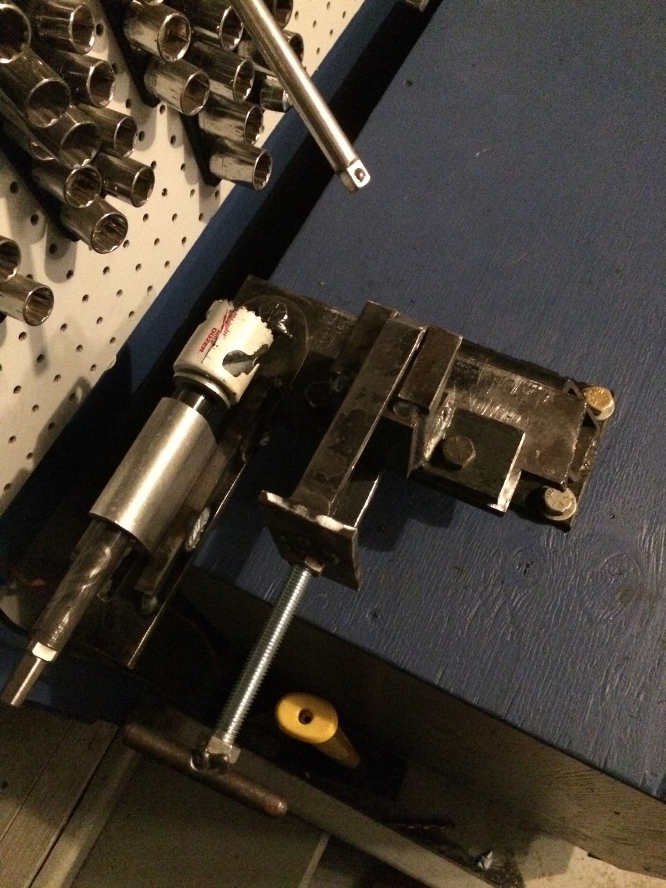

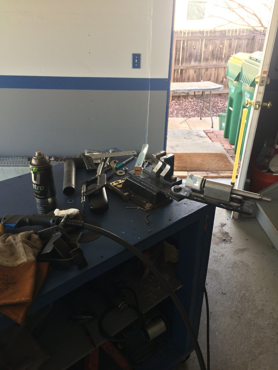

    After a few shim here and there. I got the notcher squared and in line. Pretty happy with how it turned out. There is a little gap on the square but it’s because of a little piece of metal that wasn’t cut completely. A few rubs from a file and it will be good to go.

    what notcher did you mod? HF?

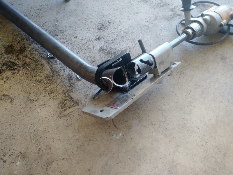

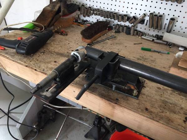

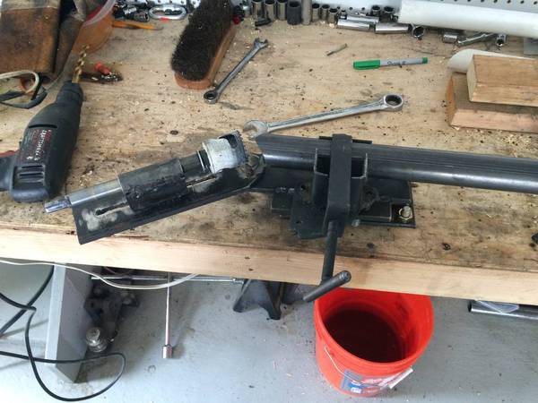

    I bought a HF when I did my sliders back in the day. It couldn’t do the notches I needed for my bumper with that notcher. I used the clamp off the HF one and built a notcher . I need one that can do larger angles. So out of scrap metal at work I made one.
    The screw part of the HF clamp was worn out and sloppy. So I figure I re build a clamp that is stronger and I can repair easy if the treads go bad on the bolt and nut I used. That’s what happened to the HF clamp. The bearing housing and shaft I bought from summit. That isn’t HF. So in the end this notcher is all home made now except the shaft and housing.

    This is when I first built the notcher.

    What the notcher looks like now.

    Nice work!

    Not only does Ray make his own stuff, he makes the stuff he needs to make his own stuff. :bowdown:

    :D :thumbsup: If I can make it and save the money. Why not. :D Still looks like a dildo clamp tho.

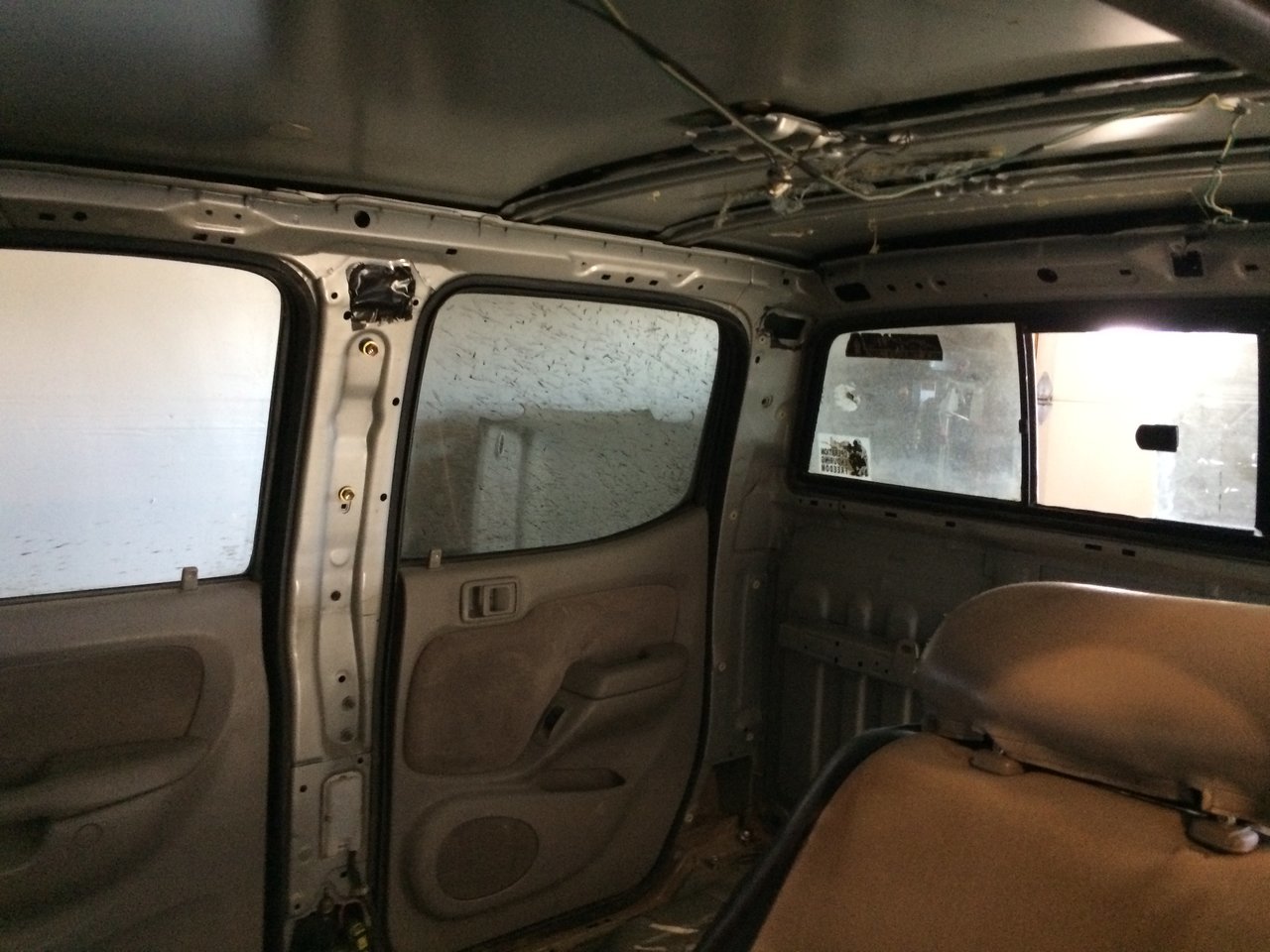

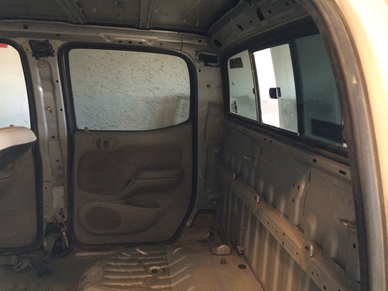

    Looking into the cab and realizing maybe I bit off more then I can chew again. Oh well no going back now.

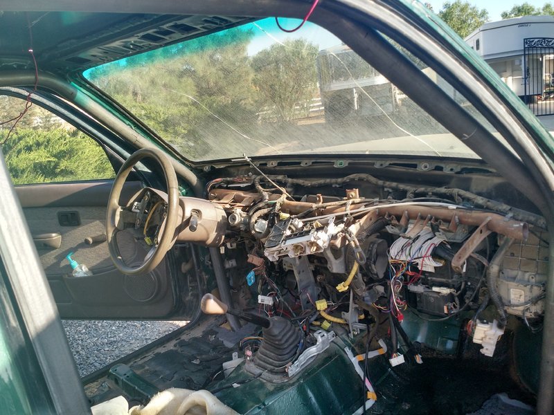

    :quickdraw: Robbing some photos :D Thanks for your help bud.

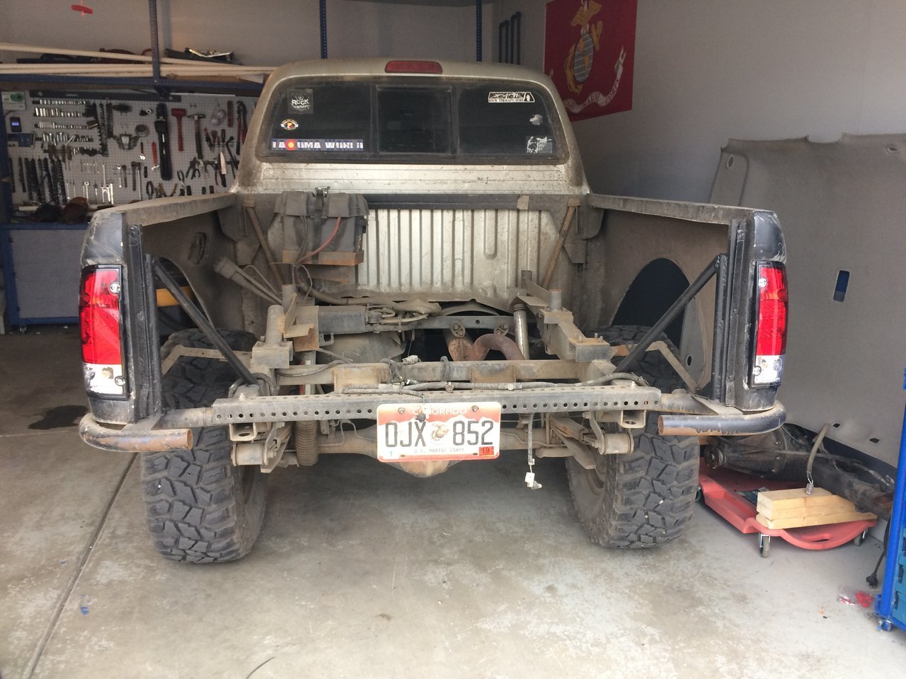

    New tail lights.

    Oh ok. Yeah I wasn’t to sure about wiring. If those models have the same wiring. But the 95-00 tail lights are 30.00 cheaper too. I had enough problems with wiring I didn’t want to chance it. That’s why I got the tail lights in the first place was trying to figure out my wiring issue.
