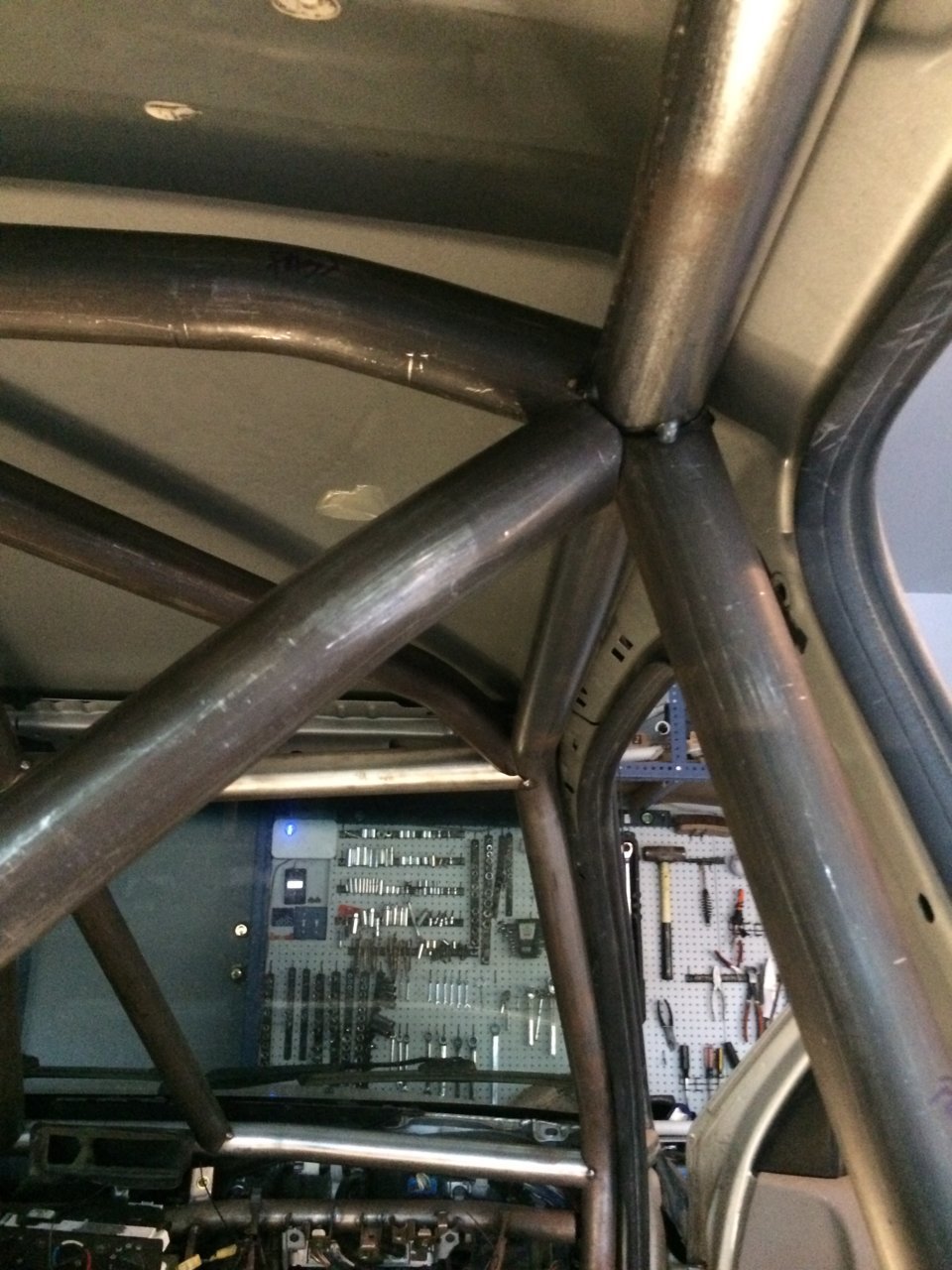

    Are you going to remove these and 360 weld the tubes under? I am not 100% sure but that was how I did all of mine, roll cage "rules" say that ALL tubes must be welded 360*. Its hard to find specifics but I went the safe route and welded tubes like that 360* before I put the next tube in. But its hard to find if it counts on overlapping tubes to just weld around both and make one big 360, if that makes sense

    That’s what I was planing on doing. I’m still figuring it out in my head because like you noticed a lot of the notches over lap. The end goal is to 360 every tube. Right now I’m just cutting and fitting everything. I’ll strip the cage once I have all the pieces made, I’ll clean the tubes and paint (except joints) then put everything back in sections welding together as I go. It’s looking like from top to bottom is how I’m going to do it.

    Gotcha, that will change the fitment a little bit though just heads up. The really tight tubes may need a little extra notching right where they go over a weld bead. What I did was weld anything that would be covered before installing the next tube, but obviously you would still have the parts of the cage you can't reach (very top) until you drop the cage, so you cant fully weld all 360 all at once anyway. So its a lot of "weld this now, but wait to weld the rest of this tube until later". Coming along very nicely though
