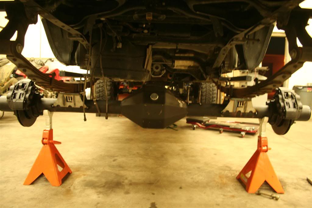

    LMAO its got it BAD. But once the rear is in it shuold be gone. I drove it Monday, and it feels really weird, the steering is all buggered.
    Joe, im driving it to your house when its done so we can cut the bedsides some more

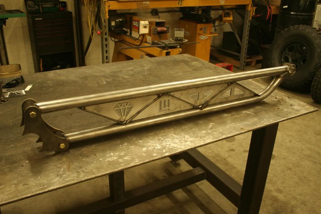

    so what else you gonna cut on the rear? trim out the fenders for clearance??

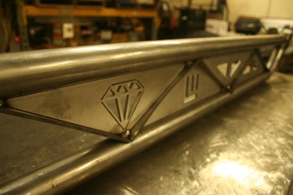

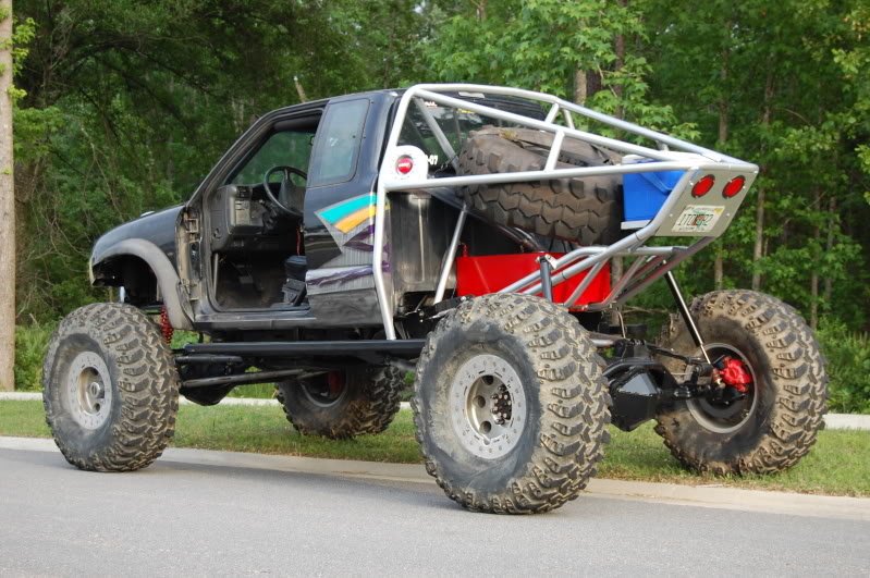

    something like this

    ^ Great...another trailer queen that'll require us to wrap the trees in Pampers so it doesn't get scratched up on the trails.

    lol yeah, dont forget the wet wipes to clean the dirt off

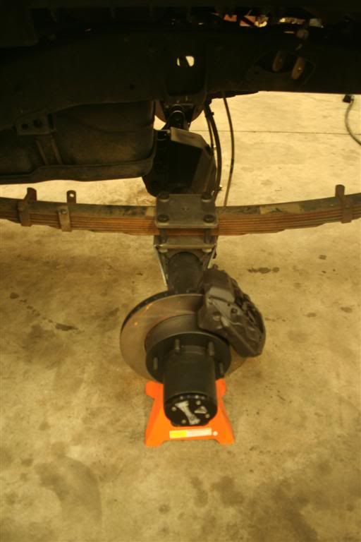

    moar...

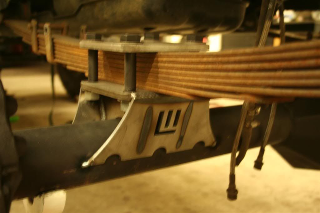

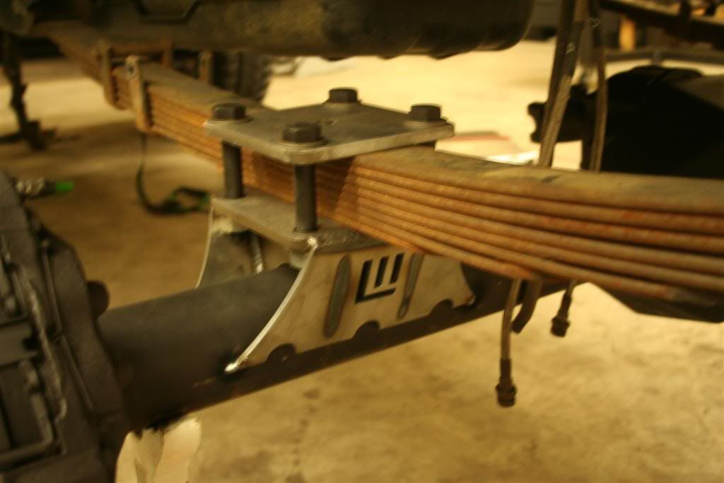

    Jordon, is there an advantage to using u-boltless perches other than strength? Any disadvantages? Will the plate limit droop?

    Not sure what you mean by the "plate limit drop" but the only advantage is that there is nothing under the axle. If you have your U-bolts flipped you get pretty much the same effect, but this is just that lil extra. Plus the bling factor is pretty high on something like this, as it is unique.
    There could potentially be some disadvantages, I.e. if a weld brakes, there are no ubolts to hold it all together, but then again, a u-bolt could break too..
    Since my back end sags like a mofo, these are super since they will give me another 1" of lift out back, probably still going to need a bigger spring pack since i think my front is about 3" higher than my rear
