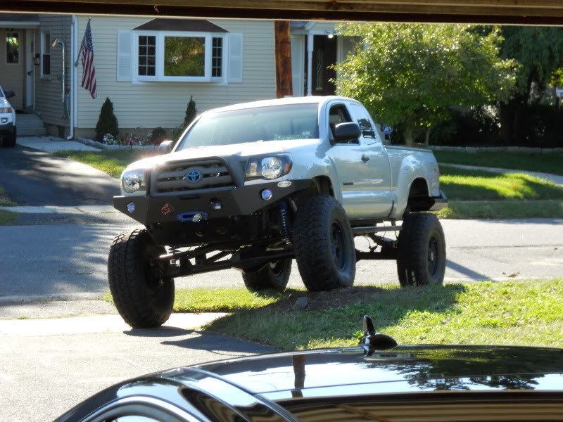

    Why havent you fixed the camber? ...edit....Forgot your SFA.....Looks like something is bent.....

    lol.. this has been discussed on other boards. not sure what the problem is, maybe you can help.
    So camber is not adjustable on toy axle, it does appear to be camber.
    its been stated that incorrect toe setting can give the illusion of a camber issue.
    I took everything apart yesteday to make sure the knuckles were seated properly and it all appeared good.
    After driving forward, the above picture is the result, after backing into my driveway, the problem corrected and now the wheels are perfect.
    MY explanation: I have a small toe issue, pigeon toed, so when I drive forward, it pulls the wheels together (binds), then when I back up, the tires unbind and they go back to looking straight.
    comments?

    Hmm.....Could be the case. Toe is easy to adjust. Measure the front and rear tread on both tires (a fixed point on the front tires), and adjust as needed. You should run a very slight toe out. About 1/16". Camber can be adjusted by useing shims, but its a pita.

    well I fixed the toe/camber issue.
  10. Oct 2, 2010 at 1:16 PM
    #1090
    chris4x4
    chris4x4 With sufficient thrust, pigs fly just fine. Moderator
    May 8, 2008
    #6497
    112,751,676
    FlimFlubberJAM
    Tenoe, AZ
    2019 Rubicon 4 Door,
    4.10 gears, sliders, and lots of buttons.
    What was it?

    toe, I opened the tow up a turn or 2 and now its perfect.

    mini flex in the driveway, still need to get out and really get it crossed up

    ^^^ already exceeding the ifs flexing capabilities.

    haha probably so! its funny, since my axle is soo wide, I need less articulation to get over the same obstacle, so I am looking forward to really seeing waht it can do, I think it will do quite well.

    Yeah. Us IFSers rely on the rear taking up the slack. I'm curious how it will handle the real stuff to. Take some video if possible please.
