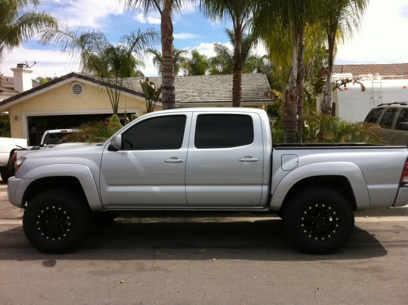

    not much of a build but just got wheels and tires with a leveling kit.
    16" pro comp 7031 in black with falken wildpeak A/t

    Looks good. debadged and all :)

    i like how dark your tint is what is the percentage on the front and rear?

    Looks awesome! What lift/tire size are you running? Is the Canyon Lake in your profile, Canyon Lake, Texas?

    trucks got limo with 15% all around with 5% front windshield tank strips....makes it nice with the hot summer days ...its got a truxx leveling kit up front stock in the back...tires are a 285/75/16..
    i live in Canyon lake,California

    How much trimming did you have to do to fit the 285s?

    removed mud flaps...slight trimming of wheel well plastics nothing major

    Is that a 2.5 or 3" leveling kit? Is there an AAL or stock in the back?

    stock in the back...3" truxx leveling kit up front

    I have been looking @ the same wheels with the same set up:16X8 285/75. I talked to a local shop and they recomended 17's saying that there could be caliper rubbing issues with the 16's. How close are your calipers to the wheels? Also the bs is 4.5 and the off set = 0 on your wheels right? Truck looks great btw.
