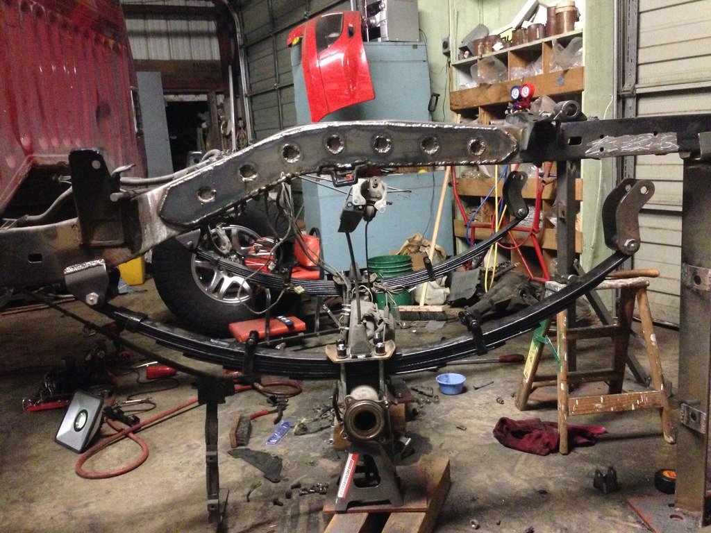

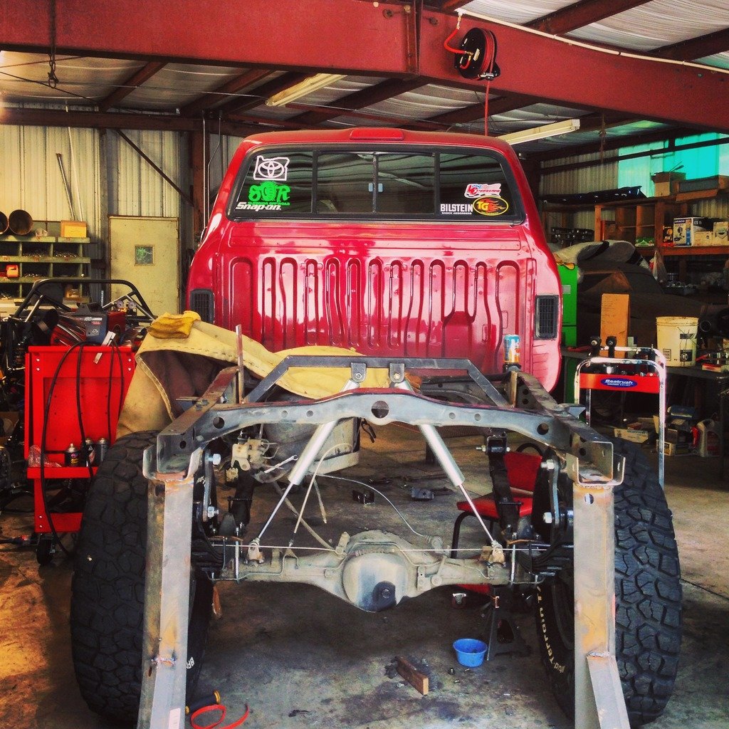

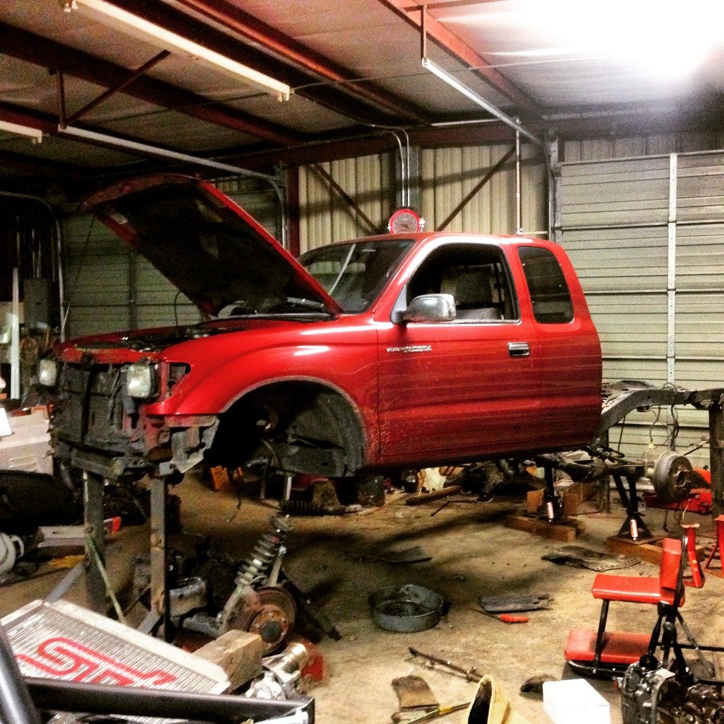

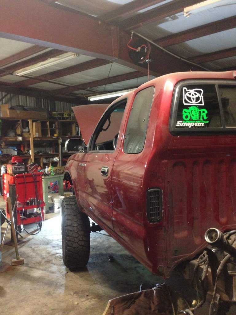

    Didn't get around to starting the solid axle swap on my Tacoma until 3-1-2015 (317,176 miles)
    In the beginning I was all for keeping it Toyota primarily because I had my '80 I daily'd that I upgraded a little and started stock piling parts from after I bought my Tacoma from my Uncle. He was the second owner and bought it with 28K miles in '97 and I bought it Oct. '14 with 312k. Within the next year I'd like to link atleast the front axle and put it on tons with 40-42s and do a back halve truggy build too

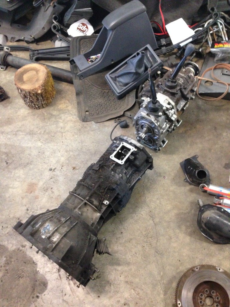

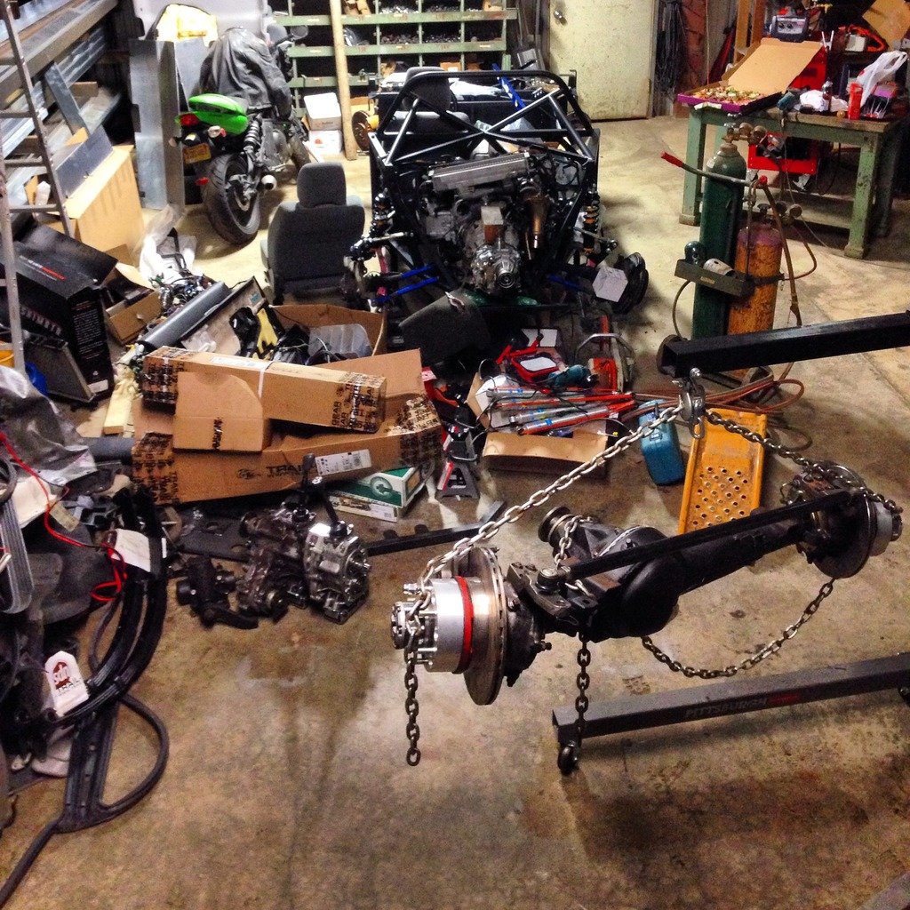

    Drivetrain:
    -5vz (doing t-belt kit as well)
    -r150f
    -lce stage 2 clutch masters clutch kit
    -dual gear driven cases (2.70:1)
    -trail gear adaptors

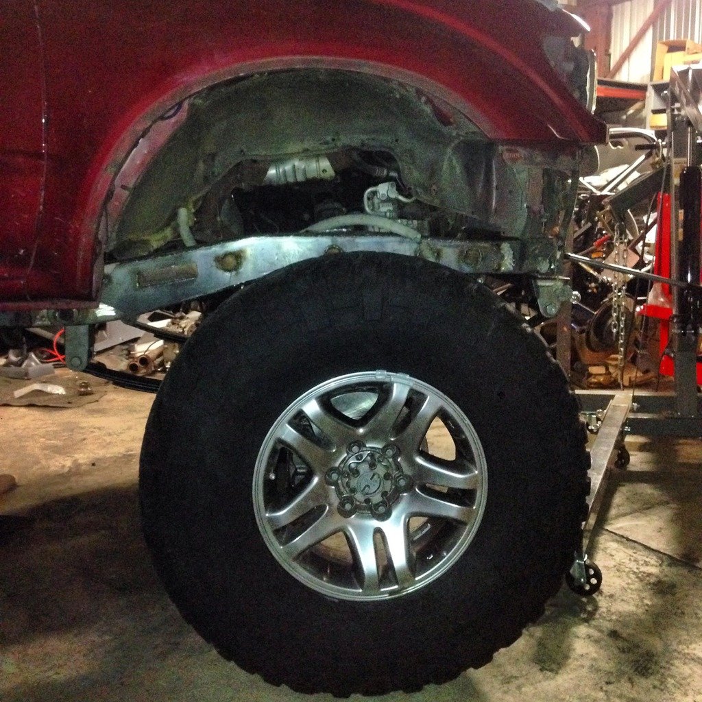

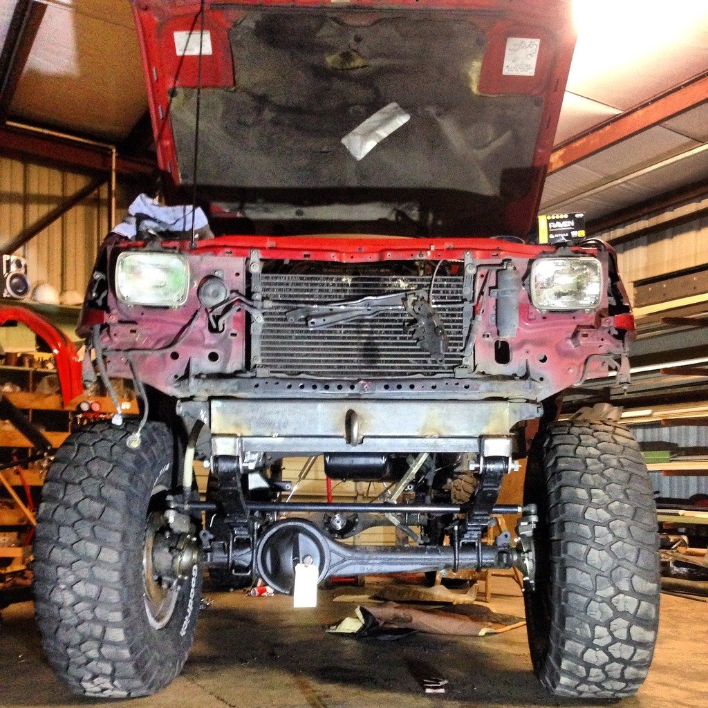

    Front Axle:
    -5.29s
    -stock birfs/axles [​IMG]
    -open (gonna put in a detroit this summer along with 30 spline longs)
    -fresh rebuild
    -high steer
    -tg 4" springs
    -12" bilsteins
    -tg frenched shackles

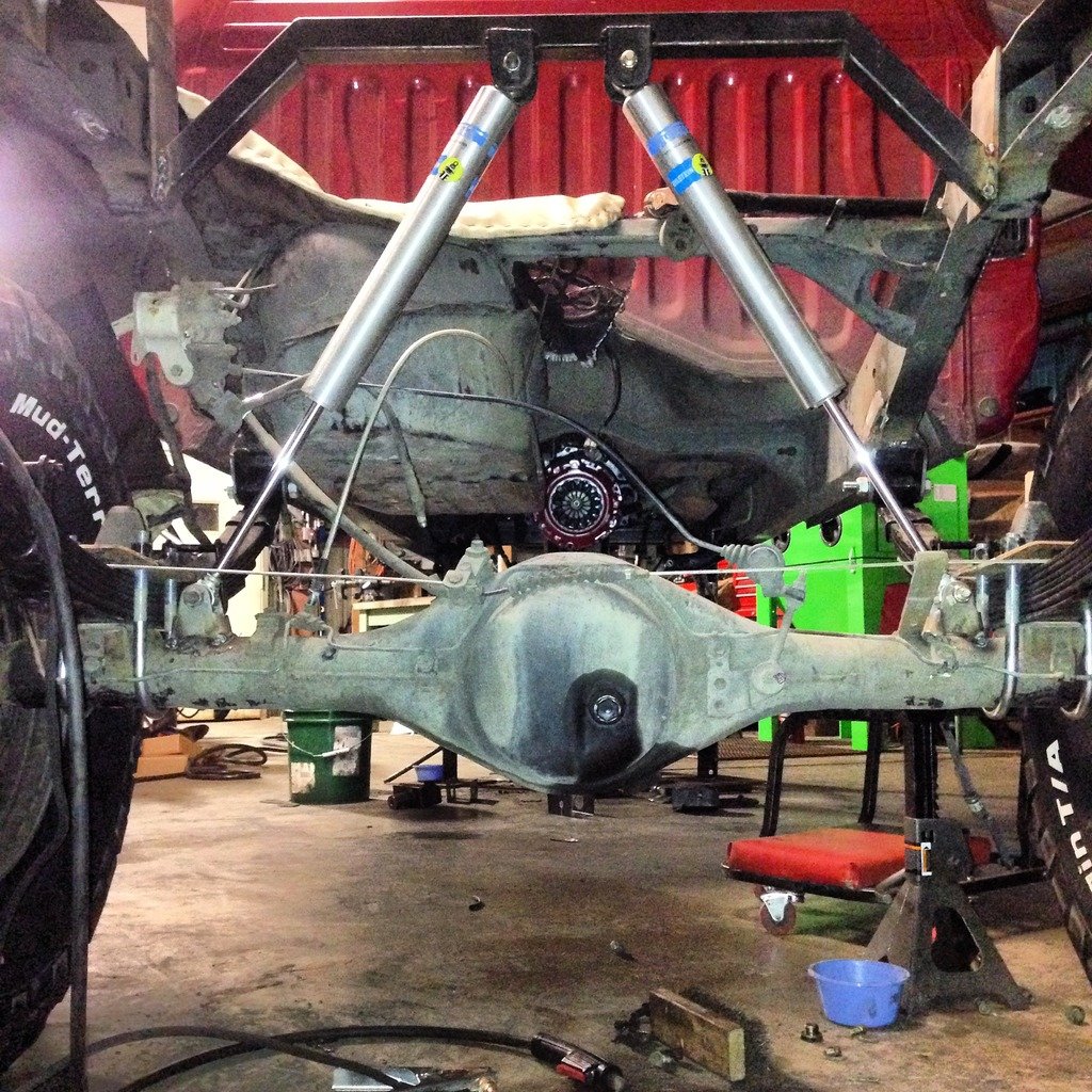

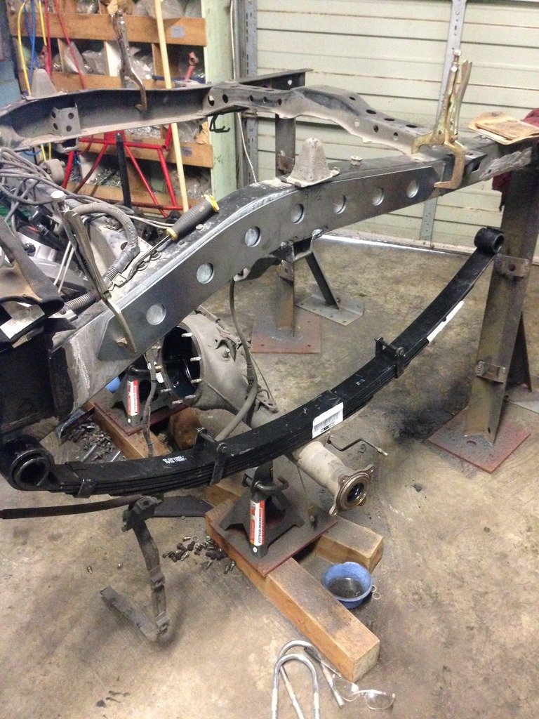

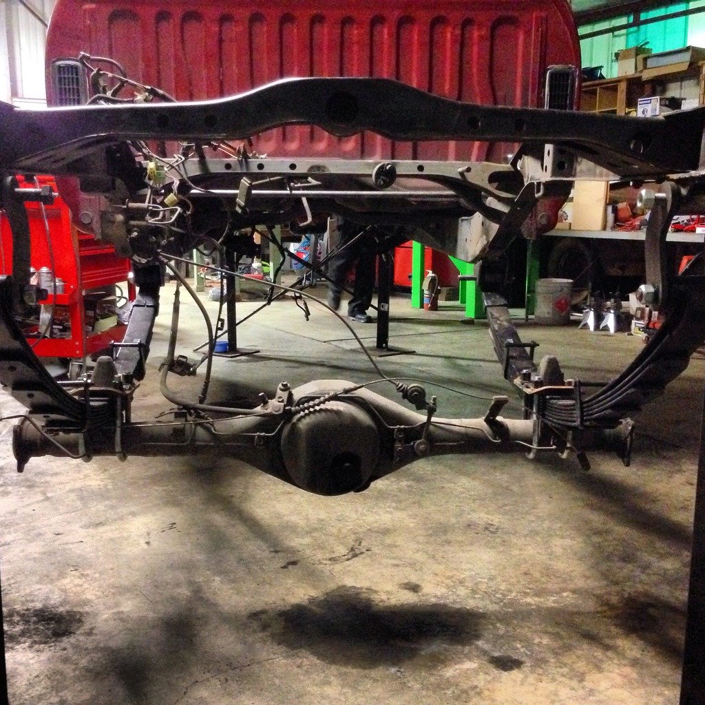

    Rear Axle:
    -5.29s
    -detroit
    -tg 3" springs
    -boomerang shackles (anyone run these or not run these for certain reasons?)
    -12" bilsteins
