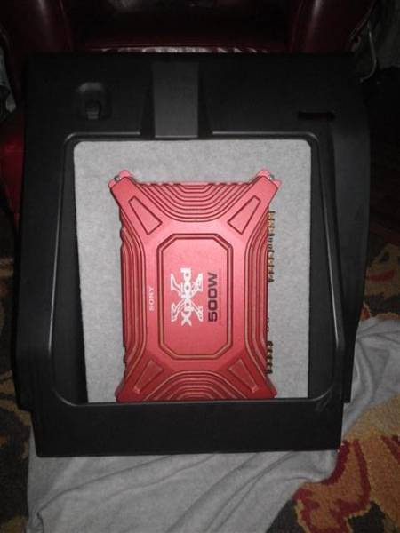

    I wanted to share these pictures of how I installed my amp today. I didn’t want to drill any plastic pieces at all so this is what I came up with. It’s just a piece of 3/4" plywood cut to size and carpeted. I drilled a hole through the plywood for all the wires at the child seat anchor. I screwed the amp to the plywood and used some spacers so the wires can run behind the amp. I’m using the two bolts that mount the plastic to the cab to hold the plywood in place. I know the amp is crap I hope it will work until I can afford a better one.

    I like it. It's clean and very professional looking! Great job. :thumbsup:
