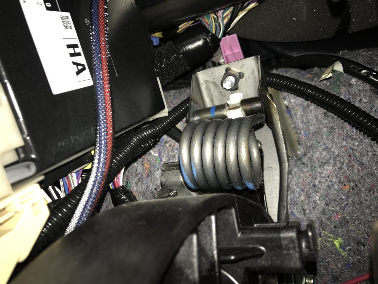

    What I've done is remove the clutch pedal return spring (on top of the clutch pedal near the pivot point) as shown:

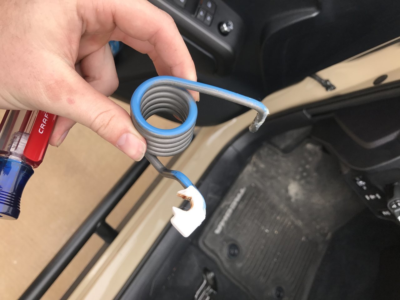

    These springs make for a mushy, non-linear feel and IMO feel terrible and lead to crappy clutch modulation and performance. The spring, shown in the above picture is mounted in two points; one on the metal cross-bracket and one on the top of the clutch pedal. Below is the spring after it was pulled:
    All you have to do is get a pair of pliars, depress the clutch pedal to the floor, and grab the longer side (without the plastic mounting piece) and push towards the outside of the truck. With a little wiggling and elbow grease it comes right out.
    When you take it out for a ride you'll notice a crisper, more linear feel. It is significantly stiffer, so you won't have to skip leg day anymore (at least with your left left leg). So, for those people with the MT that complain of a sloppy, hard to read clutch this is the ticket.
    If someone else here has posted about this, sorry! I didn't see any posts about it in my short time on this forum.

    St. Germain, it is easily replaceable. It just slides in and slides out with some elbow grease. Make sure not to break (or lose) the plastic mounting piece. The blue side of the spring, as shown in the picture, match the blue line painted on the cross-bar. In case you want to re-install it if you don't like it.
    MOC221, yes it is. It does make the push significantly lighter and pushes the pedal out all the way when the clutch is dis-engaged. It will get harder to push in, but got rid of all the bucking and weird feeling shifts I was experiencing when I first got the truck.
