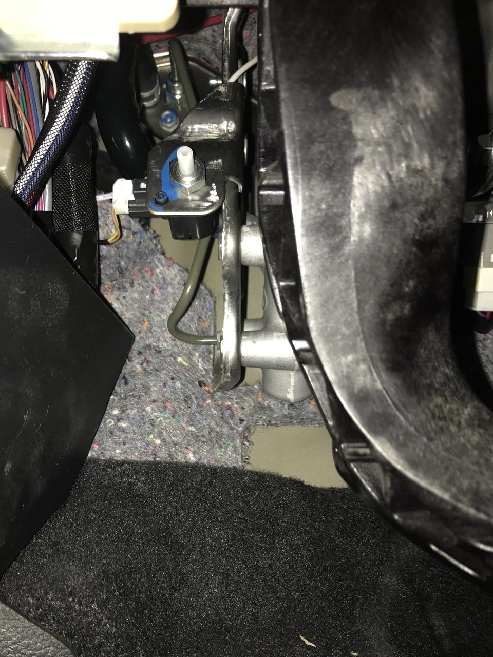

    So, having thought about this for a second, there's only two things that could cause this "sticky" feeling. If it is in fact this spring, the temperature does affect the spring rate. As the temperature changes, the spring rate will change; therefore changing its feel. The other is the hydraulic system. Like anything this also can be affected by heat. Though not as much as metal.
    My thinking is that removing it will have no negative effect on the "sticky" feeling. Maybe It'll get rid of it. I'll leave that to the people actually in the cold!
    I also noticed you can disable the clutch start feature very easily on these (aside from the button you'd have to press every time you start). It's just a pressure sensor to the left of the clutch pedal (with blue mark) as shown in the attachment:
    I personally like this feature and will not disable it, but for those of you who would like to always do it just keep this depressed and no more clutch start!
