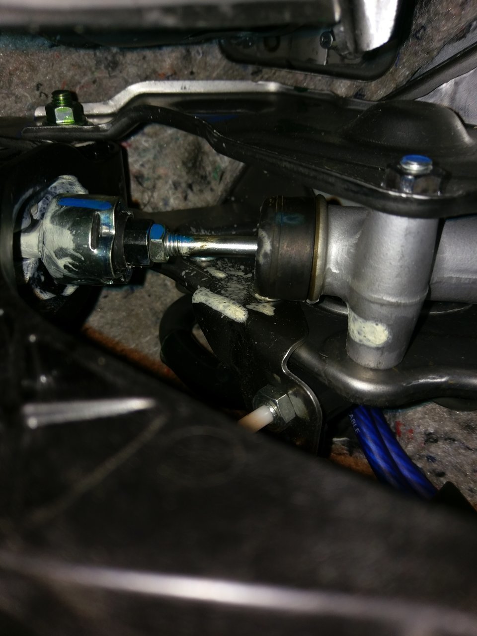

    su.b.rat
    su.b.rat broken truck
    Jul 30, 2016
    #193316
    9,869
    this? sorry for any wrong info.i just assumed the master cylinder would be under the hood. assumptions y'know. :confused:

  15. Feb 4, 2018 at 5:28 PM

  16. Feb 4, 2018 at 5:31 PM

    Weird. I'll have to look at it some more when I have the time and try to figure it out. Thanks for the info.
    Germain, the part on the right is the MC. It also looks like you've got some clay looking mud all over!

    haha. that's insulation. what you're supposed to notice in pics like that are my fancy stereo wires.

    Hahaha! Yeah. That's the clutch master.
