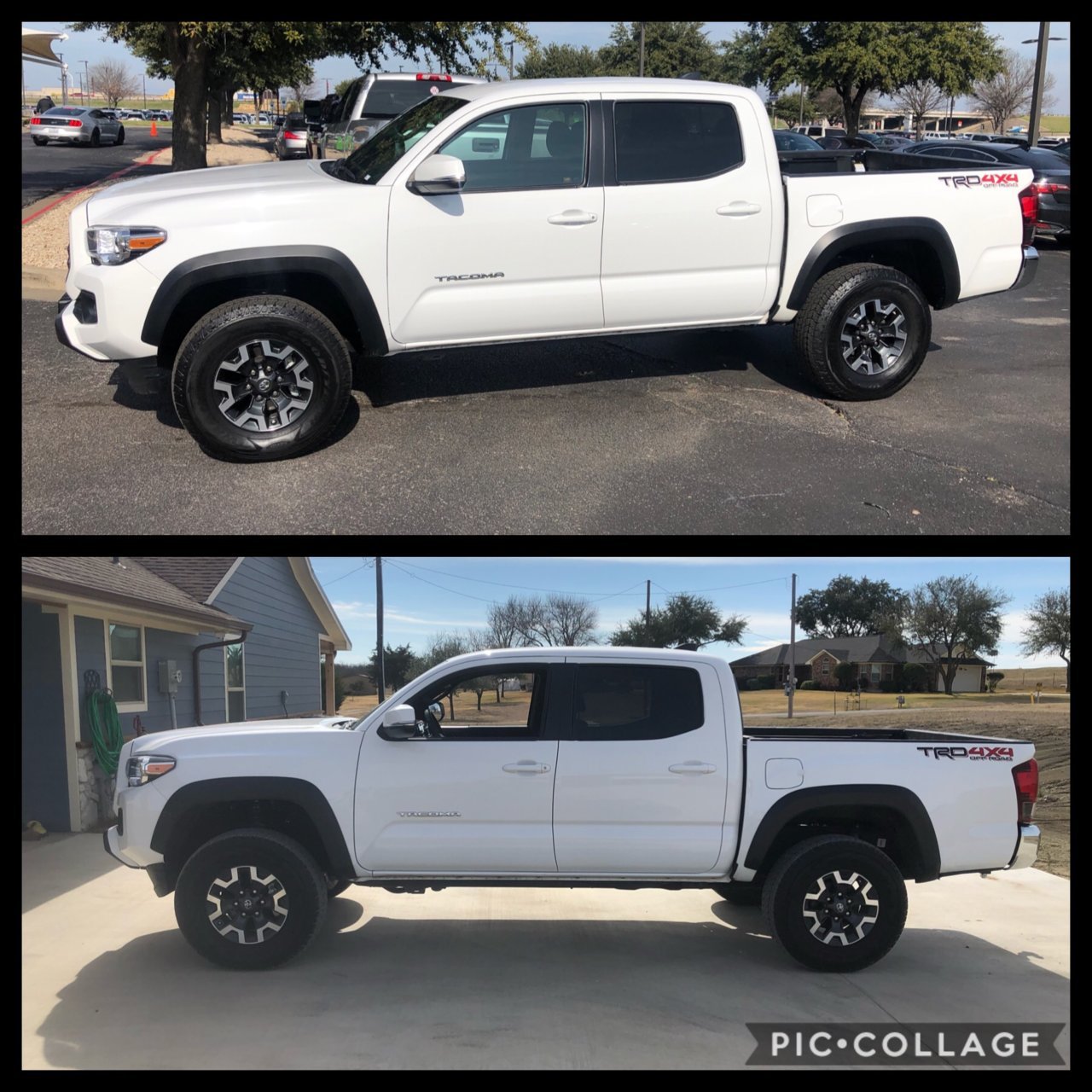

    F115BA53-5F8E-4B48-8B21-CE93D16F0768.jpg Installed a 2”/1” leveling kit this week. Rear blocks weren’t tapered, will that be an issue? I can always buy a shim or even buy new tapered blocks if so. The rear end seems fine as of right now. The front went on pretty well, kind of a bitch by yourself. But everything went on well and torqued to specs. Here’s the but...I noticed the infamous vibration when I drove it after the install. It seems like it’s right under me in the stearing wheel. I’ve done lots of searching and everything I’m experiencing is saying the needle bearing...I have a really hard time thinking the 2” makes that huge of a difference. The only thing i haven’t tried is setting it in 4h to see if the vibration goes away. But something’s telling me it’s gonna make it even more evident. I didn’t go with the 3”/2” thinking it would be more of a hassle. Is it yalls opinion as well that it’s the needle bearing? Thanks in advance!

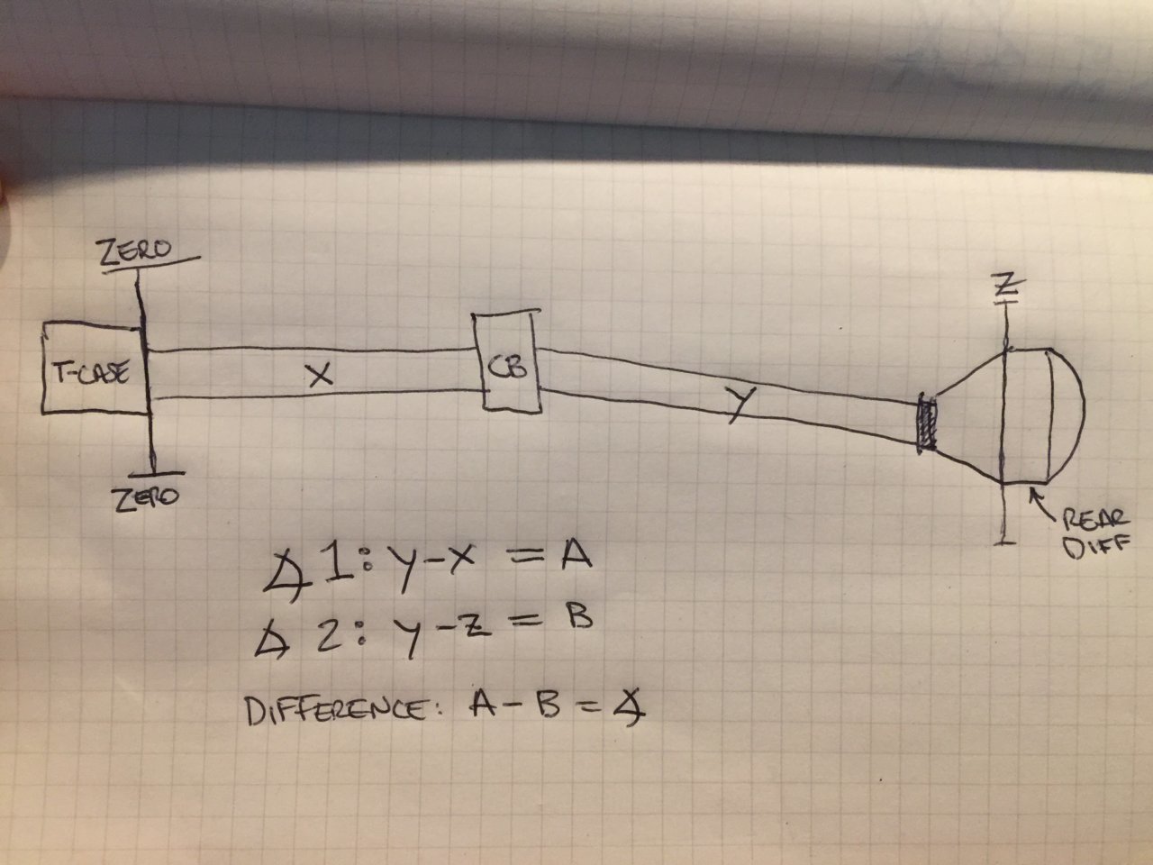

    Get a digital angle finder.
    Zero it on the back of the transfer case (somewhere flat that is parallel with the front shaft) you need to turn the gauge so that when you zero you are zeroing parallel with the shaft
    Shaft 1 is X
    Shaft 2 (shaft behind carrier bearing) is Y
    Z is the angle of your rear diff (measure on the flat side to the right where the shaft and pinion comes out)
    Working angle 1: Y-X
    Working angle 2: Y-Z
    The difference of those should be within 1 degree of each other. Let’s say it’s outside 1 degree, like 1.5. You then need 1 degree shim to put it at a 0.5 degree difference
