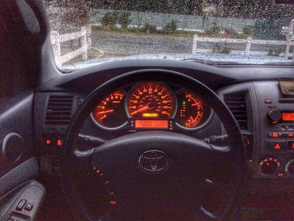

    I tried this for awhile, but moved it to the headliner after deciding I wanted to be able to see the idiot lights.

    I opted to go with this install. Super tidy, convenient location (just to the right side of my sunshade). The tip on going to a dollar store was brilliant. 2.50 for two tape measure's and then just used hi quality double sided tape.
    The cable is easy to run and the perfect length. Just take off the handle on the A-post (pop off the caps and two phillips screws), and pull the top of the trim towards the center of the truck (leave the bottom in where it is). Put a straightened coat hanger down where the other cables run. Tape the ethernet end to the coat hanger and pull it up. Then remove the sun shade (two phillips screws) and just run it up the A-post trim and then tuck it under the front of the ceiling trim along the windshield to where you mount. Super easy, clean, no drilling or permanent marks made. Perfect.

    Another simple way to mount it up high to the headliner is to put some velcro on the scangauge (the hard side), and just stick it wherever and whatever angle works best for you

    This did not work for me. I ended up attaching one belt clip in the middle, then used a piece of velcro on each end to stabilitze it.

    i tried velcro and it has worked but the summer heat melted the adhesive a few time, just had to stick it back together and it worked out.

    I've been looking at this for a solution to mount my scan gauge. So here's my question for those of you that used the tape measure clip method. Did any of you have to open up the clips a little bit. I don't want to crush the curved lip of my head liner at the wind shield. Any help here is greatly appreciated. And a giant THANK YOU for the brilliant idea goes out to Detective Dan.

    Yeah I found the particular tape measure clips I got too tight. Thats why I ended up making the custom clips I did
