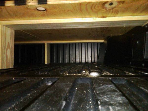

    I think the reason your 2x6s needed to be shimmed is that they don't appear to be 2x6s. In the photo, it looks like they are the same thickness as the 3/4" plywood, which would make them 1x6s. I think 2x6s would also be plenty strong enough to support two people, without center supports.
    Edit one day later:
    I just installed 3/4" plywood over 2x8s in my 2011 regular cab and there's no sag. I had to trim/narrow the last inch of each of the 2x8s down by about 3/8", since the slot is only 7" wide and a 2x8 is 7 3/8" wide. I figured it's better to have a board that fills the slot than one with slack.
