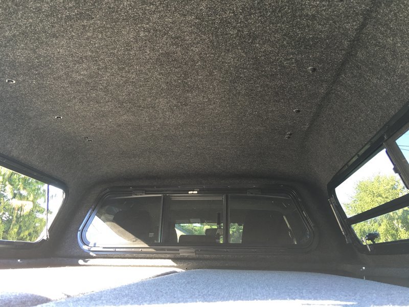

    I'm really hoping to do this when I get cap in a couple weeks. I have estimated that there is about 28'' from the platform to the ceiling. My dog's shoulders measure about 28'' from the ground. I REALLY hope she'll be about to fit!
    EDIT: I REALLY hope she'll be ABLE to fit!
    Does anyone know the height from the platform to the ceiling of their standard sized shell?

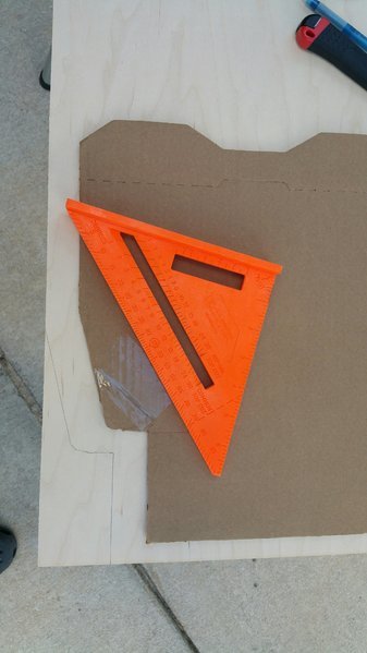

    20160719_093025_1469107374121_resized.jpg 20160719_101311_1469107378357_resized.jpg 20160719_112628_1469107382068_resized.jpg I just finished building one for my 2015 Tacoma Sport.... Love It! I used 3/4 inch plywood (2 sheets), 2x6 cross boards and indoor/outdoor carpet. It is STURDY!! We have on order an A.R.E. MX series camper shell to use this bed deck with.
    I used a pizza box top to make a stencil for the rear cutout for the plywood. The 2015 bed near the tailgate has a few angles you need to contend with. I carpeted the plywood and the 2x6's. Great project. :) An after thought I had was to use Thompson's Water Seal on the wood before I carpeted it, just for extra protection.

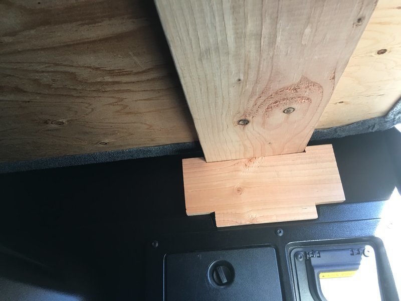

    Used the same concept for my 3rd gen but raised it up a bit. I used 2x8's and 5/8" plywood and some 3 inch foam.image.jpg image.jpg image.jpg I can't carpet for the life of me but you get the idea.

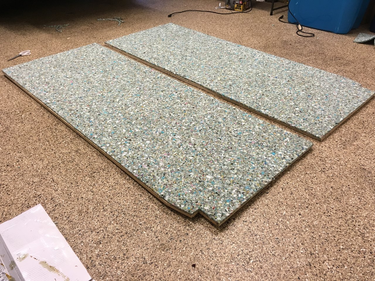

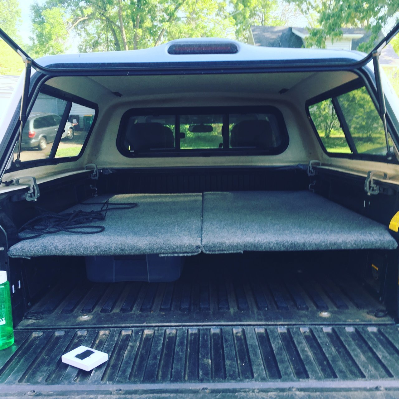

    I kept to the OPs design, except I added 1/2'' carpet padding:

    Thanks. I used it on previous sleeping platform as well and was able to sleep on it without additional padding. However, a basic camping pad or foam yoga mat makes a big difference. I am cosidering getting a full size mattress foam topper for this platform. I'll see how it holds up camping this weekend and decide afterwards.
