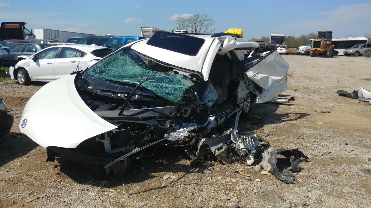

    Man, I thought that was a Corolla when I first saw the picture. That must have been a huge trailer! Hope your wife is fully recovered or well on her way. We have the same van. I hope it will protect my family like it did yours.
