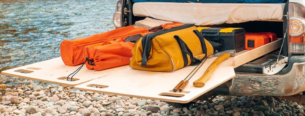

    Ok so I'm getting irritated with having to rearrange my crap in the back of my truck. I have bakflip and stuff all my stuff and kids sports stuff back there. I want something that pulls out but don't want to lose height with having a 2 layer drawer system. I want simpler.
    I plan to cut my bed mat in half length wise then cut a piece of plywood similar to this picture. Only one side.upload_2025-4-23_13-58-53.png
    The board will just slide on the bed floor, no wheels, I'll be aware that it can tip forward if pulled too far out. I'd waterproof the wood as best as I can (bakflips leak in 3rd gens).
    Does anyone see any issues with this plan?
    thanks in advance.

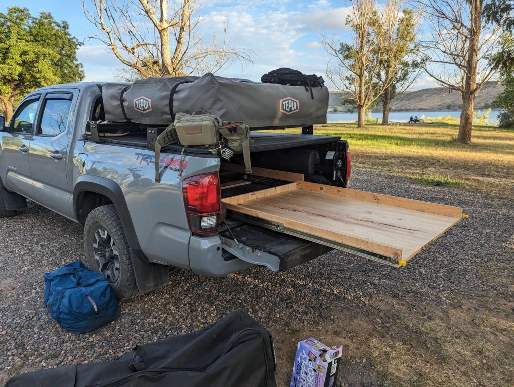

    I made something similar. It got difficult to close when there was a lot of weight in the middle, the tray would flex too much and get caught on the bottom. Probably could have built it differently, but it was kind of last minute before a couple week trip

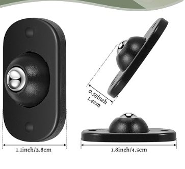

    I was just going to have it flat in the bed, no rollers or anything. Won't have super heavy stuff on it. I also considered these:
    But I think I'm just going to cut plywood and see how well it can slide before buying the rollers.

    I had some wood near the cab that pressed up against a lip so the drawer wouldn't tip out

    I found that it doesn’t take much weight to make it really hard to slide a drawer or platform out. I have a drawer about 3’x3’ that I use a pulley to haul up against the front of the bed(saw horses fit behind it) 6’ saw stand to one side) and tried nothing, embedded roller bearings, and wheels and the wheels are by far the best. Even thick ply will bow and drag in the middle so one there does the trick. I use 2” wheels with bearings and block them to hold the ply ~1/4” above the bed ribs with the wheels riding in the channels. The wheels also act as stops when they come to the tailgate gap and the tailgate top so you can use those locations to locate where to put the wheels that do come out that far.

    I have a set of BamBed sliders I haven't used yet. These rollers look that might be something to install. Where would I purchase them?

    Rollers that small and hard don’t roll over even tiny bits of grit, anything like a few grains of sand and they’re worthless. Glides work because they’re suspended above the grit but wheels need to be 2” or larger to roll reasonably well.

    The ply would dent and then drag on the roller casings. Those are designed for elevated transfer (called transfer bearings) in relatively clean environments.

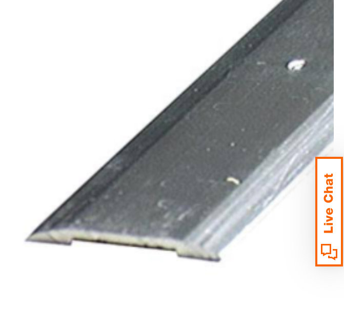

    Maybe some aluminium flooring transition to use as a guide…

    That could work as long as the transfer bearings don’t catch on the fasteners holding those plates in place and they don’t come loose. It’s an additional set of parts though and introduces another point of failure. I still think it’s a bad environment for the bearings and they’d end up corroded and sticking. Wheels are dumb but pretty reliable.
