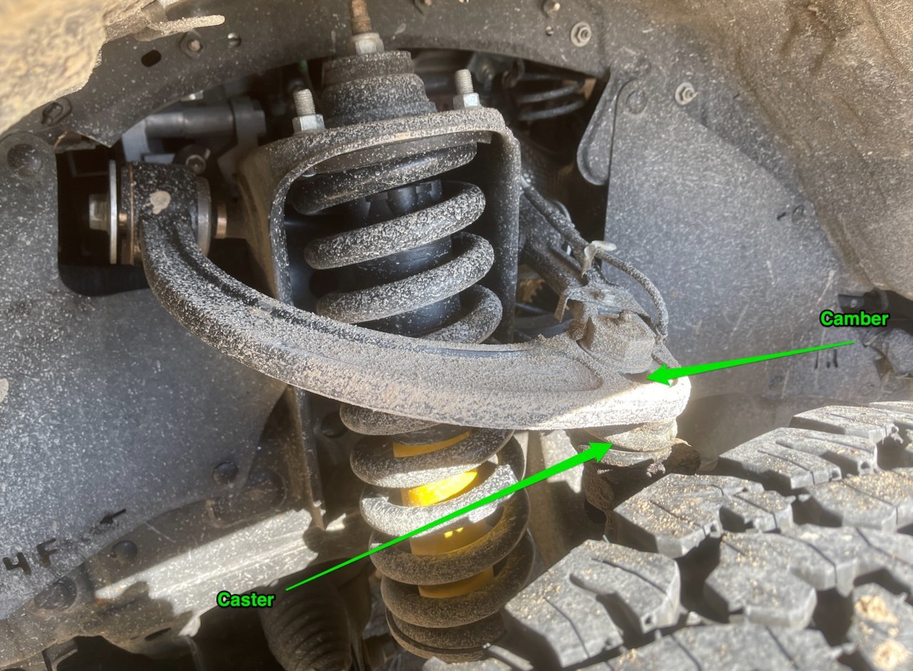

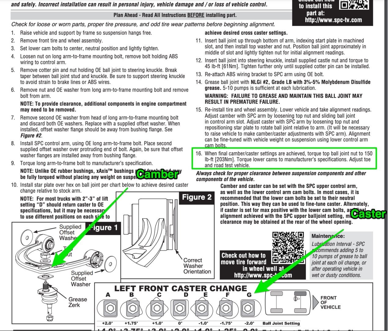

    You might want to do more research on SPC UCAs before attempting to correct a member with incorrect information. SPC UCAs allow both Caster AND Camber adjustment. Caster is adjusted via the star plate and ball joint positioning. Camber is adjusted via the machined slot. BOTH camber and caster are adjustable with SPC UCAs. The more you know.

    i did do the research...i have taco tabs, rear towards the wheel, the front towards the engine for max caster. thats set there...i can still add caster degree on top of the spc...the camber gets adjusted by sliding the spc from right to left. Toe will still be the same with tie rod. ive already replaced a balljoint for free with warranty without having to do an alignment cause i used a paint marker to mark the position of the camber its in.

    This feature allows you to max caster out on the LCAs, giving you the most tire clearance at the firewall, and still be able to get camber in spec.

    the biggest debate ive had with spc is the setting people are putting it on. i keep on seeing it put on "e, f, or even g" for max caster. Those put it in negative caster with bringing the top forward and pushing the bottom towards the back. If the flat part with the spc logo facing the tire, "a, b, c" brings it to positive caster, bring the balljoint to the back and the lower pushing the wheel towards the front.
