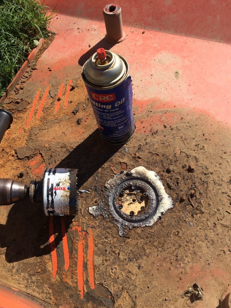

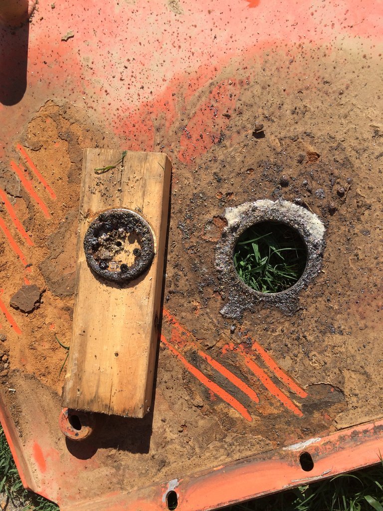

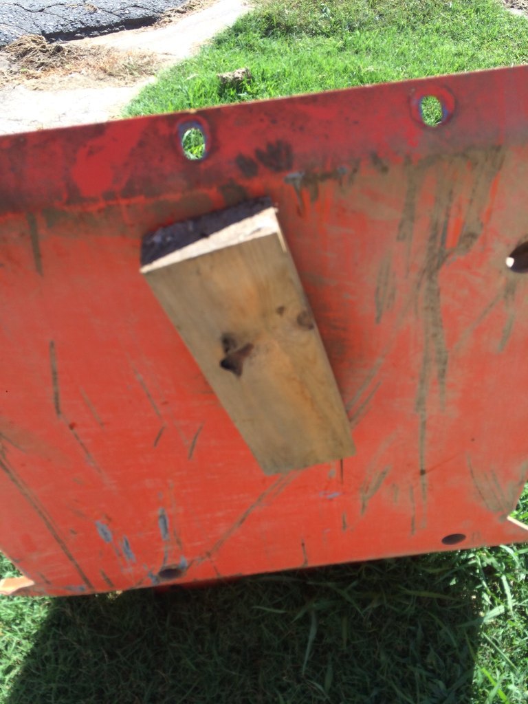

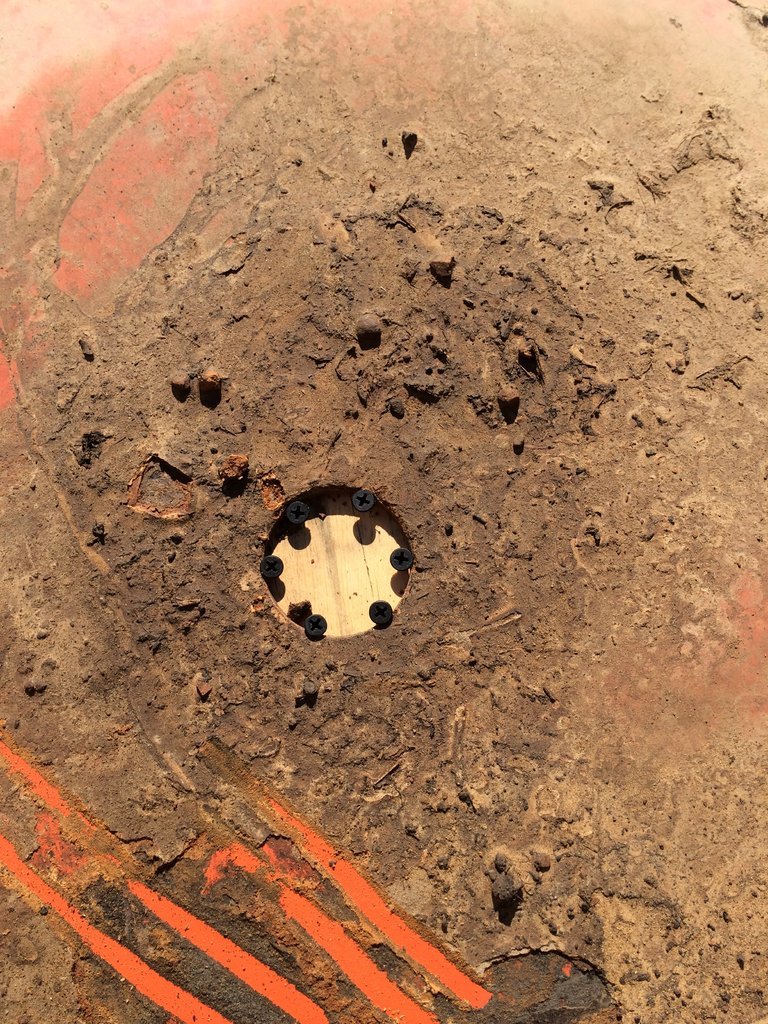

    Also, since I removed the skid plates, I fixed an issue that has been bugging me for 2 years. The hole in the IFS skid for changing the oil is too small, and it's nearly impossible to not spill oil on top of the skid. :mad: Anyway, I think I fixed that today. I changed the 2" hole to a 3" hole.
    Here is a trick I used to enlarge the hole. As you know, the pilot bit on a hole saw needs to make secure contact with something, or the hole saw will just dance around. I screwed a piece of wood to the back side for the pilot bit. Worked great! All I need to do now is clean it up and file off any sharp edges.

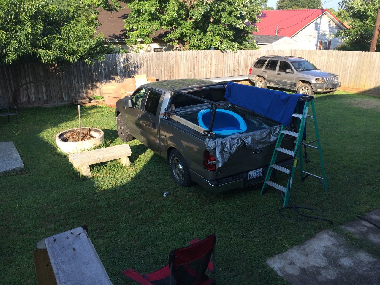

    I like how you cut that hole in there plate, ingenious! The pool in the back of the truck is awesome! So you're gonna run a shell on the truck now? They sure are nice! One of the best mods you can do, IMO. Nice updates all around! :)

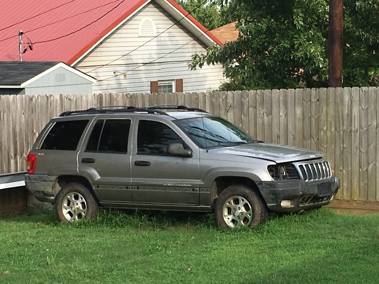

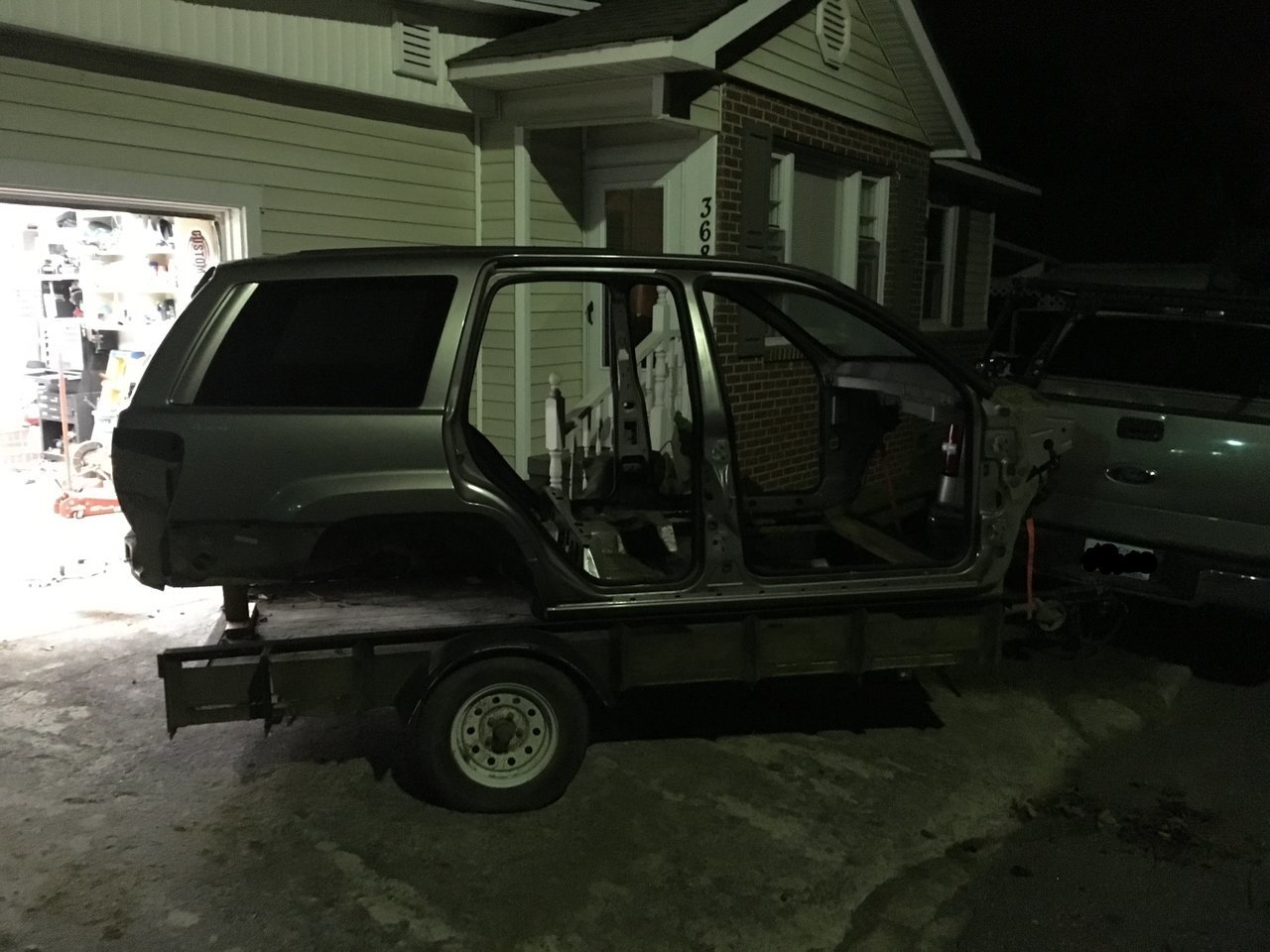

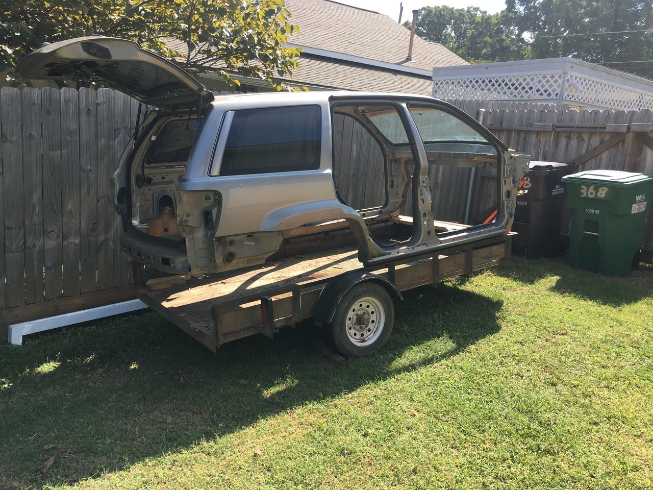

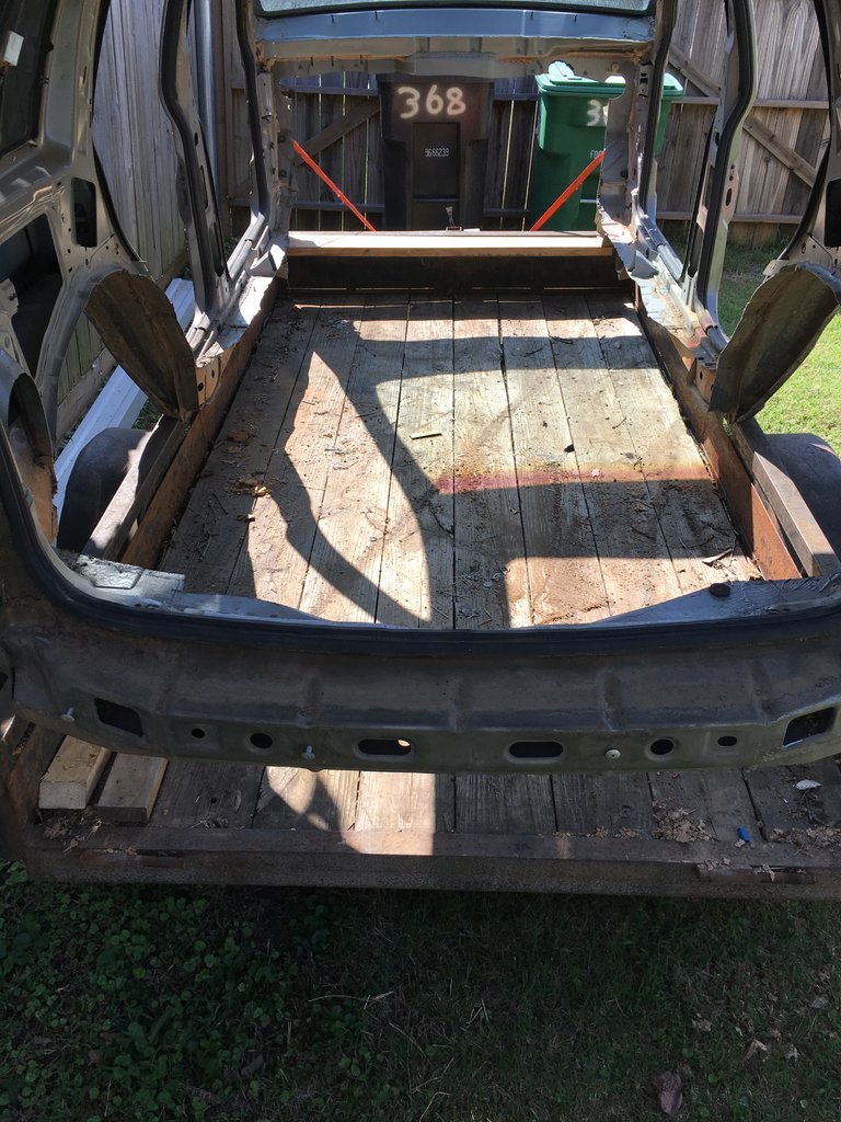

    I cut the floor out of the jeep today, and now it's time to drink cheep beer and dial in my plan.
    The jeep's rocker pinch welds fit perfectly inside the trailer's top rails. The plan is to essentially make the jeep into a slide in "camper" like the cab over ones you see on full sized trucks. I will build a new floor for the jeep that sits down on the trailer deck.

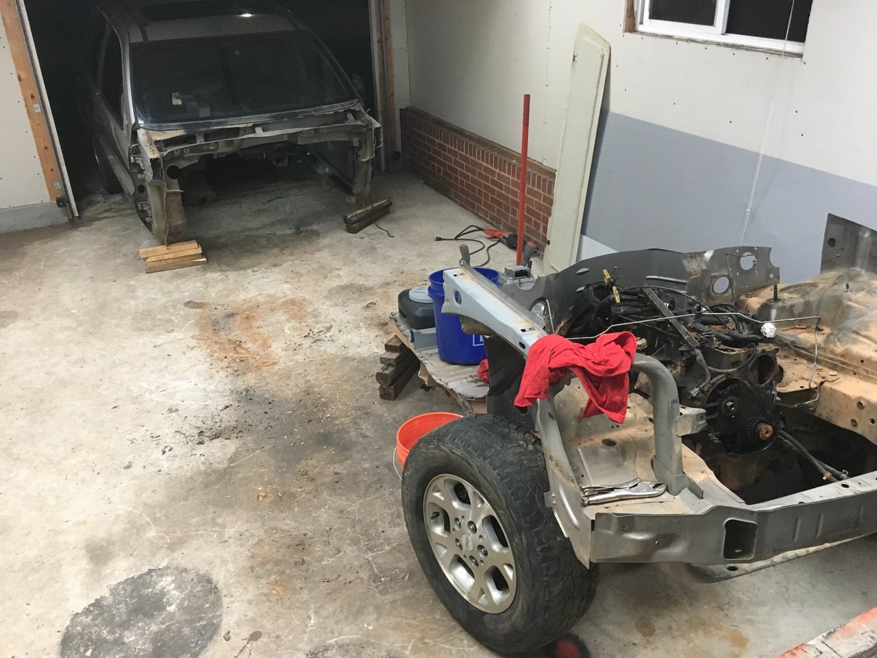

    I guess I should start the jeep trailer build from the beginning. I bought it for $300 with a blown motor and promptly took it apart. There, you are caught up. :D
    I saved all the usable parts for a 4x4 swap on a twin of this one I used to own years ago. Long story, but I'll be getting it back and plan to make it my trail rig. I'll spare the Tacoma from some of the heavy abuse.

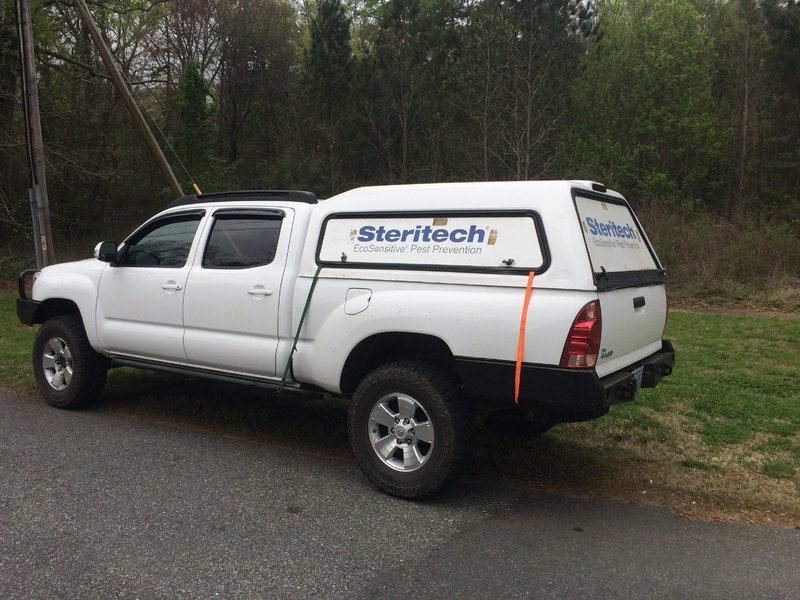

    Since the trailer is more of a winter project (and a big one), I figured I would put some windows in my camper shell. That way I have something to use this fall. Since it is a $40 camper shell, I decided to use some scrap plexiglass and aluminum I had laying around. I have a few more pieces of plexiglass for the other windows.
