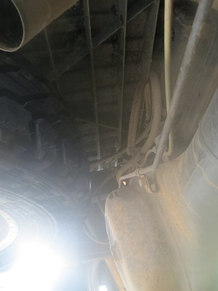

    Time for an overdue update. My needs from the truck have changed a little. I use it more for work and everyday life activities now. Also, there is a bit more stuff that goes along on trips, so I have cleaned the bed out some.

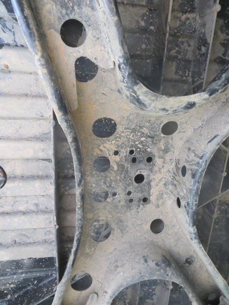

    First off, I moved the spare tire out of the bed and back under the truck. This proved to be a little bit of a challenge, as the new full size spare (255/ 80/ 17) was nearly touching the rear diff at ride height. It would have made contact under normal suspension travel, and that's no good. :) Here is an okay write up of how I moved the spare away from the diff a little while still under the bed: https://www.tacomaworld.com/threads/255-85-r16-owners-experience.155849/page-156#post-10903568
    I basically just drilled some new holes to move the tire hanger.
    Crappy picture, I know.

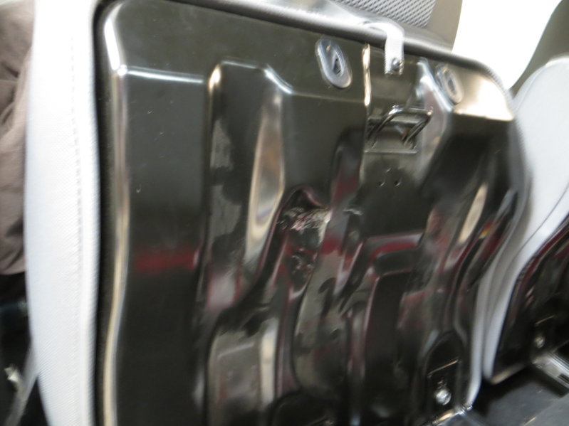

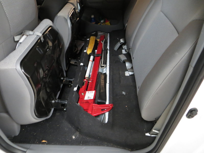

    Next up was to find a better spot for the high lift jack...
    My jack is only the 48" one, and I had to remove the plastic bins and the lift's foot to make it fit. I also had to make a small "adjustment" to one of the seats (crappy picture again).
    I really like it hidden in there. As an added benefit, I won't need to clean and grease it very often.

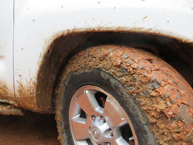

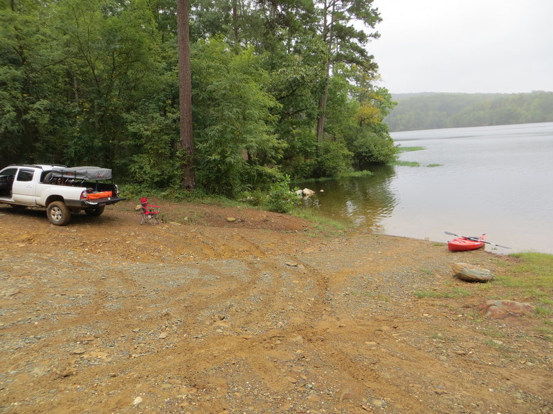

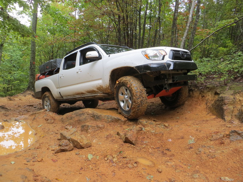

    Here's a few pictures of a small trip I made solo to Uwharrie National Forest.
    It was a very wet day, and the new Cooper S/T Max tires worked great! I aired down to somewhere between 10-20psi (I badly need a reliable tire gauge, haha).

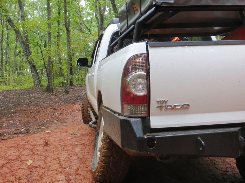

    Front tire (255/ 80/ 17) stuffed without fender flare. Plenty of room...
    Stuffed rear.
    Yes, I know my bedside is bent a little out.
    Spent a few hours on the water and didn't see a single person.
    Then sat down and had a beer (Unless you're not supposed to have a beer in a national forest. In that case I found this empty bottle). North Carolina is home to me, but since I grew up near Sacramento, I had to enjoy an old local favorite of mine.

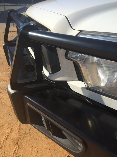

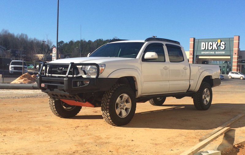

    So, this is how an ARB bumper made for a '05-'11 Tacoma looks on a '14.

    I chose this bumper over the 'correct' one simply because it's smaller and doesn't hurt the approach angle as bad. This style hangs out the front a few inches less than the correct one and the hoops are a little lower. I think it looks better, as it fits the size of the truck better.

    Well done. :) How difficult was it to mod it to make it fit?

    Bumper looks great. Definitely doesn't look like it hurts the approach angles as bad as the proper one. Do you think using the improper year model would effect how the airbag deploys?

    Thanks! It wasn't too difficult. My main goal was to not adjust anything that effects the way it mounts to the truck. I did this by cutting a little clearance into both the bumper and the grill/ headlight supports. I'll put together a write up this evening.
    Thanks! There should be no additional effects to the airbag system caused be using the wrong year bumper. All the trucks from '05-'15 use the same frame, body, and core support. Also, I haven't read anywhere that they changed the front airbag sensors.

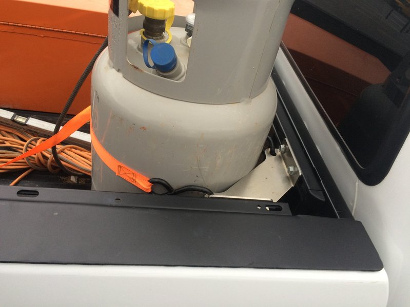

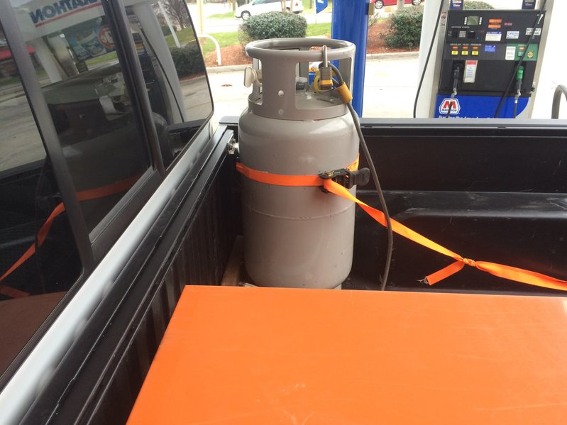

    Had to get a 40lb propane tank filled for work and discovered a neat little 'feature' of bed stiffeners. It holds the tank VERY stable tied down like this:
    I would recommend adding some sort of isolator if you keep a tank mounted this way to keep from chafing your tank. I like simple solutions to things, so this was a good find. I'm not sure the brand of the stiffeners. I got them used off @hetkind when he bought my camper shell, so maybe he will remember.

    Don't those look nice all painted silver...and I bought them from a vendor off this website. I think a piece of inner tube would make a fine isolator...
