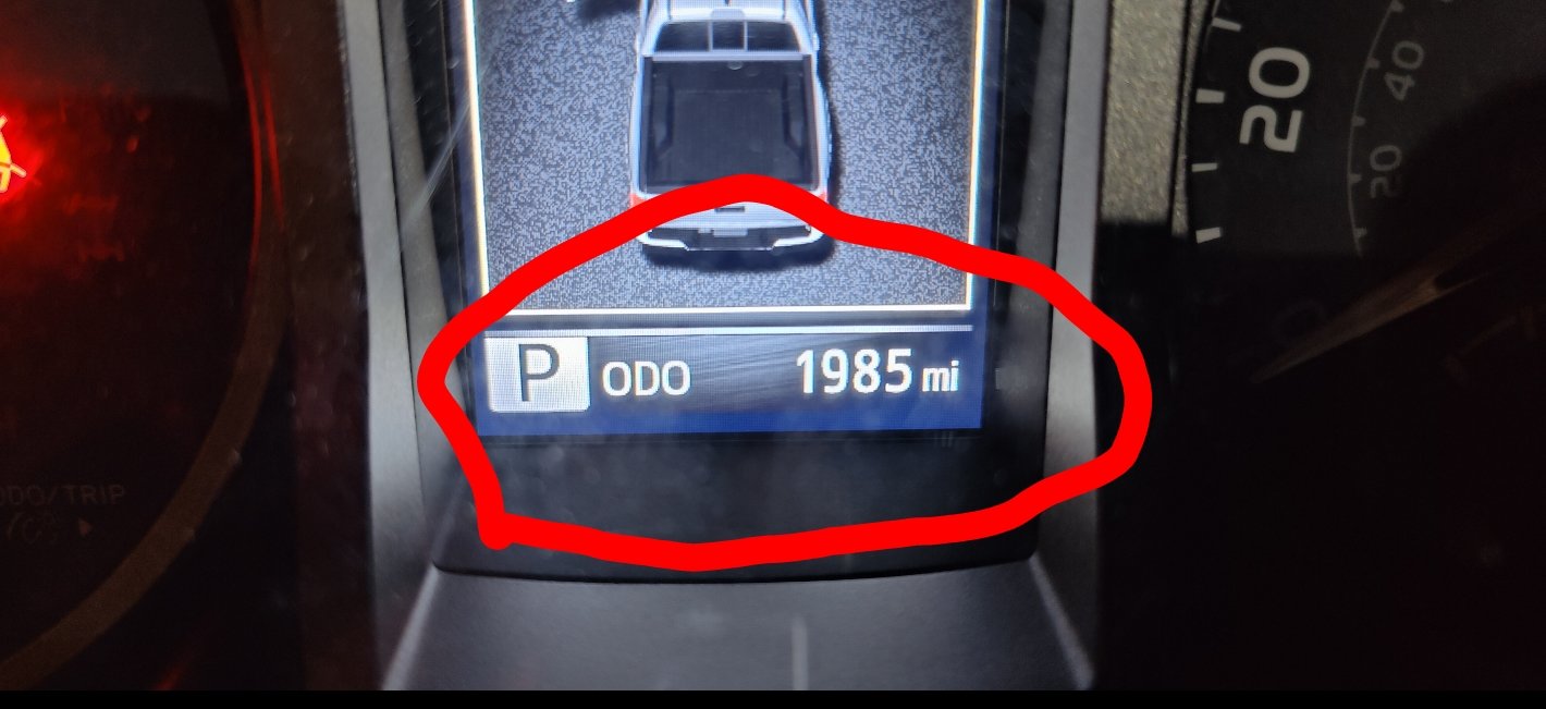

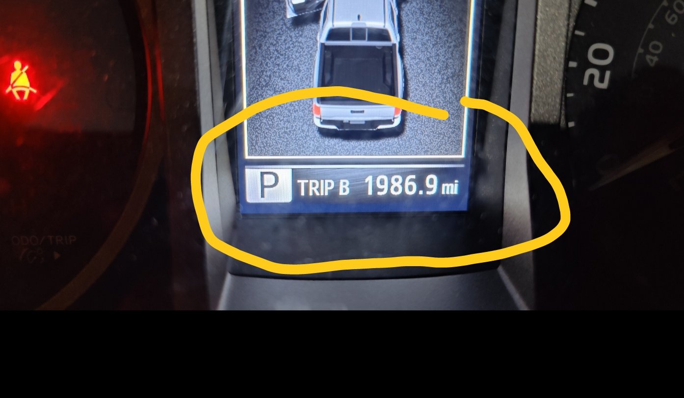

    Is anyone running 35's? Just wondering if when you log in to your account and your mileage is automatically updated, is it reporting the miles on your odometer OR are the miles being tracked and reported by GPS? It would make since from the manufacturers point of view. With 35's for every 100 miles on the clock I really drove 114 miles. So every 1000 miles that's an extra 140 miles free warranty. Every 10,000 miles that's an extra free 1,400 miles of warranty, etc...
    No one can explain this to me...
    I bought the truck new it had a couple miles on it. I ordered my new 3rd member from ECGS, in the mean time waiting on it I drove at least 300 miles.
    I set my trip odometer when I changed the 3rd member to keep track of the miles to change the oil in it.
    When I pulled all of the OEM stuff out, head unit, wires DCM, all of it, something weird happen to my odometer. Look at the pics.
    My trip odometer from when I installed my 3rd member has MORE miles logged than the odometer on the truck???

    Hmmm, wondered about this too, but assumed odometer would be based on the wheels turning only, and never posted or searched for answers…. If this comes up much, i would think there would be more posts around the internet about warranty / mileage issues.
    What’s a “3rd member” in the context of your post?

    I regeared it, I took the 3.73 gears out and put 4.56's in it
    But I didn't recalibrate the speedometer, so it still thinks it has 30" tires. 1 rotation of a 35" tire is covers about 14% more distance than a 30" tire. All 3 of my GPS speedometers, head unit, ScanGauge 3 and phone said I traveled approx 116 miles on I-10. The odometer reading about 102. I'm wondering if I had a DCM when it reported home which number would it send?
    Anyone with bigger tires notice if their odometer miles are different than the reported miles that get uploaded?
