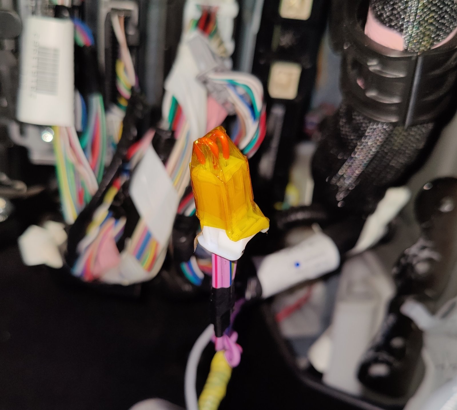

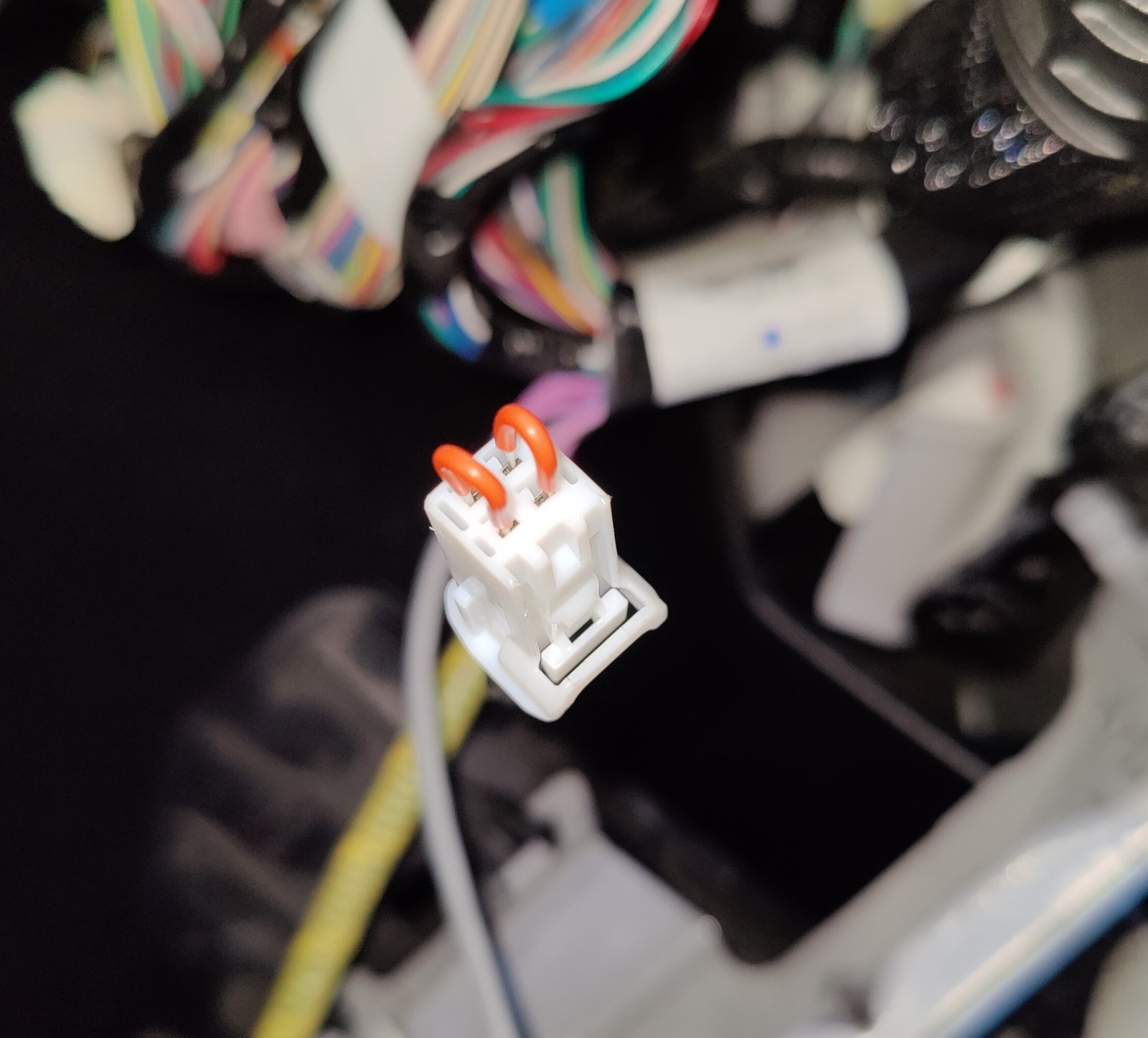

    Disconnected the DCM last night, very easy thanks to all the resources here. Ended up jumpering the pins for the speaker with some 22 gauge solid core wire, worked perfectly
