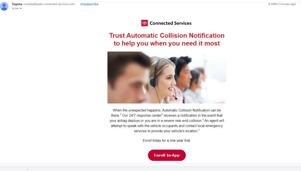

    Big Brother must know I pulled the DCM unit completely out of my truck, I just got this email trying to suck me back in to the matrix, lol

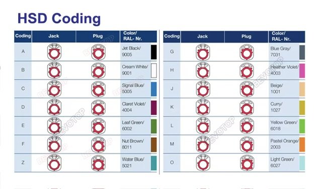

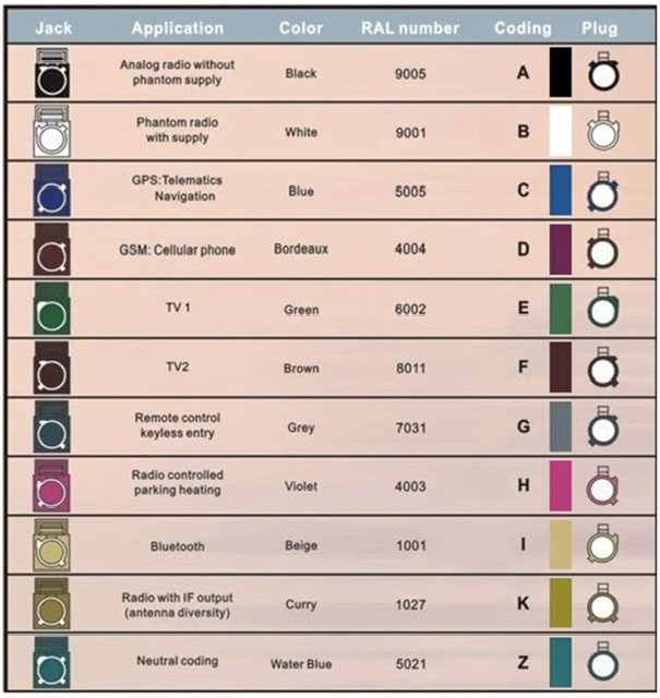

    I did the opt-out process, but haven’t done anything else as I have too many other projects. I have pulled the relevant info on the connectors so that whatever I decide to do can be plug-n-play.
    This may help other sleuths in the interim:
