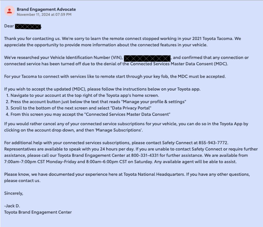

    If you opt out of DCM data collection via the formal process (denying Connected Services Master Data Consent), Toyota disables your key fob remote start, too. Talk about strong-arming you into allowing them to collect your data. :mad: Definitively lame.
    Edit: corrected to state that fob remote start is disabled, not fob remote unlock.

    Fob remote entry works still. Fob remote start (lock, lock, hold lock) does not.
    I opted out of DMC and Connected services 18 months ago. Fob still works to lock and unlock and remote starter worked until now. I used it last time in September, and it worked. Not working tonight.

    Correct! Typo on my part, thanks for the catch. I still think it's pretty lame, in that the fob remote unlock feature is just as much a "connected service" as the fob remote start--i.e. it doesn't require connectivity at all.

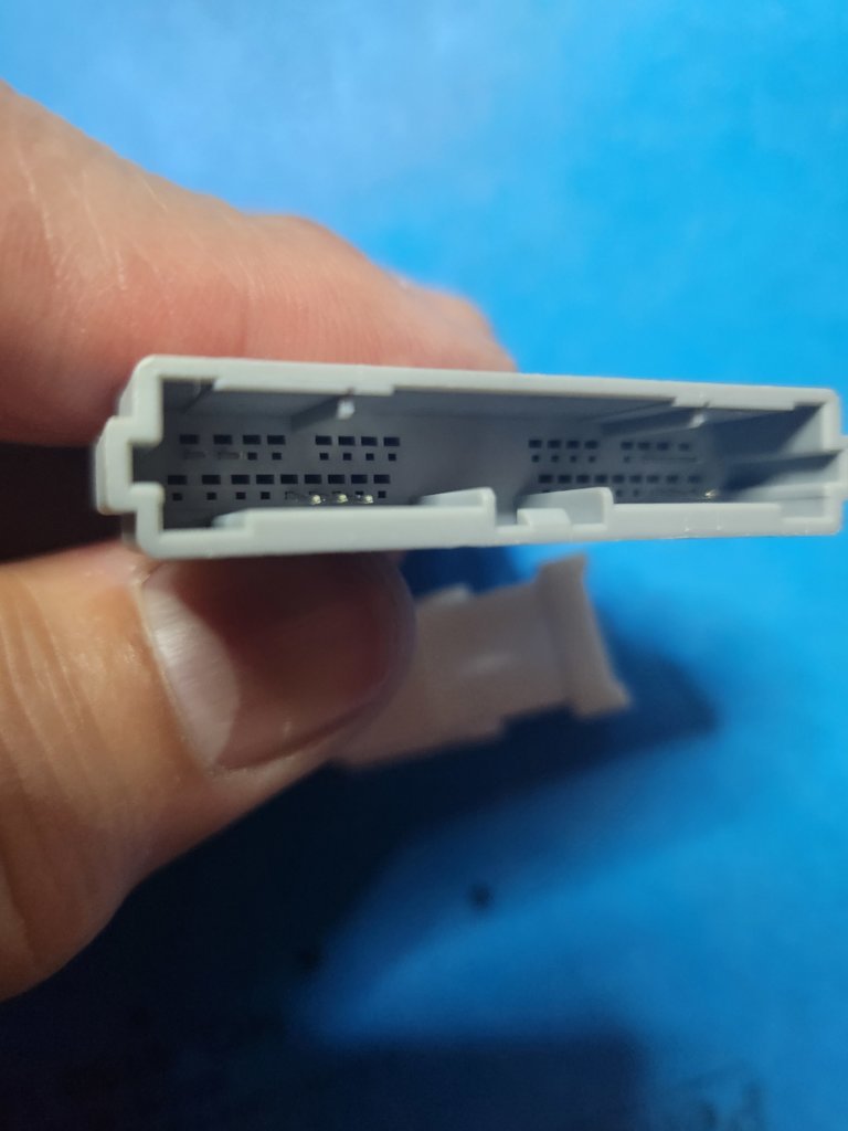

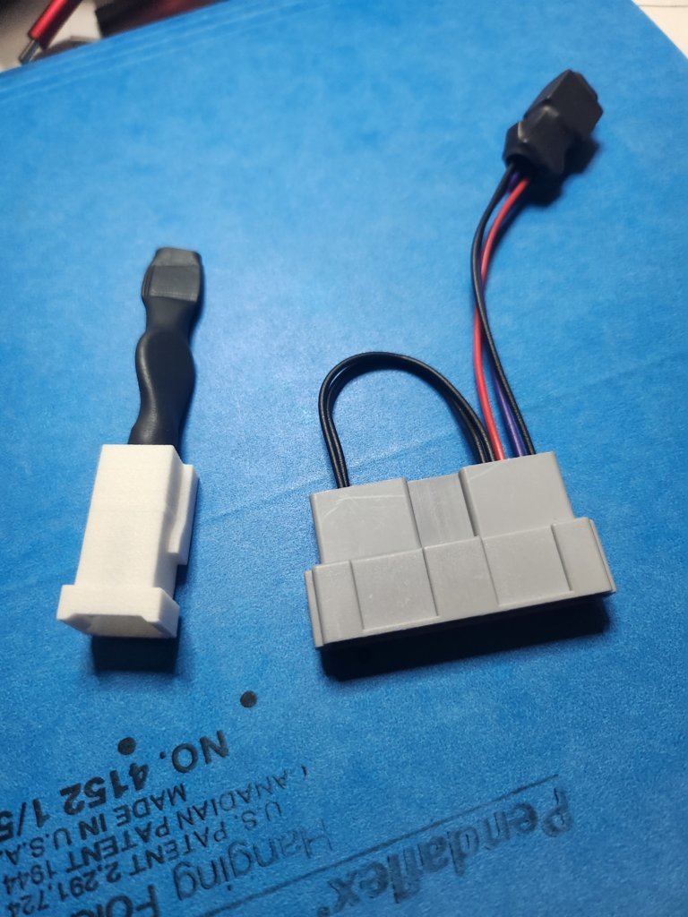

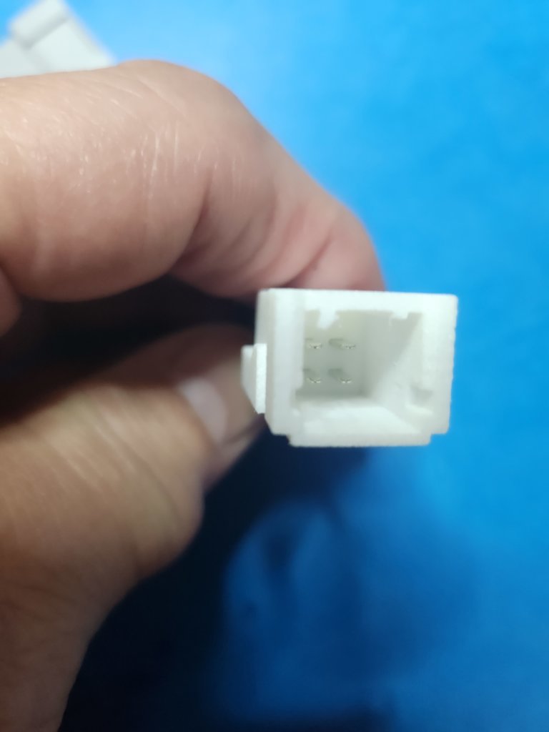

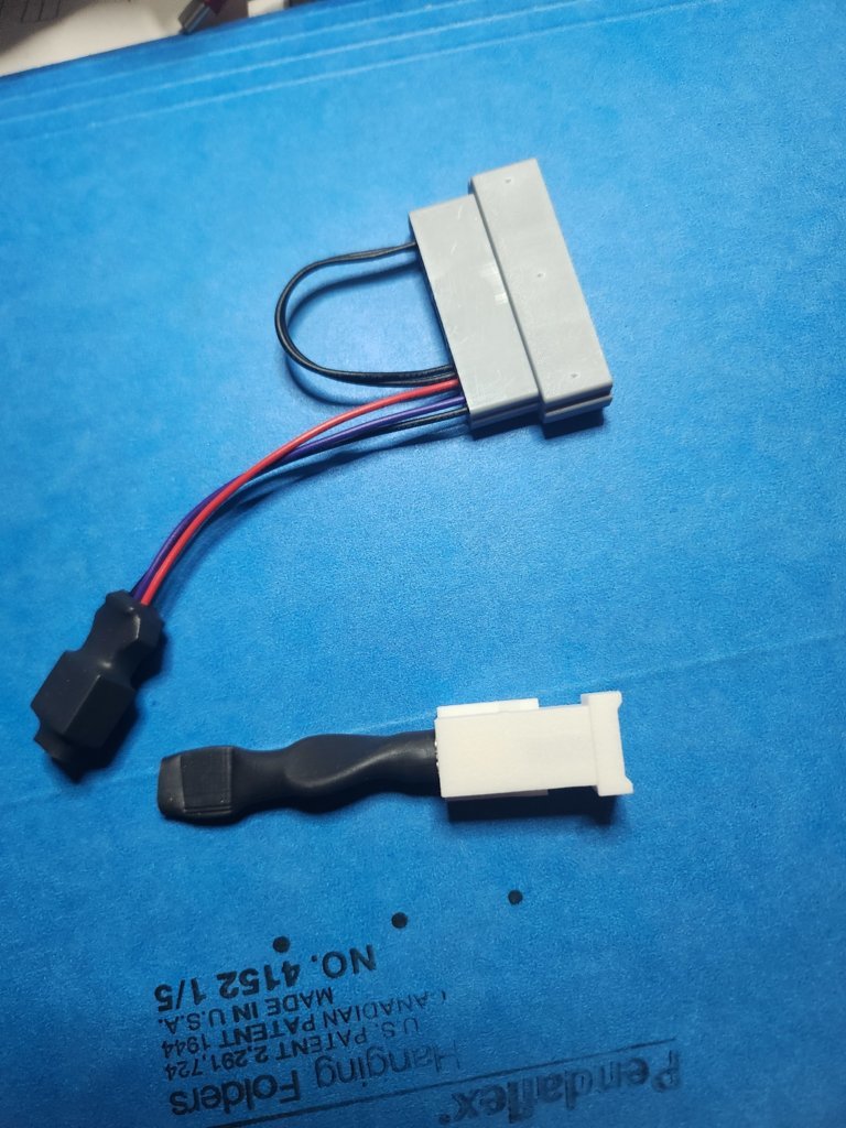

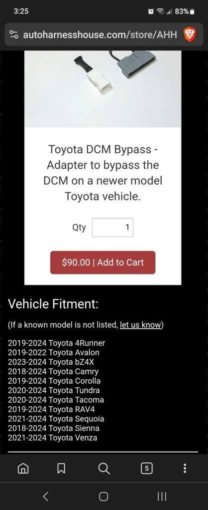

    Good day Gentlemen,
    The holy grail has arrived. Autoharness is now producing a bypass harness to disconnect the DCM while keeping the microphone and speakers working.
    You can find it here.
    https://www.autoharnesshouse.com/store/AHH-DCM77
    I already ordered and received the harness.
    Pictures attached.
    Now I just need some time to install it.

    Slick! Come with any installation instructions?

    Basically, you just unplug two cables from the DCM.
    Then you plug these harnesses into the cables that would have been plugged into the DCM.
    Take off the trim to the radio.
    The DCM is on the right side of the radio.
