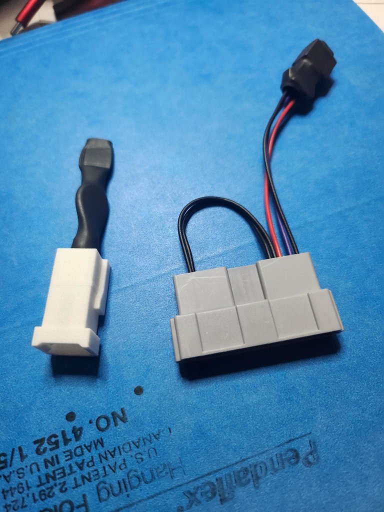

    I am pleased to report, I successfully installed the harness.
    I have a 4runner and creeped around this Tacoma forum because you were coming up with some innovative solutions.
    But I think I found the holy grail with this bypass harness. 100% reversable and easy to install.
    Please take a gander at my entire installation process with pictures here:
    https://www.4runners.com/threads/my-dcm-disconnection-odyssey.25104/page-9#post-694696
    The DCM is completely unplugged, bypassed, and microphone and speakers all work perfectly.

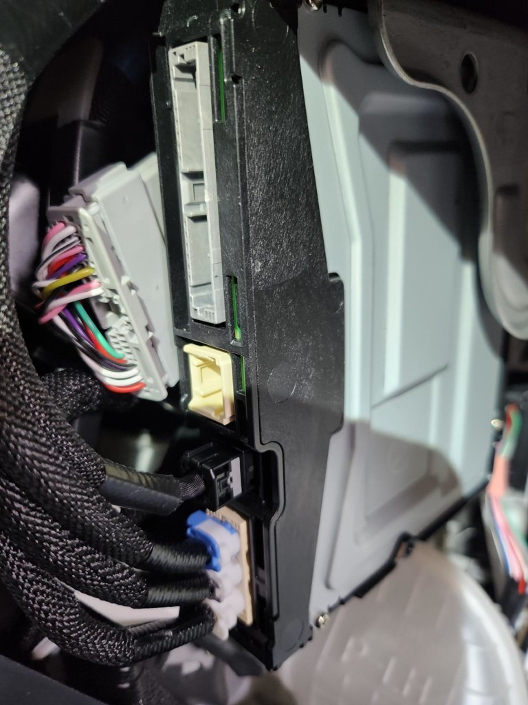

    Just installed the two elimination harnesses on my 22 Taco. No more in vehicle microphone, speakers work fine...
    This video shows how to get access to the DCM on our Gen 3 Tacoma...
    https://www.youtube.com/watch?v=V0LdhmlkhPY

    So you lost you in the cab microphone?
    Also did you unmplug the DCM antennas?

    @Barsoom Yes, for now. No in-cab mic. I'm still figuring out if it was something I did. For instance (and good catch) I did not unplug the antennae. The instructions say to remove all wires and of course, I read the instructions AGAIN after I had it all back together.
    When I get a few min in the next few days I'll do it...

    It should not matter if you didn’t unplug the antennas or the speaker for that matter too, if you are leaving the BCM in place. The microphone interface is in the large connector. I suspect you did nothing wrong, unless the large connector is not plugged in securely.

    Another satisfied customer here. Total installation time was about 15 minutes,
    most of which was watching the above YouTube video a few times to make sure I was pulling the glovebox and trim panels in the right direction so as to avoid breaking clips. Once installed, I zip-tied both bypass harnesses to one of the DCM antenna wires to keep them from rattling around, and then closed it all back up. Microphone still works, speakers all work, and no more “DCM” signal strength meter on my head unit.
    10/10, would recommend.

    I didn’t unplug the antennas, either, but my mic still works. I recommend re-checking your connections to ensure they’re seated fully.

    @Toycoma2021 Checked the large connector and it seemed good to go, the clip was clipped! Took it apart and checked the pins on the provided part. Seems one of those teeny-tiny pins was not exactly straight when the connectors were mated. It must have missed the hole it was intended to mate with and was bent into a L shape. Used a pair of tiny tweezers and a small, thin knife and got it as straight and lined up as I could. Gently mated the connectors and tried out the in-vehicle microphone. SUCCESS!
    TLDR: Pin on provided connector bent as it was installed. Straightened pin and re-assembled. Worked fine.
    NOTE for new installers: Check tiny pins on provided connectors to make sure they are straight and all lined up before mating with the connector off the DCM.
