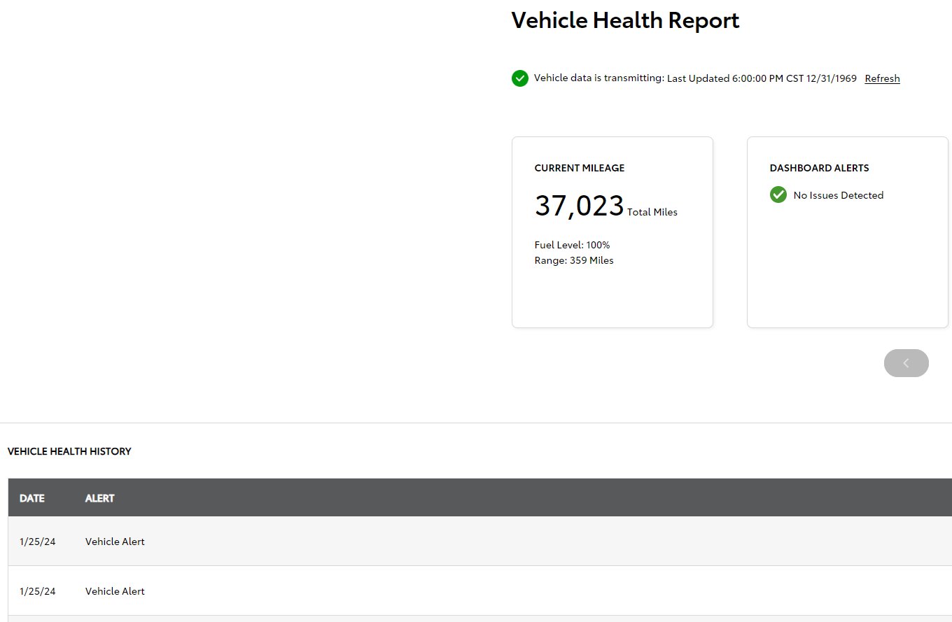

    I suspect my truck is still somehow communicating back to mothership Toyota after performing the mod. A few days ago I installed a remote start system that requires the interruption of a TPMS check. I received a voicemail from the stealership today about bringing my truck by to get my tire pressure looked at because my TPMS light was on... That prompted me to sign into my Toyota account and surprisingly my current mileage is accurate and I had a green checkmark saying "data is transmitting" but the fuel level is wrong and the last updated date has no data since it defaulted to the beginning of unix epoch time. There was also vehicle alerts every day I used remote start since I installed it I presume due to the TPMS issue but unfortunately details about the alerts are non-existent. I realize I could unenroll from "Service Connect" so I stop getting called but for now it will be a good test if my truck is still communicating.
    I uninstalled the Toyota app. Maybe the truck can send limited information like mileage and engine codes through a connected phone.
    Perhaps there is some truth about using short adapters to prevent the wires functioning as a short antenna. I might order the short adapters and give that a shot.
    I drive right by a new Toyota dealership every day going to and from work. Could Toyota somehow communicate over a non-cellular short range wireless system based out of dealerships?

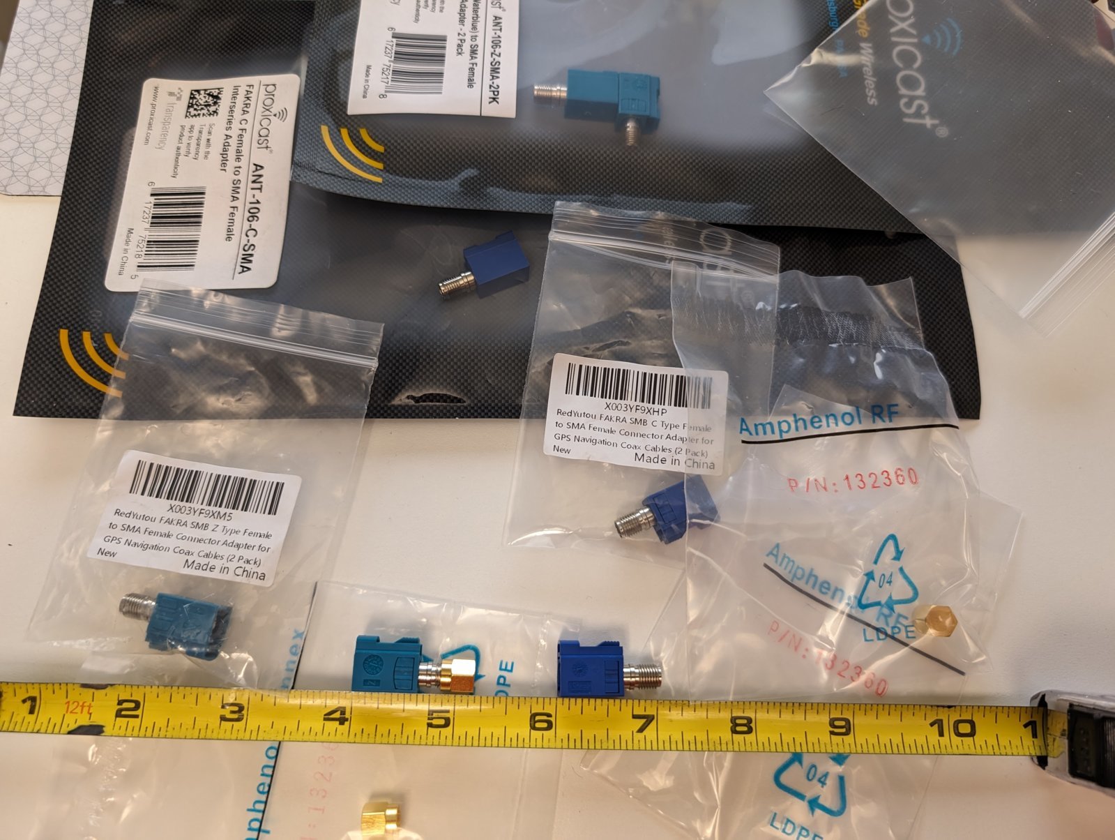

    So hopefully I'll be putting these in soon, but in case not, or this is useful to see, this is how big the interseries connectors look with the Amphenol 132360 resistors. The metal part spins inside the plastic part of the fakra by the way. All the fakras were made in prc and there's no easy to tell difference other than the higher price and fancier packaging that the proxicast brand came in.

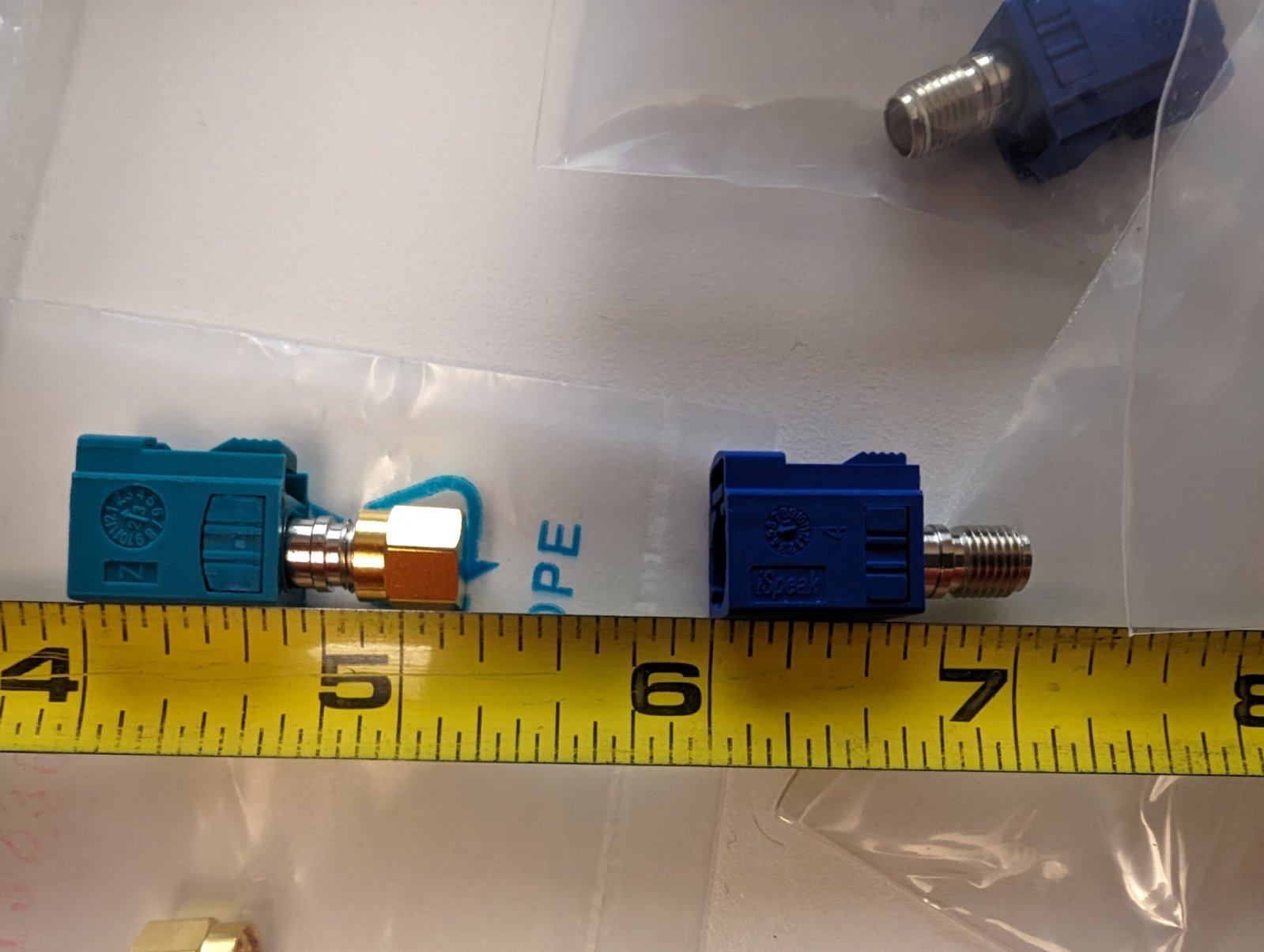

    So I tried the short adapters without the wires (https://www.amazon.com/dp/B0CHBKL39H?ref=ppx_yo2ov_dt_b_product_details&th=1). I really liked the tight fit of this install, but this still allowed for communication and the mileage was again updated on Toyota.com.

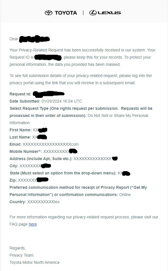

    One thing I found strange was receiving an email from "Toyota Privacy Team" two weeks after performing the antenna mod about a request submitted to "Not Sell or Share My Personal Information". You can make these privacy requests though the Toyota website. The email was worded as if I had submitted the request. I did not submit a request. I have included a photo of the email below with personal details removed. Even though I did not submit the request all of the information was correct. Why would someone at Toyota do that without my asking? Perhaps the truck can only transmit limited data with is not as useful to be sold or shared? Maybe Toyota got tired of seeing the TPMS sensor error my remote start system causes? I have submitted a request to "Get My Personal Information" just to see what's there, but that can take up to 45 days so I got some waiting to do.
