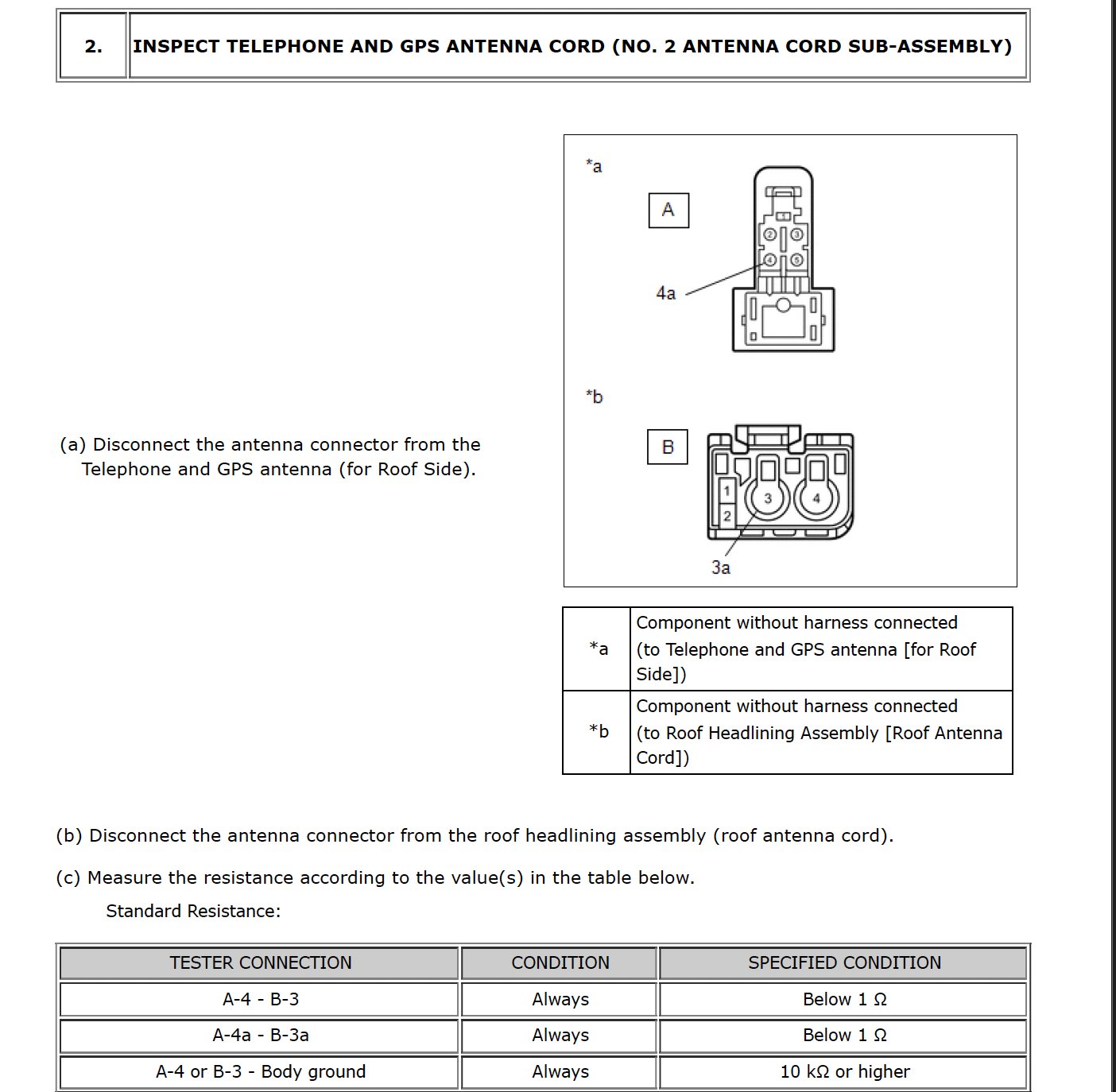

    Looking at Toyota's antenna harness troubleshooting doc, RM100000001KYYI, their diagnostic procedure checks for the outside of a coax connection (outside compression ring, not center pin) to body ground starting from the roof mounted antenna.
    This tells me that the antenna on the roof is providing some kind of body to ground connection near the roof. In theory, if Toyota didn't take the lazy way out, the inside of the DCM module should also have that outer connector surrounding the pin reasonably well connected to ground on the circuit board inside the DCM. If not, any impedance mismatch between the connector inside the whip cable, terminator, outside braid of the whip, and remaining circuit board traces would turn into a tiny, very shitty, antenna.

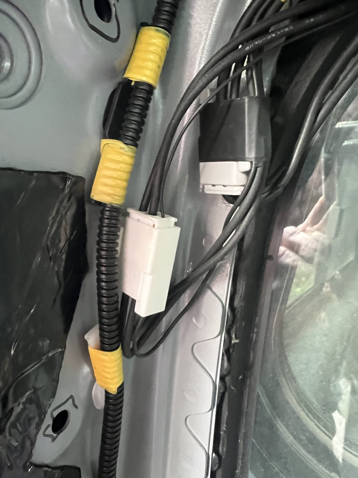

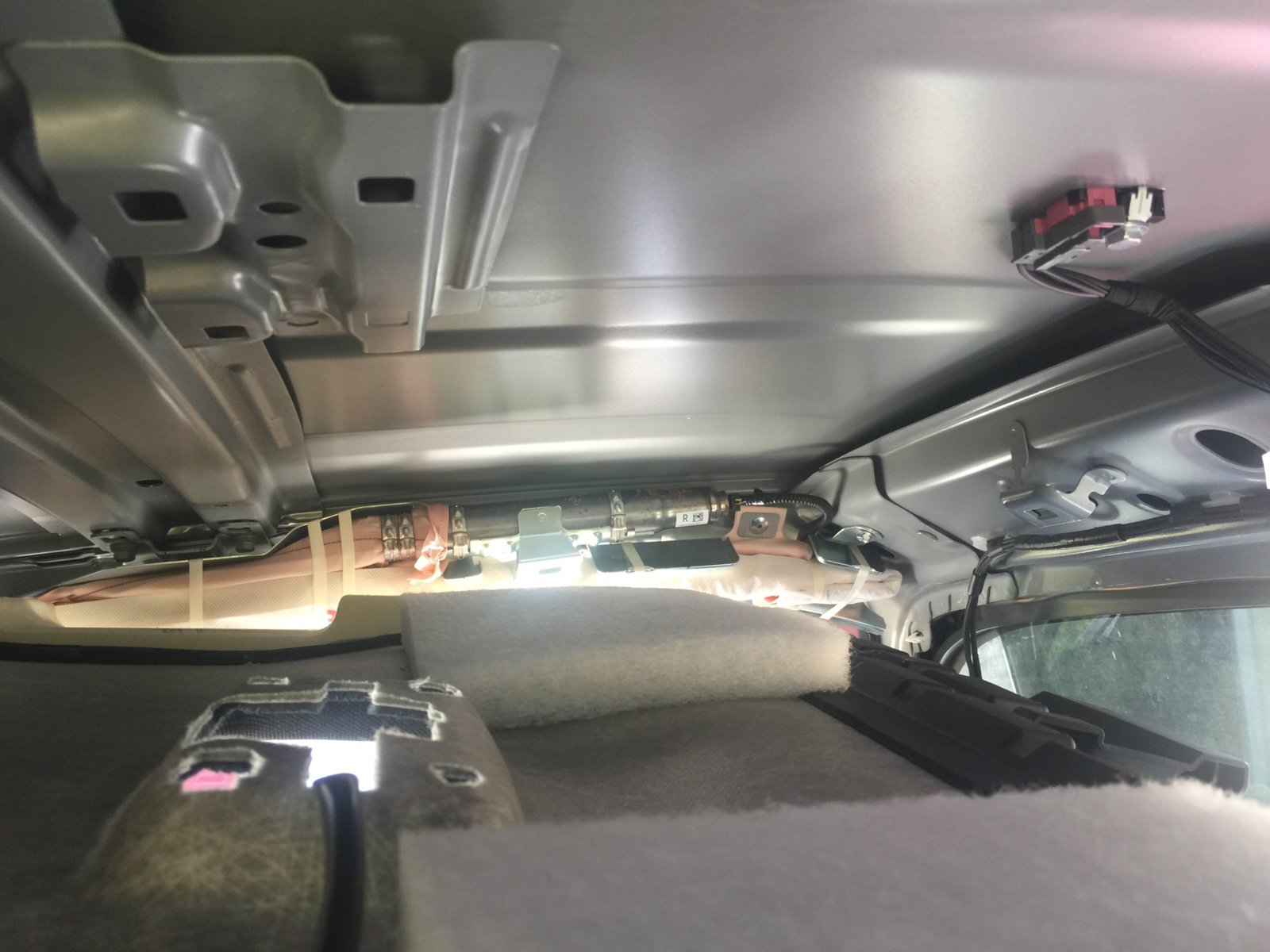

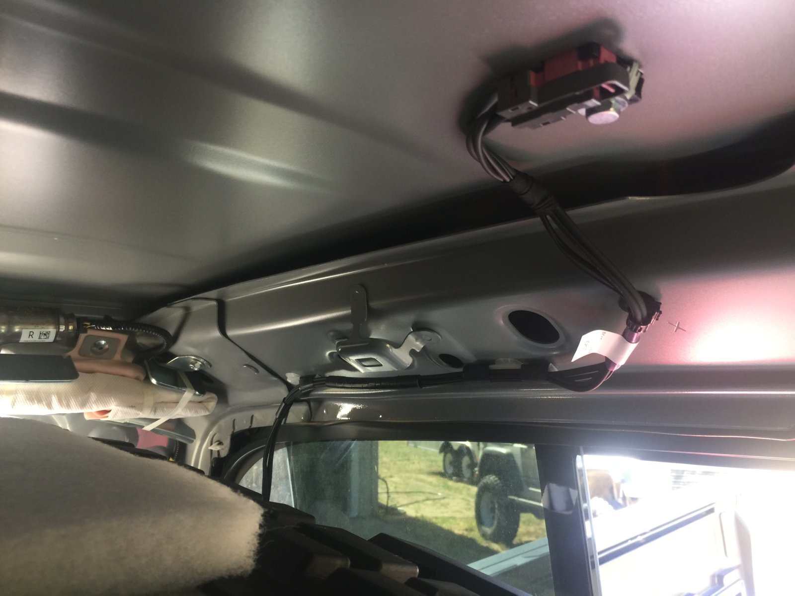

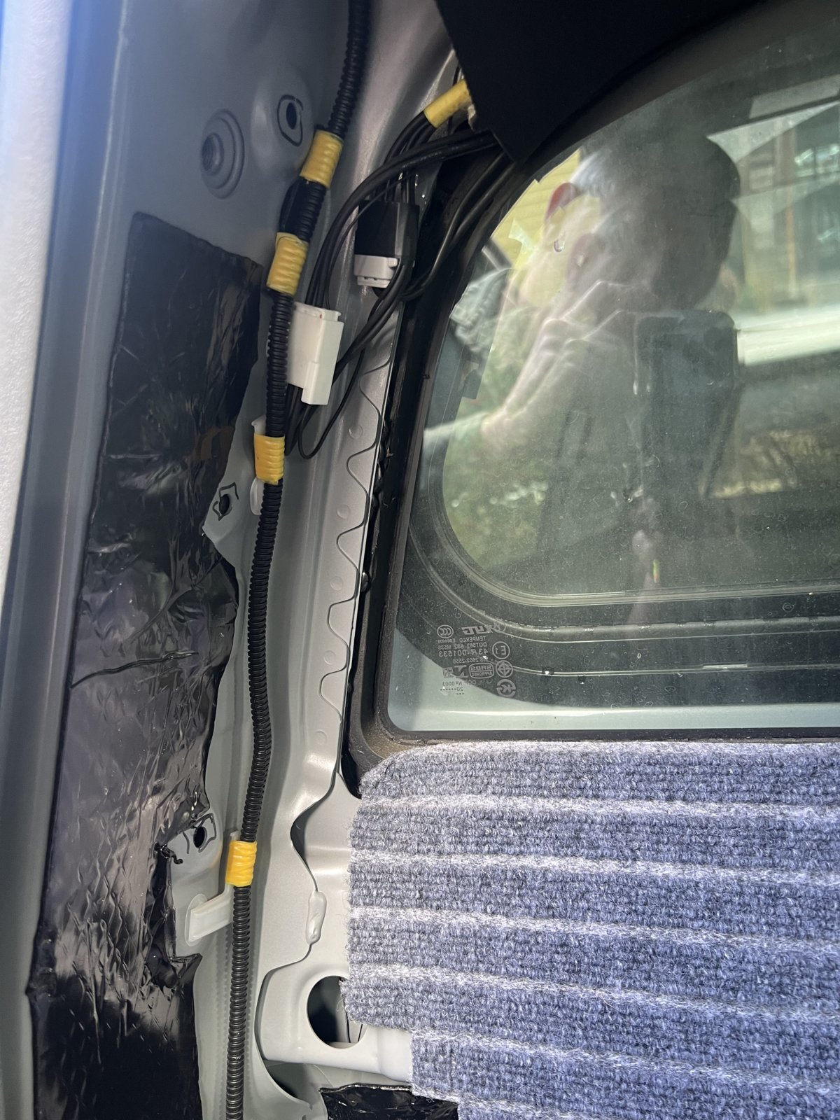

    I have "dropped" much of the headliner, not "removed" by peeling the door molding off the pinch weld and then the latch mechanism between my two doors on the access cab. Plus the center lights and console, console is the easiest as you just pull at one of the rear corners and then the other corners. Lights were a bit to figure out. Don't remember much more than that.
    First two pictures show the roof antenna connection.
    Second two are of the right rear antenna connectors.

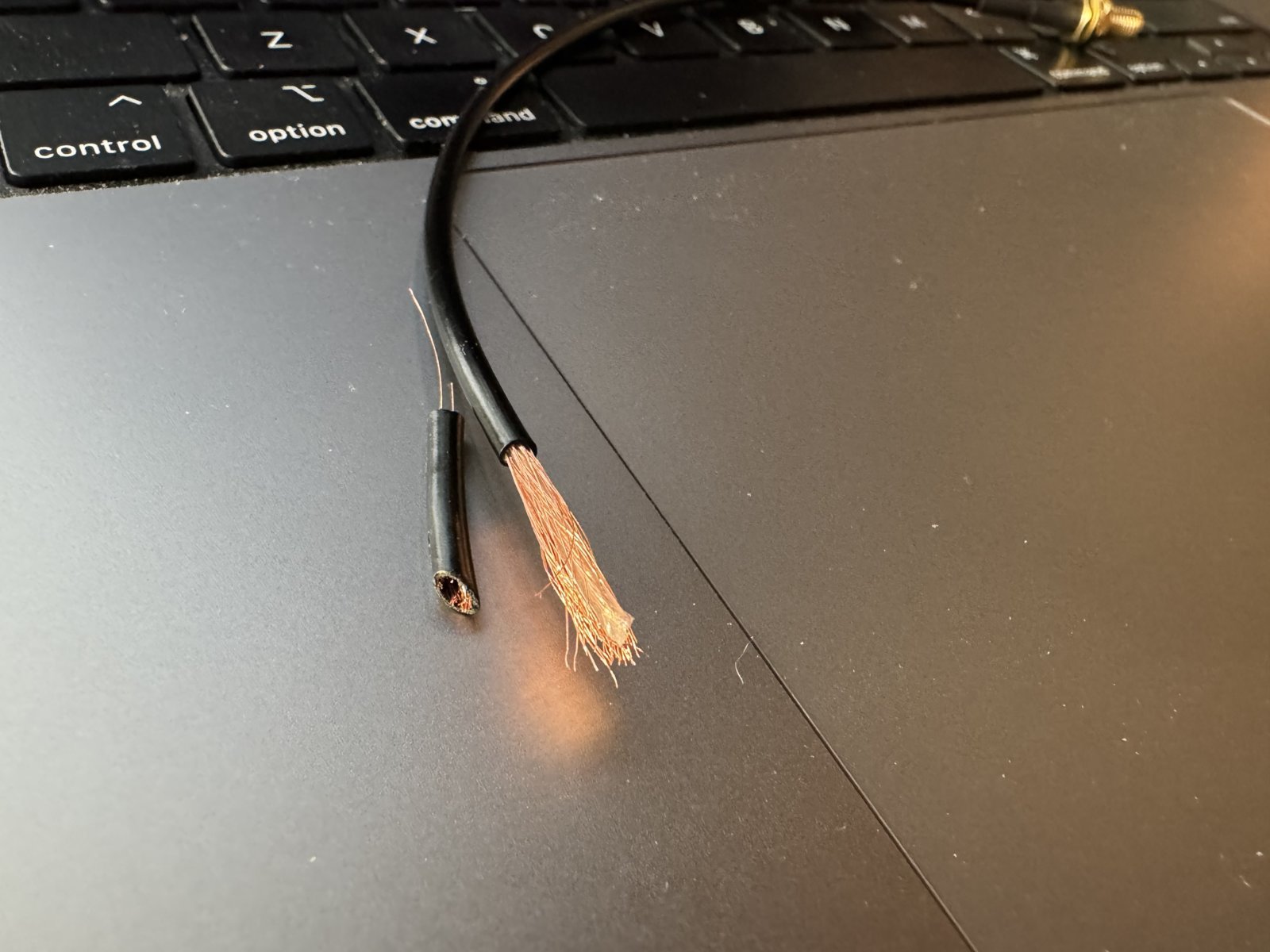

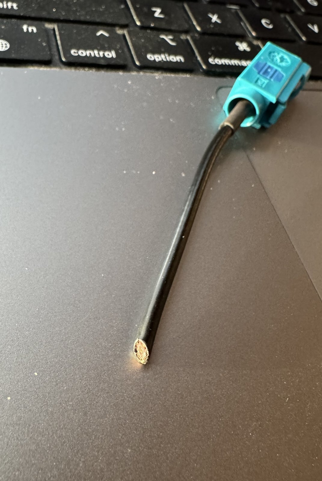

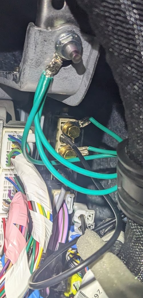

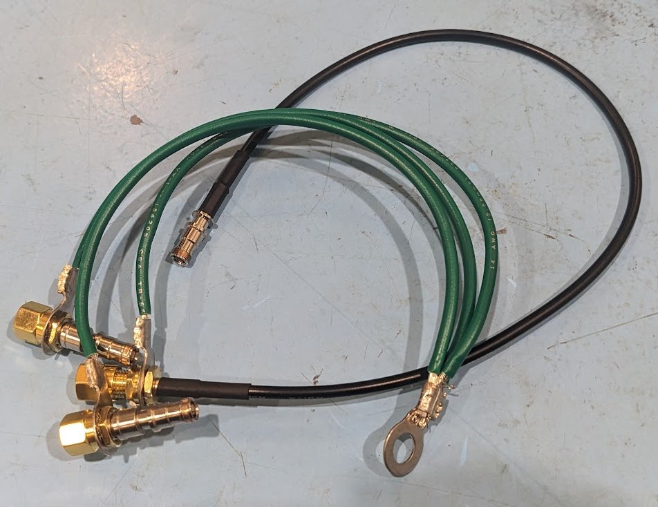

    Tried grounding the outer connector bodies after @altitude-nerd suggested it. My first attempt used the x3 12 inch wired adapters assembled into a harness with the outer bodies wired to a crimp ring terminal for grounding. Before installing I checked the resistances from the inner pin to the outer body for verification and discovered one of my wired adapters was faulty and showed less than 1 ohm of resistance with and without the 50 ohm resistor attached. I am guessing the inner conductor and outer braid shorted somewhere even though the outer insulation and connections looks fine. Since I only had the x3 wire adapters I then tried making another harness with the x3 shorter adapters but the ring terminal crimp connections I used to make electrical connections with the bodies were too wide to allow all three connections into the DCM module at once. In the end I used x1 12 inch wired adapter (that I verified works) and x2 of the shorter adapters. I verified resistances and everything looked good. The shorter adapters were plugged into the two outer connections on the DCM module and the 12 inch wired adapter was plugged into the middle connection. I then grounded everything to a nearby bolt. Luckily the nuts and washers from the wired adapters fit the shorter adapters and allowed me to clamp the ring terminal crimp securely. End result was a little janky. The ring terminal connections were not quite the right size for what I was doing but it worked out for a short-term proof of concept. Below is pictures of the final harness and installation. After installing I went for a test drive and the truck again updated the current mileage shortly after parking and turning off... Perhaps I might try having nothing plugged into the DCM module. If the results don't change then @Toycoma2021 theory about the center pin not making contact looks a bit more likely.
    Kodiak420 and altitude-nerd[OP] like this.

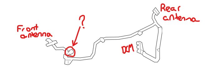

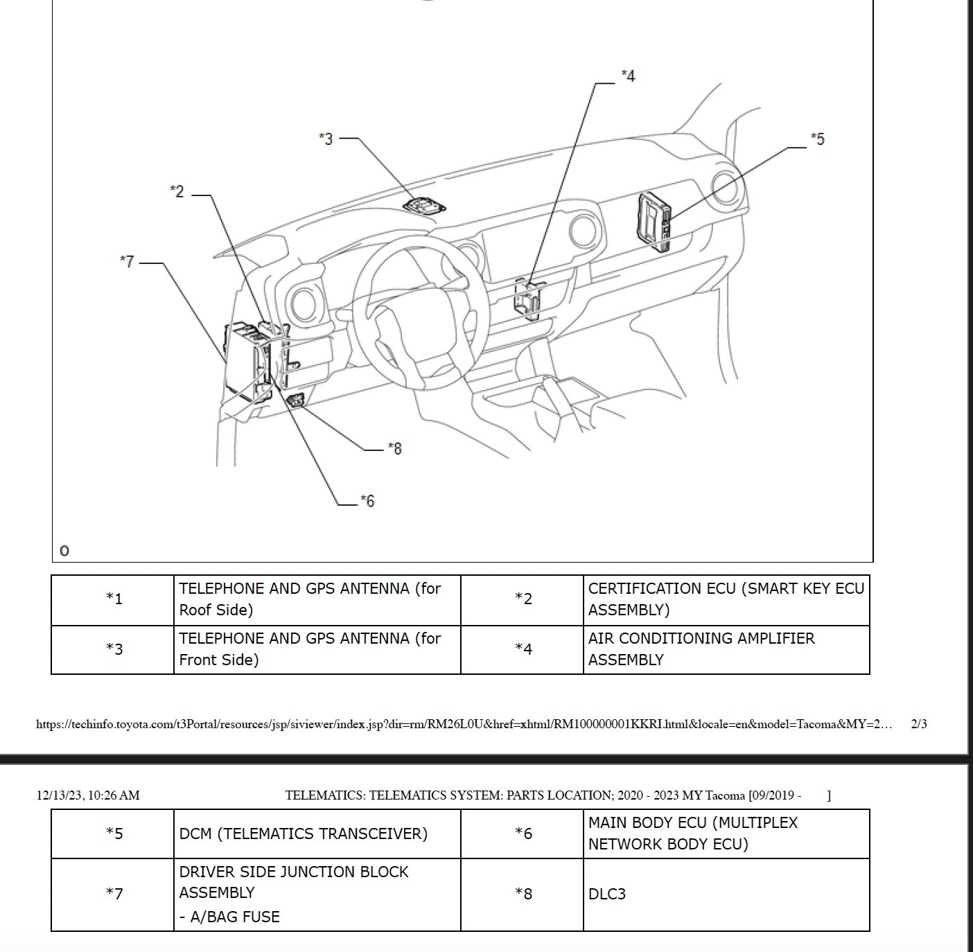

    I did a little searching on the web for the Toyota antenna connection harness to possibly repurpose the Toyota-FAKRA connectors and I think it is 86101-04210 (https://toyotaparts.ourismantoyotaofrichmond.com/oem-parts/toyota-antenna-cable-8610104210). The diagram shows what looks like a connection/plug but I do not know what it goes to.
    It could be an anomaly of the diagram, but it looks like a connection to me. If so it would be the only thing connected to the front or rear antennas aside from the DCM module. I'm pretty sure this connection it is not for the head-unit.
    This diagram only shows the telephone/GPS antenna in that area.
    This diagram is a bit confusing but might be showing a connection.
    Does anyone have pictures of the front antenna in-situ and the surrounding wiring? Alternatively can anyone find instructions for disassembling the dash far enough to access this area? My google-fu is weak and could not provide for me.

    How I read this diagram (I'm going to ignore the right side of the vehicle which has been documented correctly) in the middle of the dash there is one harness for pre 2019 and one after 2019 both shown at the same time. All total there are two connectors going to the two different years "Navigation Antenna Assembly" and SIX various connections into the radio. Of course, I don't believe all six are used for all years.
