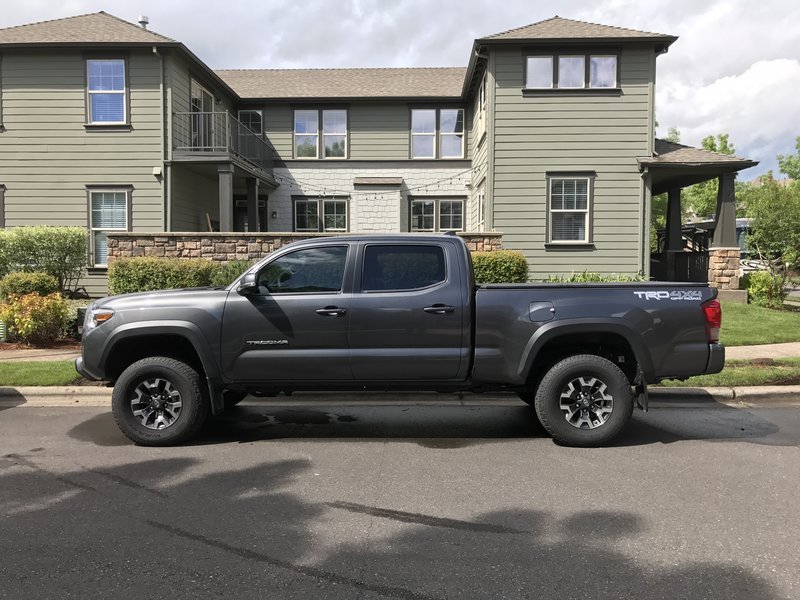

    If you're not gonna haul much, you don't need more than an AAL. This is waaay better than running a block spacer and is still firm but compliant. I gained 2" in the rear and my truck is now level (no rake).
    Pic is after lift installed before wheels/tires installed.
