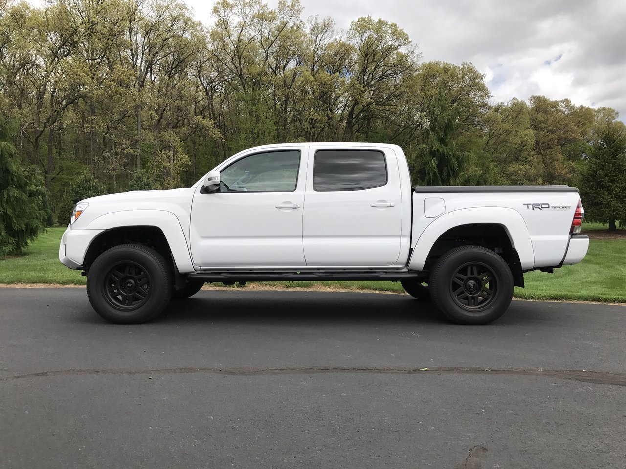

    DF5C4658-80C2-4AA4-AB1D-1F5270D5A0E6.jpg Not sure. I was 2 inch in the front and 3 inches in the rear. I just traded my Tacoma in on a 2017 TRD Pro 4Runner. Here is a pic what it looked like.

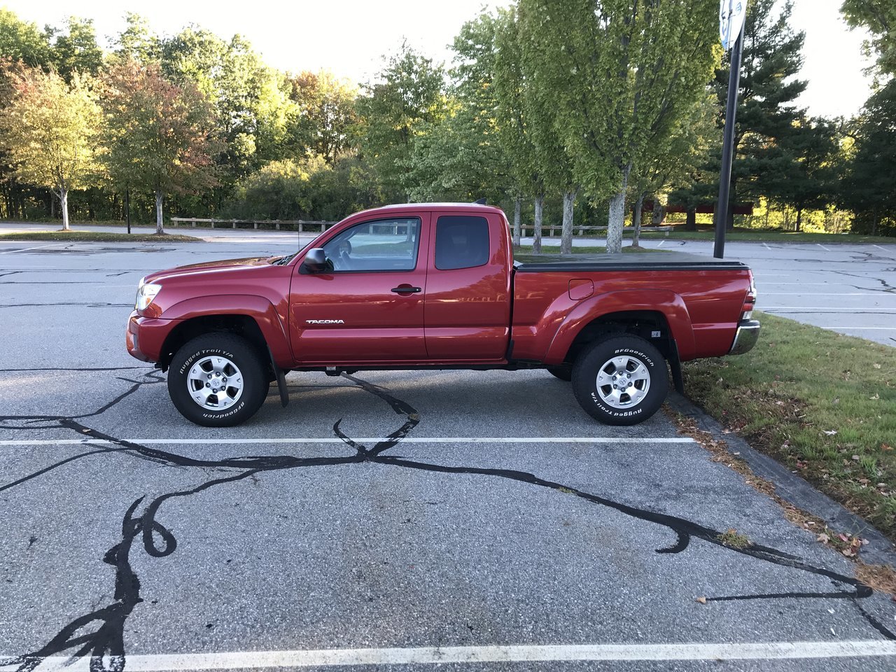

    My 2015 TRD OR Access Cab has Wheelers progressive 1 1/2” Pack with the OL. Drivers side rear measures 23”. Passenger side rear measures almost 24”.
    My driveway isn’t level though
    Btw, 5100’s set at 1.75 with stock Sport coils.
