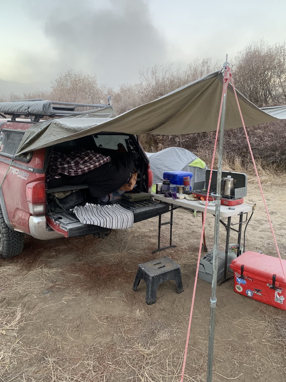

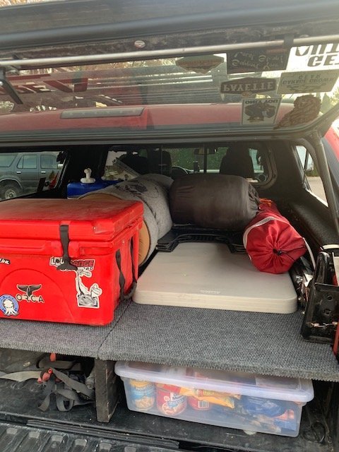

    I'm installing toytec 3 leaf aal with their bypass shocks tomorrow. Trying to get my truck to sit level with all my camping gear loaded and ride better.IMG_3171.jpg IMG_3273.jpg

    In that case i would suggest leaving the overload leaf in.
    Exploring208[QUOTED] likes this.
