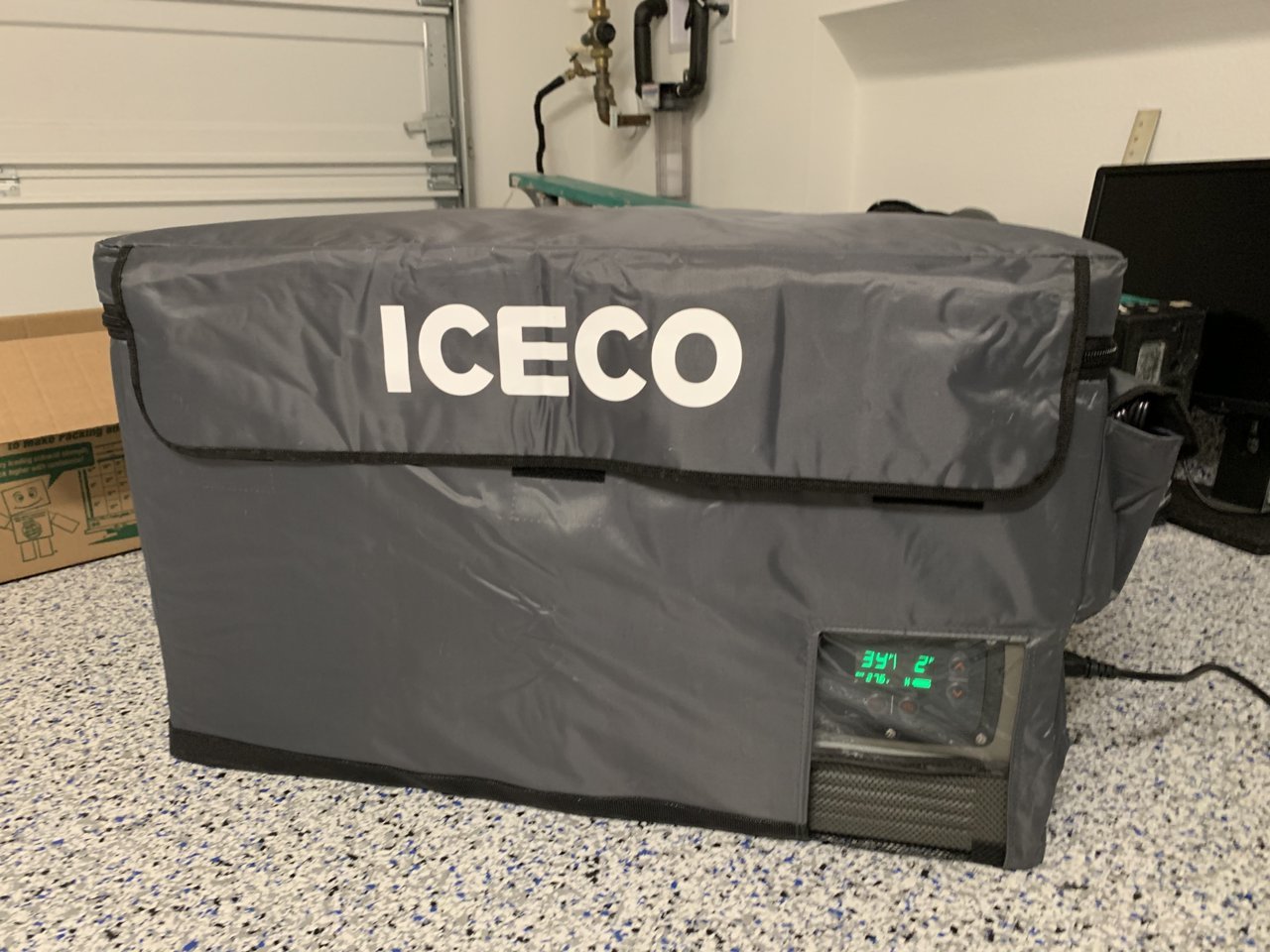

    So I just recently upgraded to a single X2 Power 27f AGM to help power a newly purchased fridge. (Old pic, connected positive cable from fuse block to 100A fuse on battery)

    So testing so far:
    6:45pm: I plugged the fridge into the truck with fridge full and at temp before connecting to truck
    8:15am aprox 13.5 hours later here are the readings:
    • At the Fridge with compressor not running--12.7V
    • At the bluesea panel in the bed of the truck--12.65V
    • At the battery with everything fridge unplugged to make sure no load reading from a multimeter--12.63
    According to state of charge chart, battery is aprox at 85% state of charge. Not too bad.
