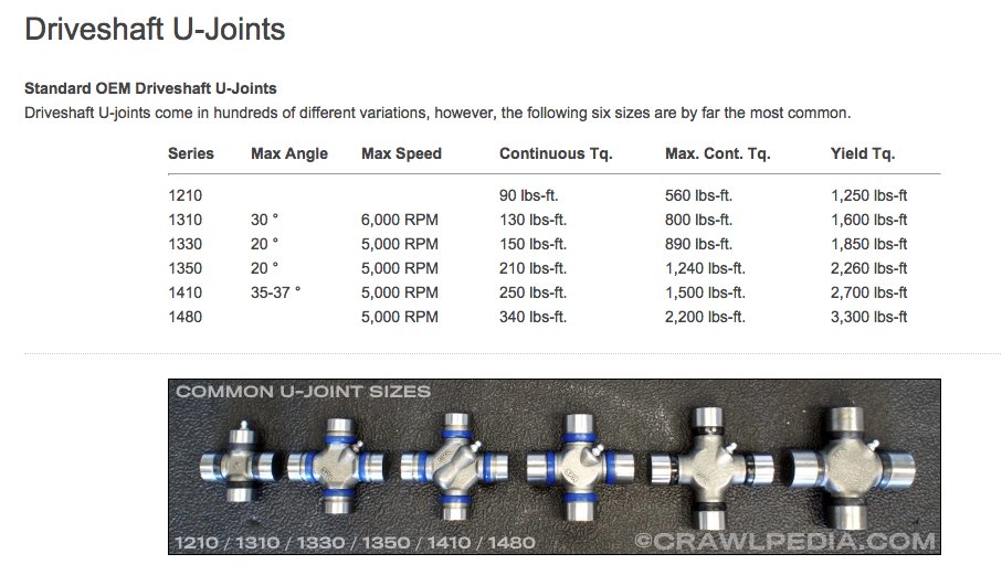

    Hey, boys. Sorry for tagging you, but I'm hoping for a quick answer. My driveshaft is currently at a reputable driveline shop near me, and they gave me a quote for the double cardan conversion. He's telling me $730 + tax, which is a bit steep for my liking. He was talking to me for like 10 minutes about the parts he'd need to use and the process, 90% of which went right over my head. But one point he did make was that he'd have to use a 1310 joint, which, technically, is weaker than the stock 1330. Seeing as I do wheel this truck kind of hard out in the middle of nowhere, that worries me. But should I be worried? How much weaker is it?
    He also mentioned that my CB is pretty much shot. I'm wondering, is that a cause or is that a symptom....? I've been driving with this take-off wobble for about 16 months now, so it wouldn't surprise me if I've turned it to mush.
    As much as this vibe is driving me insane, I'm not sure I'm ready to drop almost $800 on a driveline mod that may or may not work. Especially one that makes it weaker over all.

    Interesting. Mine is a non grease-able 1310; shop that built it says they're stronger than the grease-able 1310 because they're not cross-drilled.
    As far as 1330 vs. 1310, found this comparison chart on the internet, so it must be true:
    You should also look into tube specs if you are concerned with strength. Mine is 2.5" dia .134" wall front, 3.0" dia .125" wall rear.
    Best to replace the CB while you are at it. I was told that the CB drop I had helped kill the old one.

    My guy told me the exact same thing, that non grease-able are stronger than grease-able, and that you'll never find a grease-able joint on any of his vehicles. Regardless, he still said the 1310 would be weaker than what is currently there, and that Toyota probably used 1330 for a reason. idk. It didn't instill a whole lot of confidence in what he was going to do.
