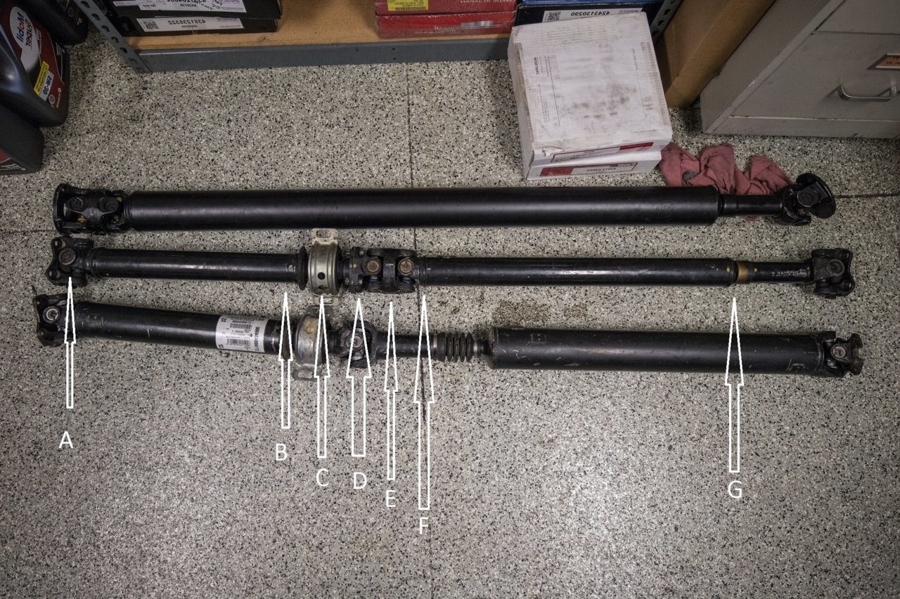

    I took this info to the local driveline shop in Colorado Springs and their reply was, "Well, the Dana 300 yoke (Spicer 2-4-4341) isn't going to fit snug on the factory splines". They proceeded to go in the back, grab a 2nd gen Tacoma drive shaft and the Spicer piece and slipped them together and showed me the slight play in the splines. They said they could use a Nissan (I presume Frontier) spline shaft that'd fit snug with the Spicer yoke.
    The way it breaks down is;
    A Transfer case output > front piece of rear drive shaft (lengthened)
    B Nissan spline shaft welded on to rear of front shaft
    C Factory center bearing
    D 2-4-4341 yoke > U-Joint > 211355X to bolt u-joint to 2-4-4341
    E 2-26-487 double cardan center > u-joint
    F 2-28-2977X welded to a 3" to 3.5" adapter
    G flipped and shortened rear driveshaft > u-joint > pinion/diff
    The two big issues they seem to be concerned with, regarding your parts list, are:
    1. The splines in the 2-4-4341 don't mate up snug with the factory drive shaft splines (B connecting to D) and mating them together would lead to premature failure.
    2. The spline lengths on the 2-4-4341 are much shorter than the factory driveshaft spline lengths (again, a relationship between B and D). This will cause the drive shaft splines to poke out of the 2-4-4341 too far and they splines would contact the first u-joint in the double cardan joint (the area between D and E)
    To correct this, they'd use a Nissan splined shaft end (B) but will have to lengthen the front shaft (or replace it with longer) to make it all fit in the factory space as the original does. The Nissan part will have a shorter spline shaft that fits the 2-4-4341 both in snugness and length (it's shorter) then build the double cardan as you've shown.
    I'm dropping my driveshaft off today to have the work done and was curious if they mentioned such modifications to yours, as it's not mentioned in the parts list.

    $350-400 they said. A little more depending on whether they throw in a new stock Spicer CB (~$75) to replace the Ford Ranger one I'm currently running.
    They're a reputable shop, my buddies all have used them in the past for their Jeep repairs.

    no need to get crazy with nissan parts (ewww) You can keep the front section of the 2 piece completely stock. Bolt a splined flange up after the CB where the stock yoke went. Then bolt up the proper DC joint thats the same sized u joints as stock to the flipped (and slightly shortened) rear shaft.

    I just dropped it off and they said they’d figure it out. I told them my only concern was it be as strong, if not stronger than, stock. They understood and said no problem.
    Guess we’ll wait a few days (going out of town) and see what I get when I come back. I’ll update here.
    Incorrect according to these guys and the setup they showed me before my very eyes.
    The new splined yoke has a much shorter shaft, by 1/2” or so, which allows too much factory driveshaft splines to poke through. This extra 1/2” would try to occupy the same space as the first u-joint in the double Cardan.
    Talking to them today when I dropped it off, they had talked and figured a spacer was used on Chris’s setup. It’d be a cheap and easy fix that wouldn’t show up on the bill (as in his case it didn’t).
    If you know different, we’d love to hear this part number that fits the factory front half shaft and creates no clearance issues.
    Jake

    Hmm interesting... if i can find the post where someone did what i described it had part numbers listed out. but man, that is gonna be buried.... sorry man.
