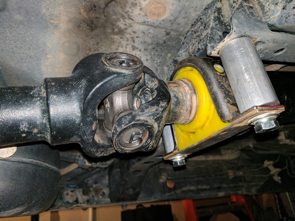

    Alignment of the u-joints.
    On a two joint shaft the u-joints need equal and opposite angles to keep oscillations cancelled between the two. When you lift and don't change the axle angle to keep all joints balanced angle wise the oscillations aren't canceled which leads to vibrations. The larger the angles the larger the oscillations and harder to cancel out even if they are even between both ends. So even done right the vibrations may exist due to larger angles, but if not perfect the results are magnified by the larger joint angles.
    On a 3 joint double cardan shaft you set up the single joint almost no angle and the other two at the opposite end do most of the bending. (Set up the single with some angle to get some movement in the needle bearings so everything doesn't seize over time).

    Exactly right.
    And what I find interesting is I drove my Tacoma with a Bilstein 5100 and AAL lift for 3 years with no vibrations. I went about 1" higher with Icons and a Dakar pack and all of a sudden had vibrations. I even tried the carrier bearing spacer that came with my lift when we installed it. No dice. So there are a lot of factors and I think it's realistically the total height (in the rear) that matters.
  6. Feb 17, 2017 at 6:28 AM

    Angles. It is always angles. If you lift and change the angles it may not be cancelling one joint against the other. There are wedges to put between the spring perches and the springs that will allow you to slightly alter the rear axle pinion to driveshaft angle. It saves you cutting and rewelding the rear axle perches to adjust minor angles.
    On full size long bed quad cab trucks you can lift much more without affecting the angles as much as the driveline is much longer. On the flip side Jeeps have tiny driveshafts length wise which a small lift causes huge changes in DS angles. That's why the Jeep guys understand joint angles and vibration so much.

    I suppose you could but I'm not sure it's worth the time and effort. I decided to keep mine as a spare for when I'm on long offroad excursions. Figured it would be smart to have a spare to get me home in case something terrible happens.
    True story. However, I thought I'd gotten my angles EXACTLY right (I measured with level meters) but it still had issues. I was sick of dealing with it.
    What's nice about the double cardan input joint is it tolerates marginally improper angles quite well. Angles that would have had the OEM shaft throwing a fit.

    Good question. The original carrier bearing was indeed wearing. However, these vibes were immediately introduced when the lift was installed so the lift was the issue. I tried a replacement unit (and various length spacers milled from solid aluminum). No dice. It allowed me to delay my final solution as a bit of a band aid but it never fixed it.

    Which is why it is usually just easier to go to a double cardan and while at it upgrade to heavier components. You fix your current issues and also prevent future issues because we lift for bigger tires
    Yes you can have a shop modify your old shaft. My one question is why do you have a vibration in the first place? Did you lift it? Did you go bigger tires? Are you taking it off road?
    So if it is vibrating due to old bearings then sure you might get away with just modding your original shaft but if you lifted, bigger tires and going off road I wouldn't bother with the stocker. My reason is simple. Additional stresses from tires, lift or off roading may destroy the joints which were not designed for the additional stresses. I will use my Jeep as an example. I went from stock tires approx 29" to 32" and then 35's. I had 7" of lift. When I ordered my Tom Woods shaft it had 1 ton equivalent ujoints compared to the ones for a 1/4t Jeep. So I gained a double cardan shaft (one joint at one end and two at the other) which will help a ton in solving the vibe problem and added much beefier components in the joints and the ears that hold the joints.
