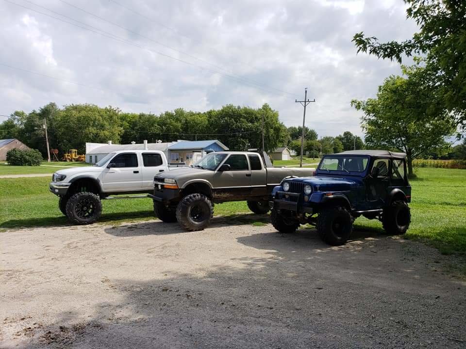

    I thought drive shaft vibration was just something you delt with when you lifted your truck! LmfaoFB_IMG_1611545398789.jpg
