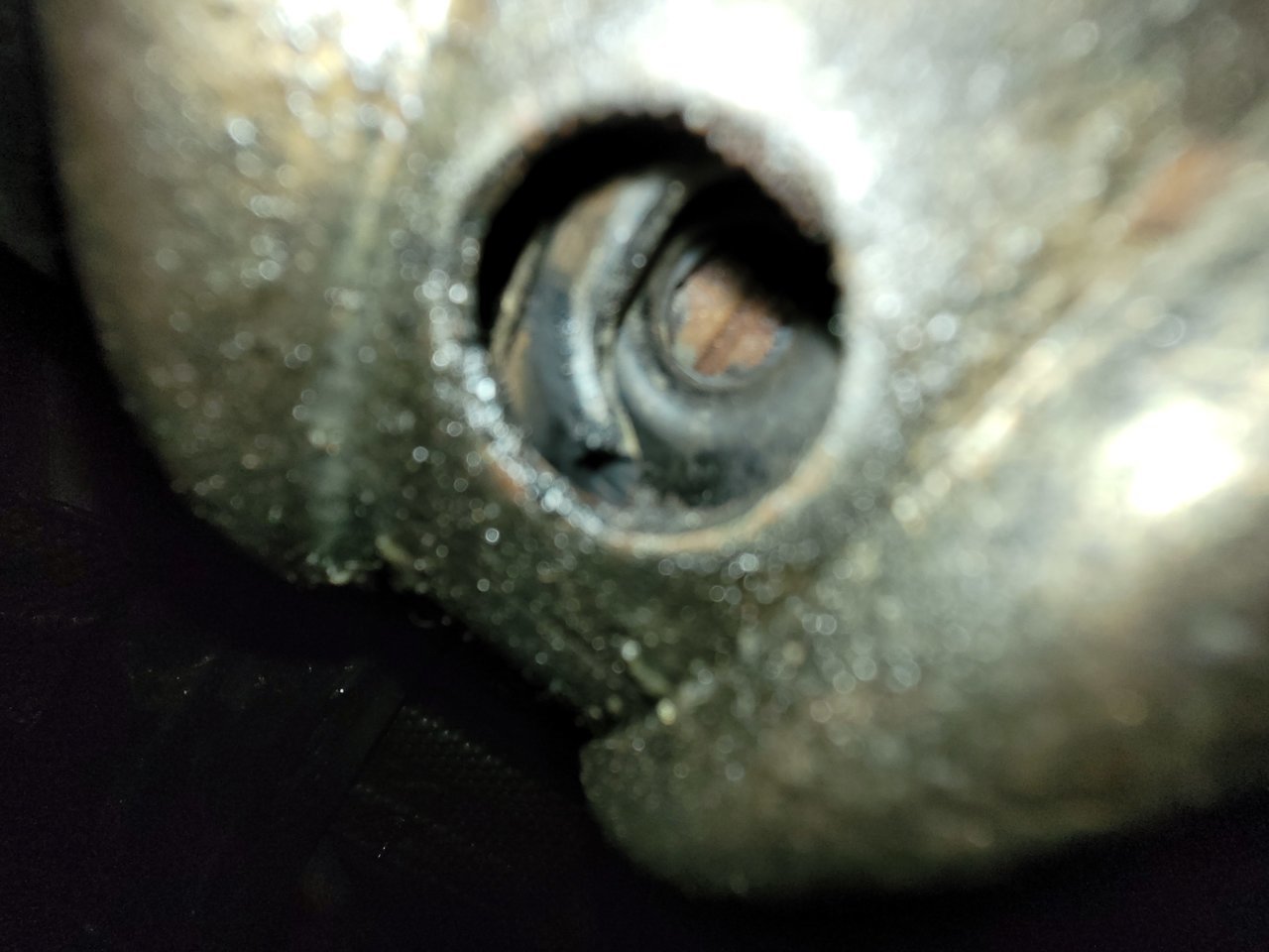

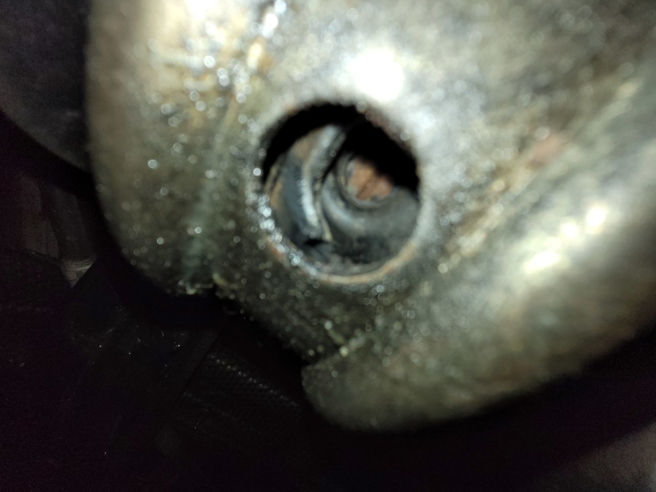

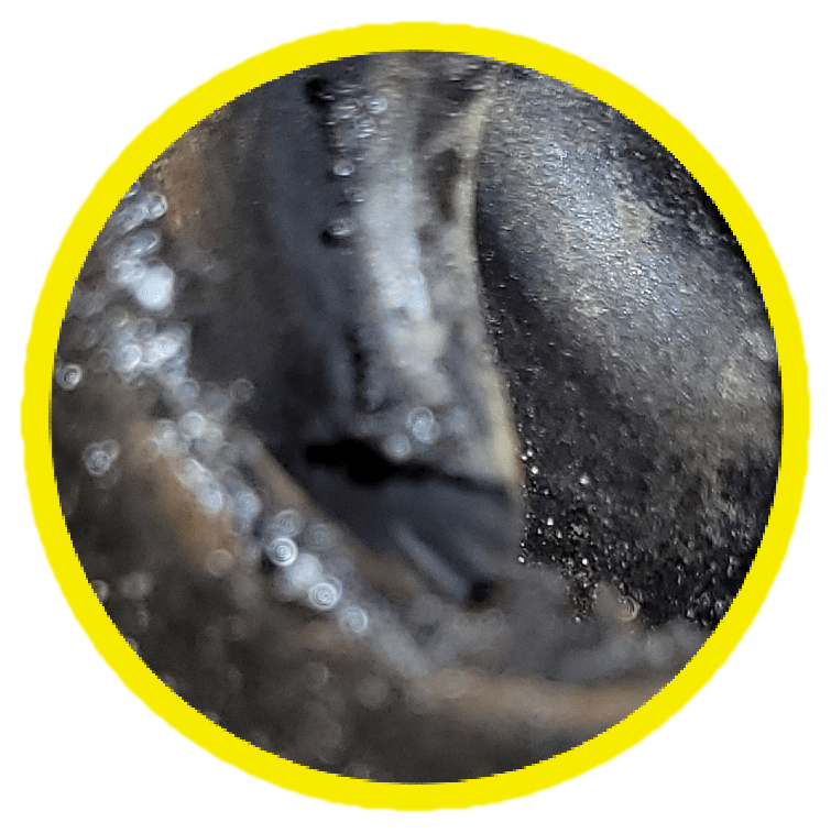

    I think I found the issue. It looks like a part of the carrier bearing is rubbing on the inside of the outer shell. In the yellow ring photo you can see the angle on that one piece where it has been rubbing.

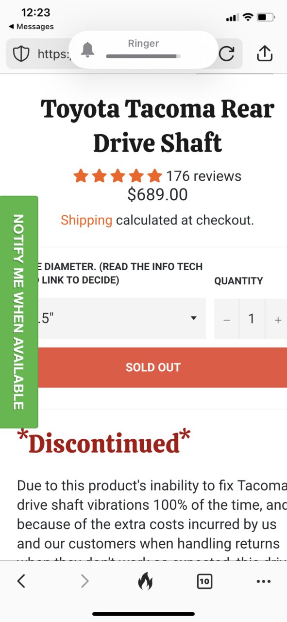

    I just checked out the website and got this message, I wonder if inland empire driveline is better ?
