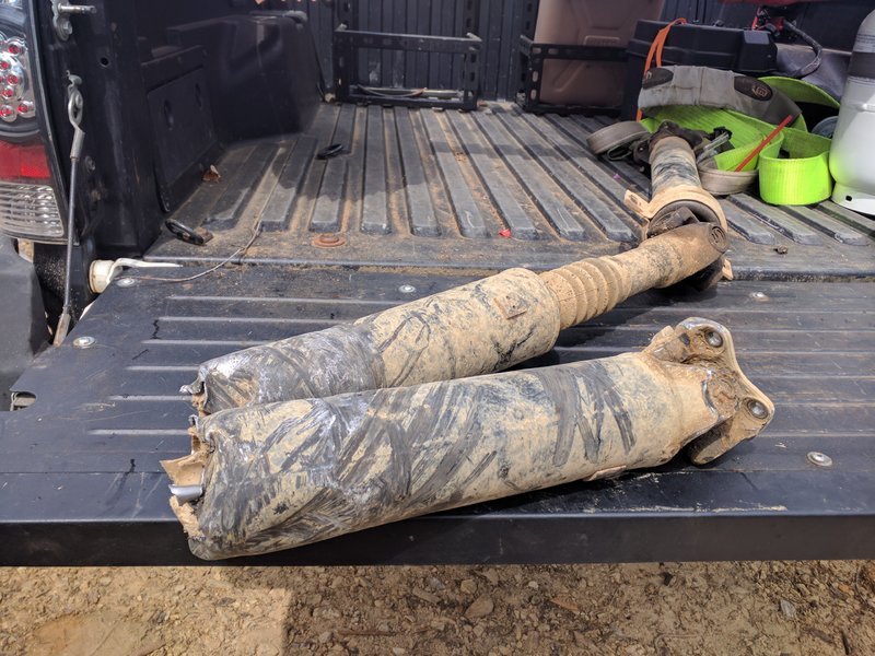

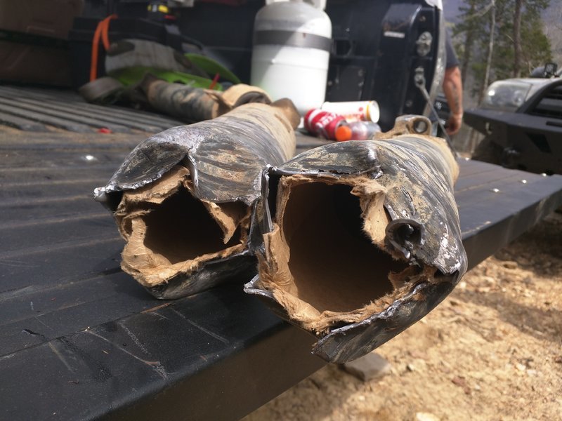

    You busted up a two peice. A single would never have stood a chance. There's a story there I'm sure!
